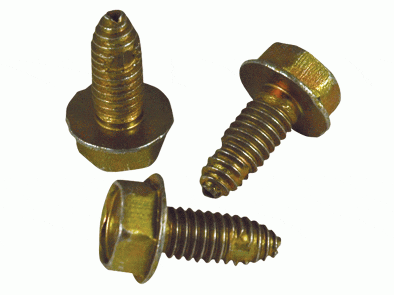

never use self tapping bolts. its illegal in practice actually.

They loosen under vibration.https://jadelearning.com/jadecc/courses/UNIVERSAL/NEC05.php?imDif=2191.0

I highly recommend drill and tap and use some type of locking washer.

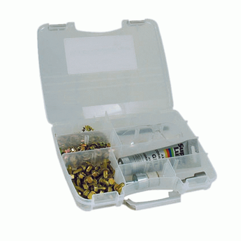

Of course, always use a locking washer with a bolt. The kit which the bolts come from is Positiv Ground, which I can no longer find online except on Metra's site. Looks like they dominate this distribution and rebranded it.
