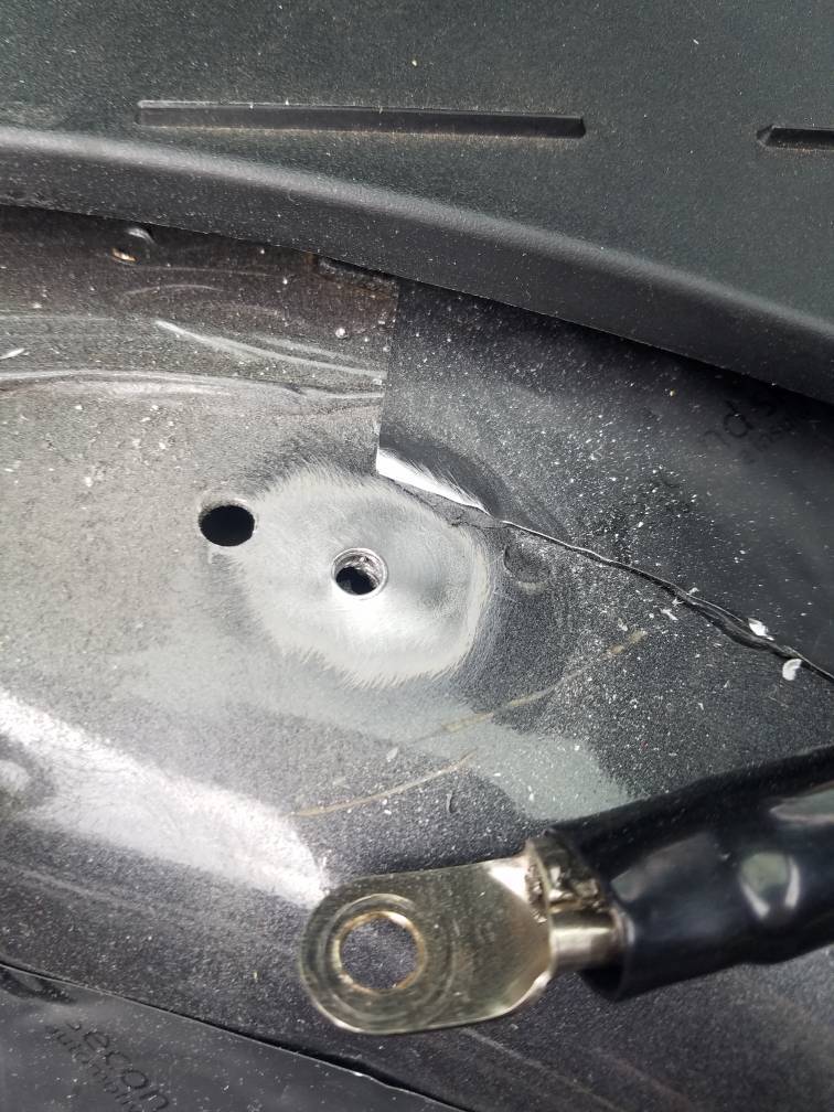

Can anyone help me find a good grounding spot?

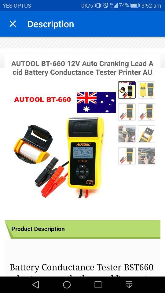

Also that battery is under 1 year old, I'v purchased a conductance tester. Also on that morning it was **** cold, I Dnt know about - degrees, but my windscreen was frozen an that where I live is a very rare sight.

in the first set of pics, all i see is good places for a ground. Scrape the paint. get a good crimp on a copper o ring and use a self tapping sheetmetal screw. done.
God no. I just removed one and the paint was barely scraped. No wonder I was getting sub thump every time I turned the vehicle over. The more proper way is a bolt/nut combo. Self tappers don't last as long, rust, and can come easily undone over time.
how do you use a nut though if you find a ground? do you go under your car and find where your bolt is?
Correct. This is a ground I just recently made....in my ext cab s10. Be cautious tho, you don't hit anything if you do go that route, i.e. fuel lines, brake lines, any moving parts, etc.
The but/bolt combo is the best way. Even better is to run the bolt up from the bottom and weld it in place. I guess I should have suggested both in light of me not being sure how much effort this guy is willing to put into making his ground solid as can be

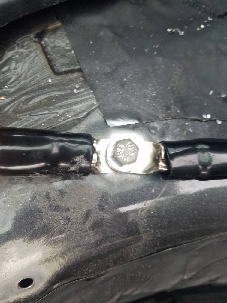

12.75 when the car is off is this a good sign?
Sent from my SM-G935T using Tapatalk
looks like you have the nut/bolt combo, this should be as solid as youll ever need //content.invisioncic.com/y282845/emoticons/smile.gif.1ebc41e1811405b213edfc4622c41e27.gif that is unless you go crazy loud and do like 7000 watts or something like that
Actually I used a bolt and 2 washers on top of the 2 0 gauge ground wires and getting that 12.7 volts when the car is off. I can't seem to find the end of the bolt underneath the car like the bolt is where another panel of metal is or something.. So I really though ground wouldn't have a voltage but thought it would be like a dead end 0 volts because I thought ground is suppose to read 0 not as much as the power.. I was going to get a second battery bit heard it's bad to put another battery with a stick alt like it will now take more power or something is this true ?
