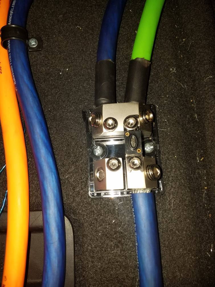

So weirdly it goes into protect everytime it hits 9 or below which is annoying because when I start my car it goes straight to protected and no music on any drives so I been using my blue tooth speaker. And for everyone else on my problem I did some process of elimination hunting down where the voltage drops in my car thinking it's my battery but turns out I just switched ports on my distribution block and it's all good now...
The bottom wire being my main power from battery was in the left side and also switched my fuse to follow of course I just switched it and it's all good. Looked inside and it don't look any different then the other ones...knukonceptz

So the distrib block was the issue???? That's odd as hell. I have their amp kit, RCA's, wiring, etc and haven't had a single issue.
Yeah no idea what the real issue but at the left side I would read as low as 8 volts then the right side is as high as 12.8Any way to get 14 volts?! Lol
