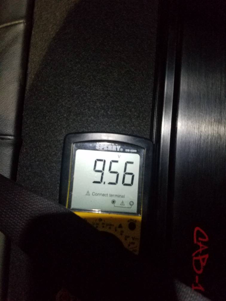

Btw I'm playing music and it's not shutting off or anything but I did check the dmm for the amp and when around 22 out of 40 volume it does dip to 12.4v from 13. Does this mean I have to lower gains even more?

I very well could be wrong but mid to high 12s i think are ok. Wait for the big guns to chime in. But shouldn't you be at 14.8ish running bkt 13? And if u eve need another cab I have one I'm looking to get rid of //content.invisioncic.com/y282845/emoticons/wink.gif.608e3ea05f1a9f98611af0861652f8fb.gif

the cab1600 takes a good amount of current, if your car is not ideal for running chassis ground id run dedicated grounds.
did you read my post about checking voltages? a lot of us dont like helping if you dont do some testing yourself
If my battery tests at 13.7 volts and on random days my amps run the same and drop accordingly but some days like today and yesterday it's at 9.7 volts and I'm assuming it's going into protect because it's not getting sufficient power is this true?
