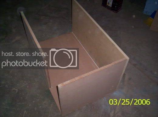

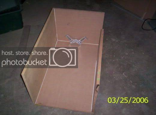

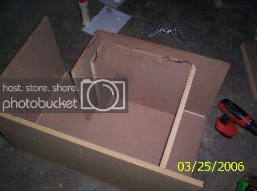

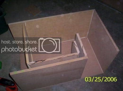

here is tha base and a couple sides

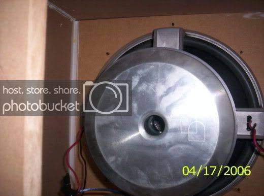

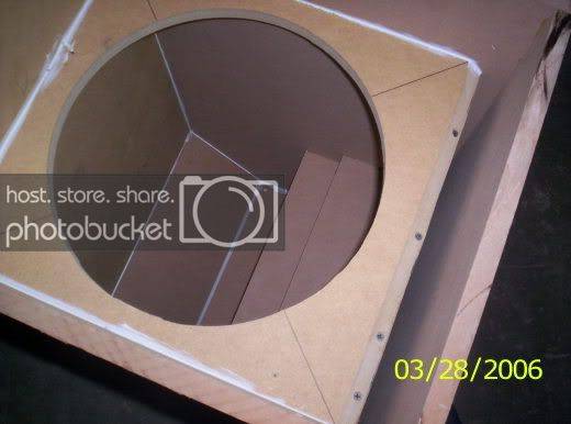

here you can see the sub baffle and the front chamber and its port

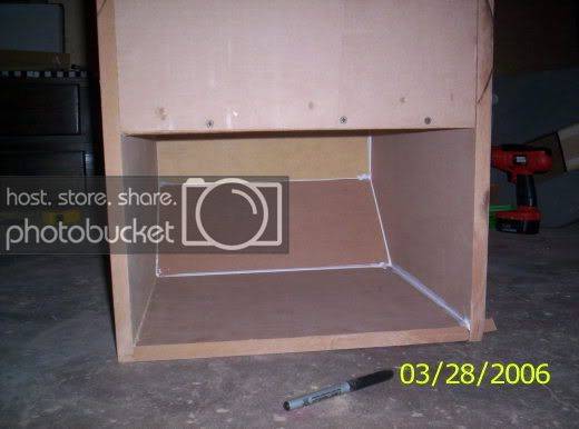

here is the font the completed box veiw from the font baffle
and here is the main port lookin in

thats not a bandpass at all
it looks more like a folded horn
if u was going for a 6th bandpass.(cuz the front of the sub was ported as well as behind the sub)
u should have made the ported area in front of the sub bigger
but all in all good score...i feel u can do higher but for what u did thats good

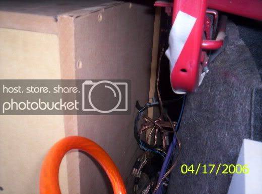

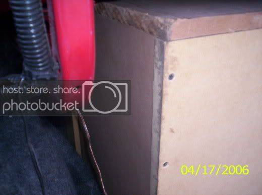

ok here is looking back at the box behind the rear seat
here is the trunk side
here is the passenger side
and here is the driverside the side the main port is on
and just for kicks the inside
