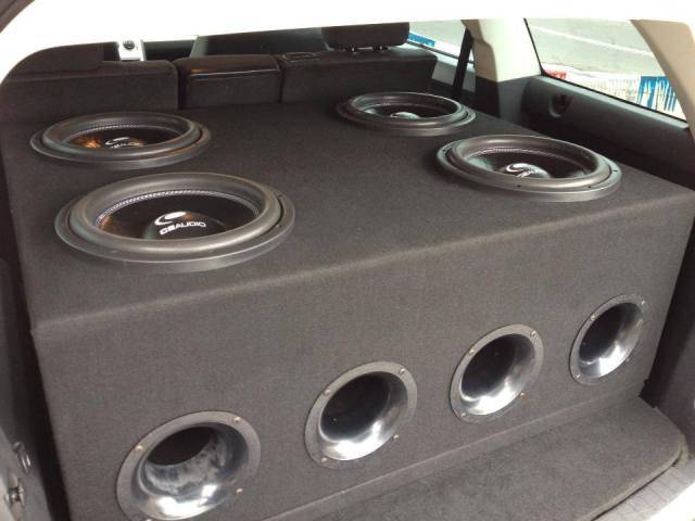

4 Threatcon-2 12's in 8.7 cubes, four 4" aeroports tuned to 38hz. Powered by 2 sundown audio SAZ-2500's. This is in the back of my Dodge Journey!
