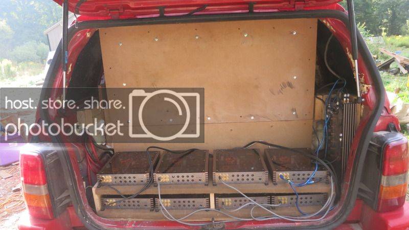

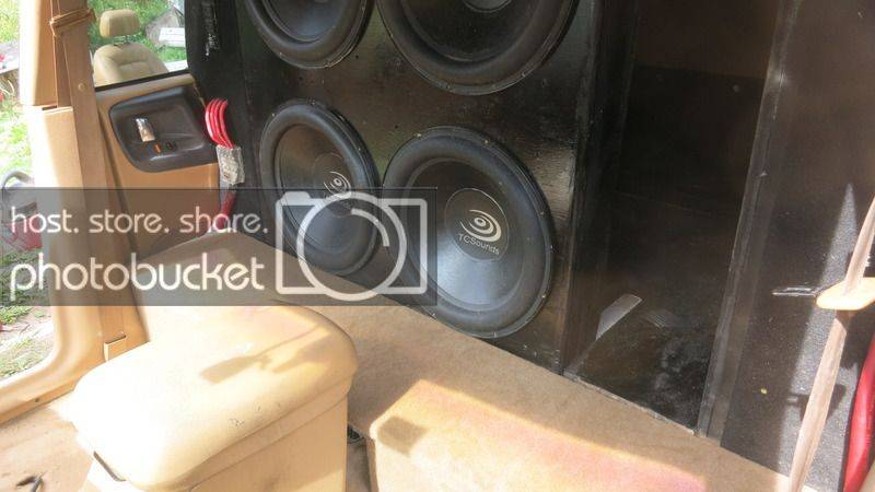

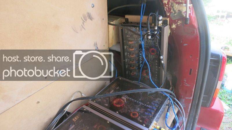

We did get the back on and the amps temporarily mounted for some testing. Still waiting on my alternator (though the new primary battery did arrive today).
I think I missed the mark on tuning by a fair bit. I can play down to 26 without unloading (I don't have any lower test tones). I'm leaving an awful lot on the table as far as the meter goes by tuning so low and I definitely want a proper alternator in before I try to push things.
I'm probably going to roll with it as is for a week or so and see what I think then perhaps try to carve out the port to tune higher.

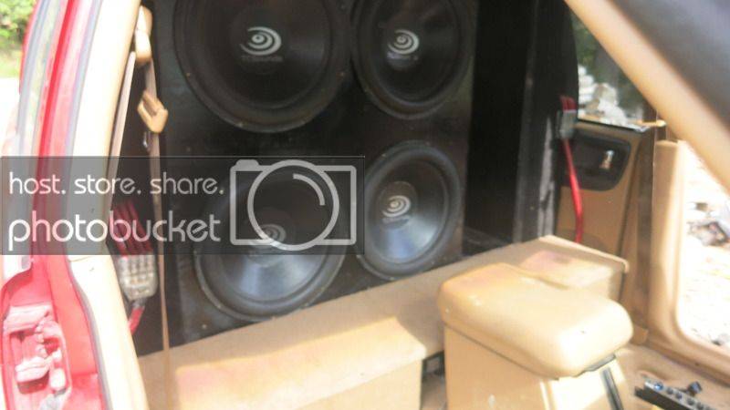

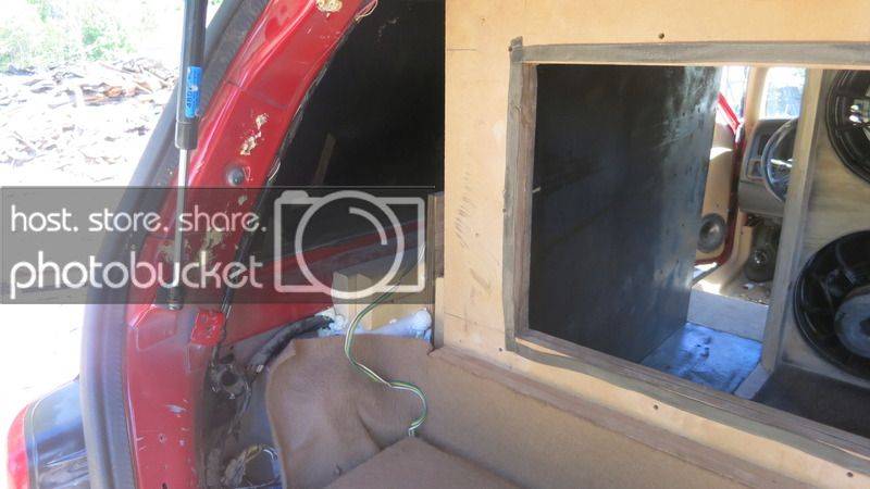

This actually leaves me a fair bit of cargo area in the back once I decide how I'm going to finish mounting the amps and cover them over. The removable window in the back fits airtight and seems solid enough. This will allow me to climb in there later for finishing and tweaking and also allow the entire box as usable cargo space when I need it for a long road trip or whatever. I'm very pleased with that feature anyway.

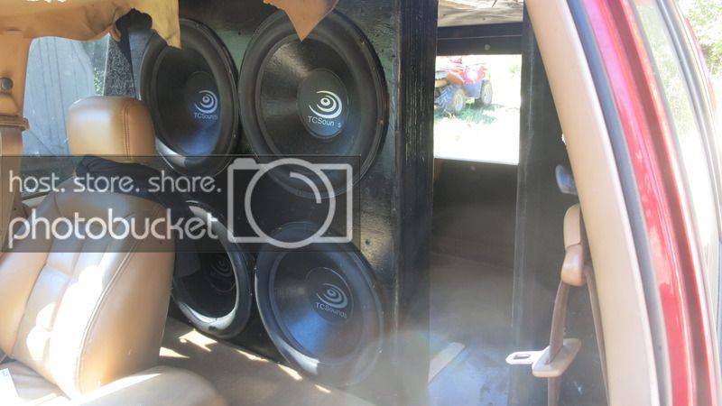

Lastly the headliner of this thing is a huge weak link. The thin cloth keeps falling down and it is because whatever it is underneath is just crumbling so pretty much nothing will stick to it. Compounding the problem is that I dumped half a dozen cans of spray foam between it and the steel roof to keep it from flapping around so much. I think I'm pretty much stuck with an ugly roof.

LOL. I bought Leviathan on pre-order V1 so it was considerably less than MSRP of current gen and got a friend price from Stephen on the Minotaurs just as he was switching to V2. What I have into these isn't as bad as what I had been spending on repairs on Chinese/Korean amps over the same time frame I've owned them..... AND they are all very efficient so I'm saving on the back end in batteries and having to step into a second alternator to be able to actually see rated power.

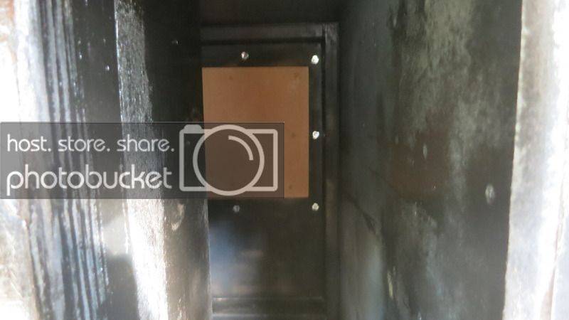

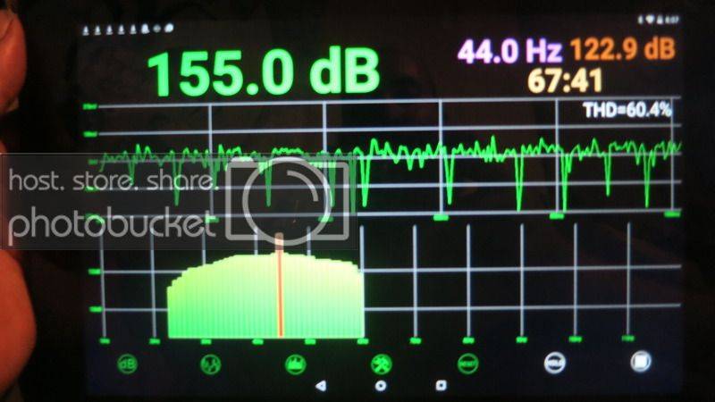

Still seems my peak is around 33hz now which needs to come up to 38-40 for my tastes. Not sure how I'm going to cut down the port and it's far too hot out today to climb in the box and try. If I can raise the tuning a bit I might could see some 57's out of it and still keep things musical.
Scratch that. It cooled off a bit as the sun started setting so we carved out about 7 inches of port length. Plays very flat from 30 to 60 peaking somewhere around 44-45 I think? Not much of a peak even, I'm really surprised, these subs model quite a bit peakier particularly in this much airspace.
Initial testing is promising anyway. I'll wait for my alternator before I can really dial in the gains then I'm sure I can gain more on the meter as I finish out the box or if I bother to take out the front seats. For now this is good enough to get me around town.

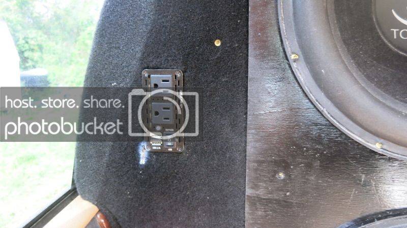

Got the battery box carpeted and installed an inverter which always comes in handy when I travel. Didn't notice the glue drip last night since it was dark when I finished up that'll snip right out.
Also very encouraging, doing some low power testing it seems I gain about 2.0 dB on the meter from taking out the front seats. I figure next weekend I'll have a chance to get the new alternator in and do some real testing.

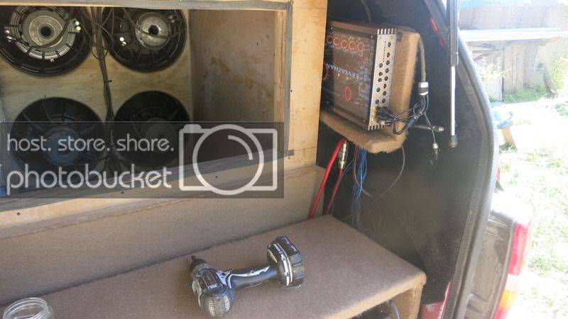

New home for Leviathan. This keeps it out of the way so I don't have to worry abut it getting smashed up when I use the back for cargo space.
Ran out of the tan carpet, will see if I can find just a little bit of black local and finish off the side with that.

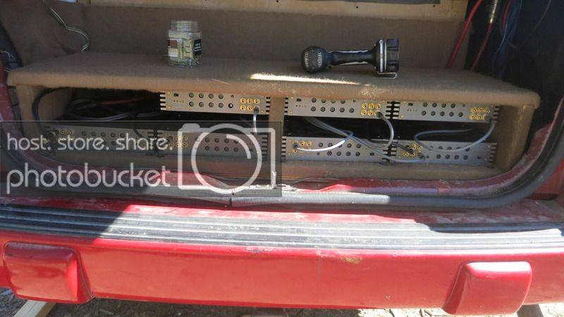

Upside down mounting is sub-optimum but from testing they didn't get terribly hot with the old rack and no space anyway, so this saves material and a little space. Got one amp out for a tune-up right now. Still pretty loud with only 7 but sounds a bit off. Stephen says it's on the bench today so hopefully it'll be back to me by the end of next week.
Headliner is a disaster. It simply won't stay stuck for more than a couple days before it comes flaking off again. Also put a little sanding into the port.
New alternator also went in this week which seems to hang with the 7 amps easily so I suspect when I'm up to full power I should be good. Excessive gave me a super price on 6 phase and it's pretty sharp looking as well. Would still recommend him to anybody in the market.
1 or 2 cap banks if you need it. Made a big difference for me
These amps use regulated power supply so they make rated power at any input voltage. Lots better places I could drop that kind of money I think.
