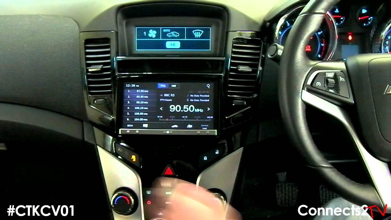

It will likely be much harder. My 2012 Cruze's factory HU was completely integrated in the car. I think you had to keep the factory HU and there was a nifty little spot to place another after market HU underneath. But the car wouldn't run right without the factory HU. But, unless they have amp pre outs, I'll likely be looking for a new HU. And as far as the X3600BHS. I'll probably be getting an upgraded model from Pioneer if I do go that rout. Pricing shouldn't change too much, I'm I'm trying to calculate how much I should/want to spend on my next build.
