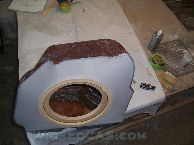

OK, so I am building a custom fiberglass sub box for my evo x, and will be putting it in the stock location of the factory sub box. Here is an example of an aftermarket one that is about 1.0 cf and mine will be a little larger, probably about 1.25 cubic feet.
The reason I am making this post is not because I dont know how i want to do the box, but because I am concerned about the sound of it.

OK, so I built my box, and after measuring w/ peanuts, I was able to verify that my box is about 1.65 cu ft.
Right now it is a sealed box. I did buy a port it is a 3.75" x 7 inch port. I am debating if I should keep this a sealed box, and if 1.65 is good for a sealed box with a 12" W6v2 w/ a JL audio Slash v2 amp. This will be in the back of an evo w/ a very small trunk.
Should I keep the box sealed @ 1.65 cu ft, or should I add the port in at 1.65 cu ft?
what would the difference in sound be between the two?
