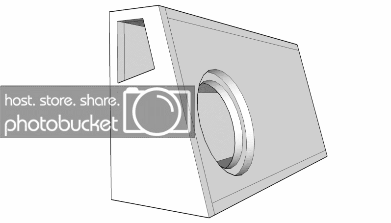

right i know that box is TOTALLY trash im not gonna use it like i said it was for fun i had the stuff lying around wanted to do get a general idea. also i found this image floating around and was thinking hmm maybe if i build 2 twin boxes or one box with the same thing on the other side mirrored

Use MDF or birch for you box....and use this site to help you design it.
RE Enclosure Calculator
As for box size, per 10" will need about 1.2-1.7cuft and for a 12" you'd need 1.7-2.5cuft
Two 10" subs wont sound any better than a 12" no matter what anyone has told you...they will just sound louder due to more cone area.
I would post more info..but your paragraph is pissing me off...
yeah cool thanks that helped i have enough space for 2 10's. also if i had to go with 1 frequency that really hits low would 32 be a good one to go with?
