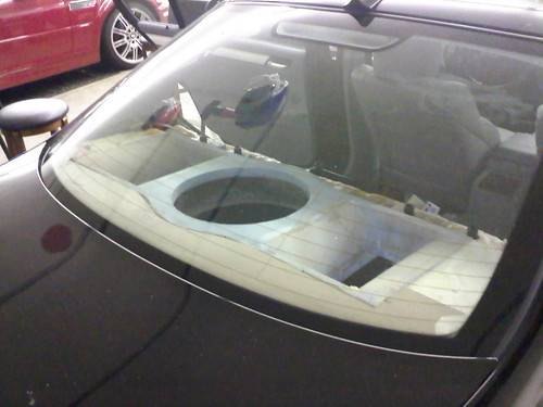

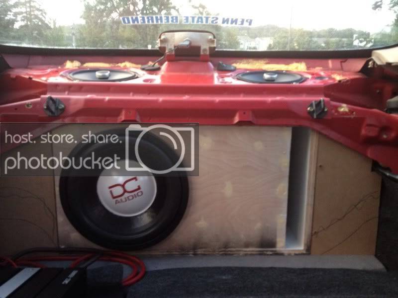

I was thinking something like this with sub and port firing directly into the cabin. Make sure you seal around the edges
Ahhh that makes sense, Thanks for the pic. I could possibly do something like that but it wouldnt be actually into the ca b of my car because of the caddy's awesome electrical and Bose setup.. I'll try to upload a pic
Haha that setups ******!
But yeah I'm still trying to install a new head unit with the weird *** Bose system it blowsss lol but good to know I appreciate the feedback
that pic is kinda a close up of my trunk, its a big trunk if i did my math right I easily have 9 cf of space but if I try to do a similar setup to that DC audio I think you're definitely right with going to a 15" instead

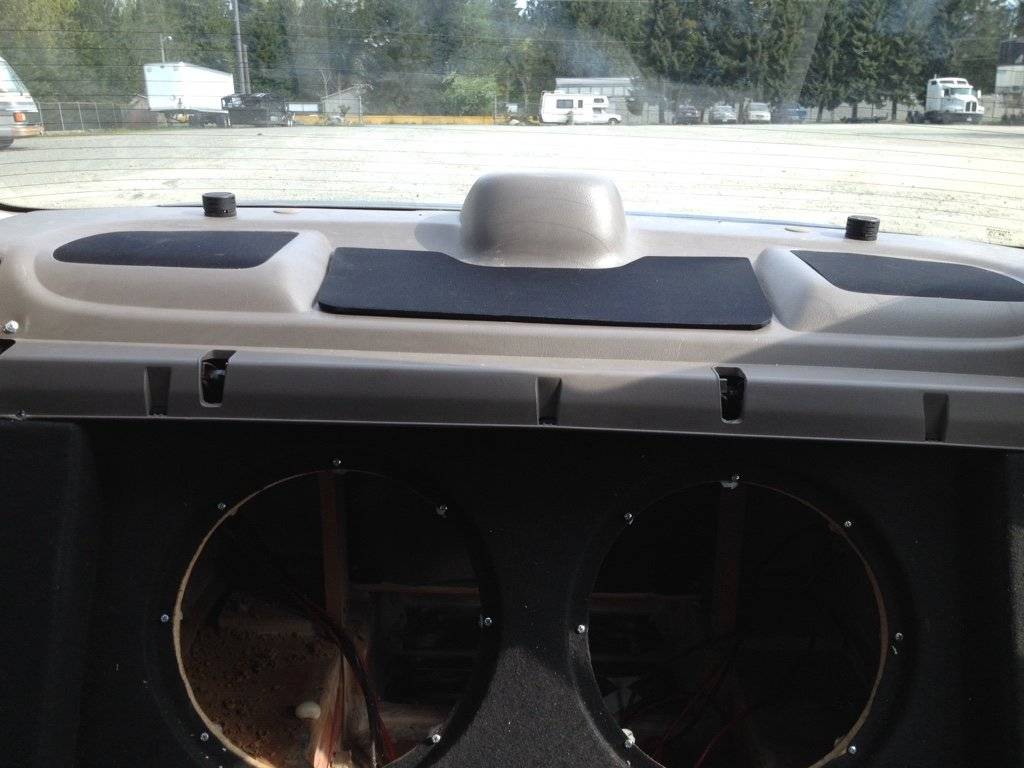

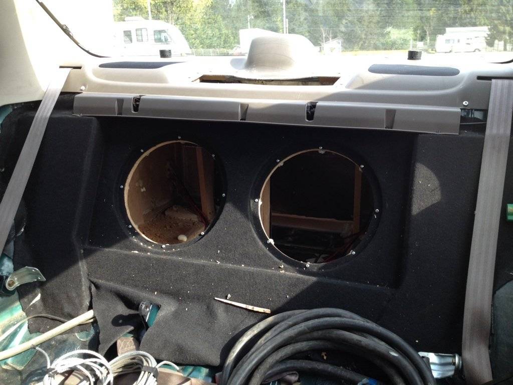

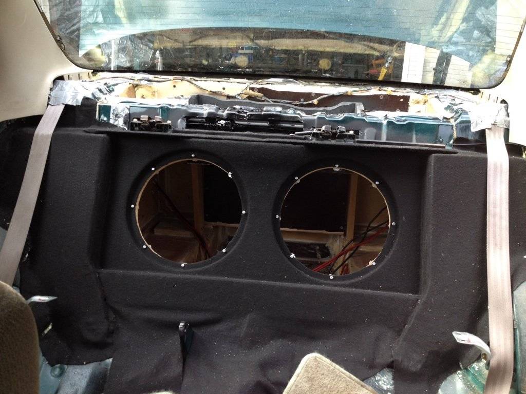

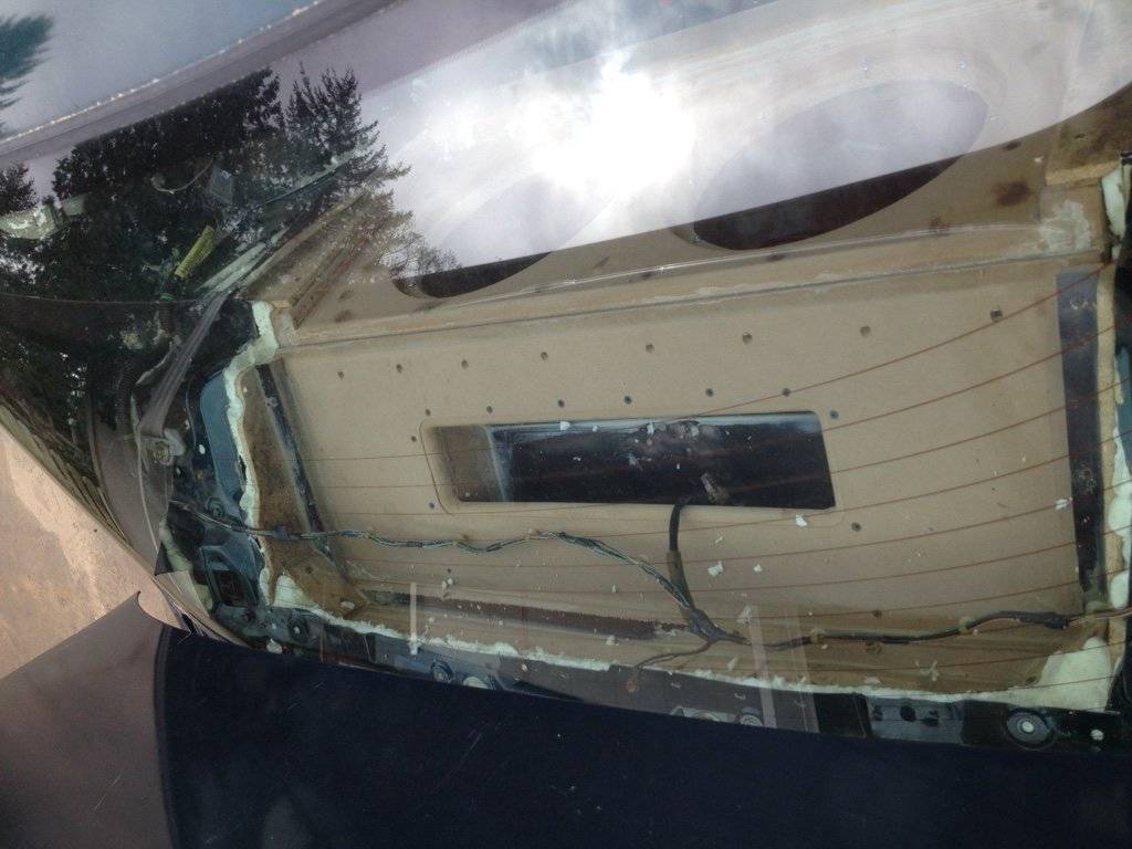

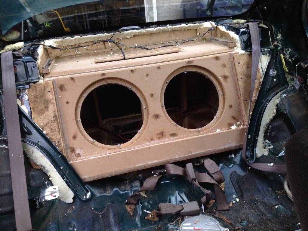

Here is a few more pics
Sent from my iPad using Tapatalk
---------- Post added at 10:41 PM ---------- Previous post was at 10:40 PM ----------
Oh ya it's a 98 civic sedan BTW
Haha that setups ******! But yeah I'm still trying to install a new head unit with the weird *** Bose system it blowsss lol but good to know I appreciate the feedback
L x w x h but you will have to subtract 1.5 from each for wood thickness. Get the cubic feet then subtract the space subwoofer will take up and a rough estimate of 20 percent of the enclosure volume for the space the port takes up.
