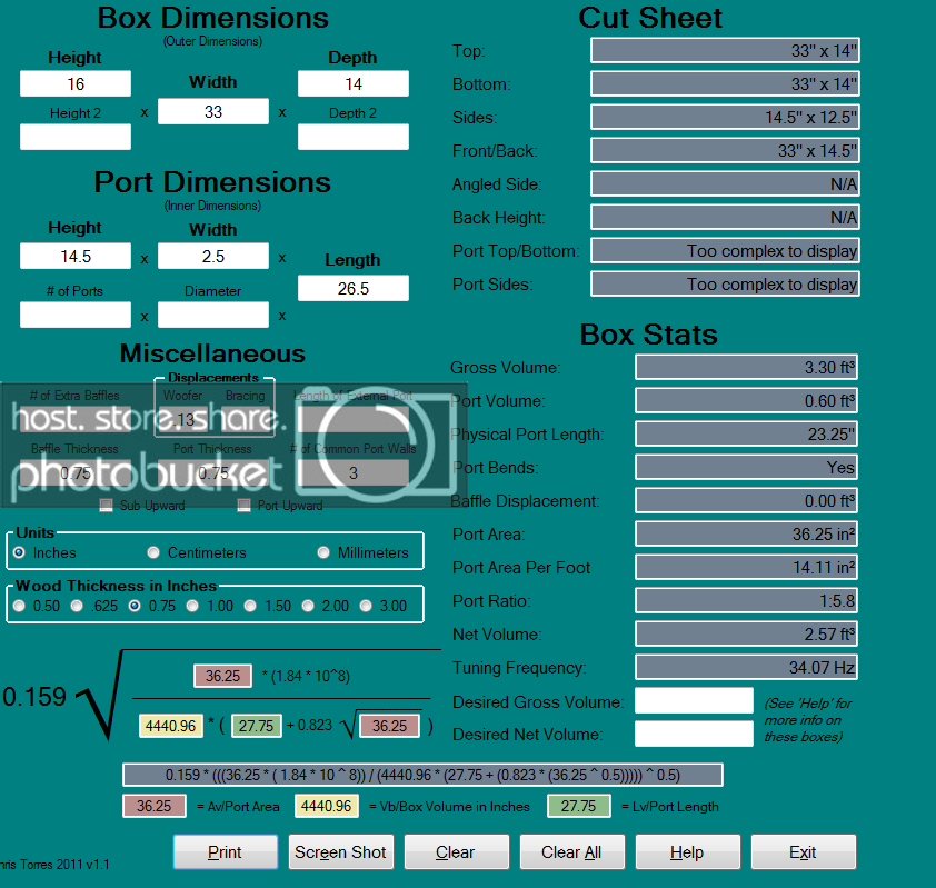

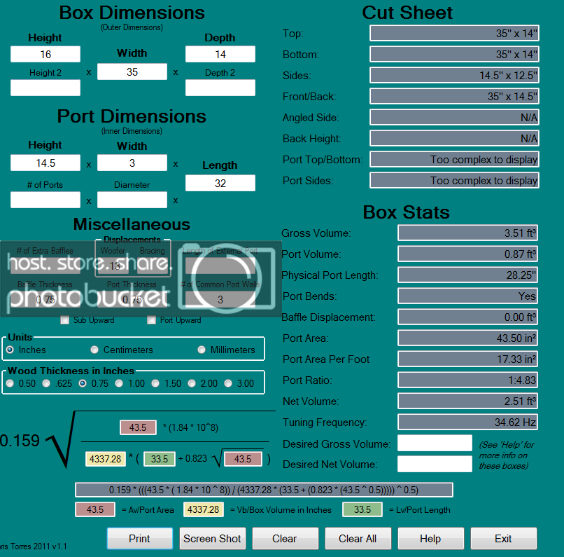

Enclosure for XFL1244
34 hertz will work great. but me id tune around 28-29 hertz. also it depends on what type of car/truck/ suv it is because they all like different tunings. large areas like vans or suvs, u can get away with higher tuning but in smaller cars u have to tune the box lower and u also will have (( box rise) the americanbass xfl is one of my faviort subs i cant tell you how many times ive workd with one and every single time they sounded good .
im also a fan of round ports, slot ports dont sit right with me in terms of design but yet again im just picky with my own things... but like i said dont worry about it because ur box is fine and ull have plenty of sound tickets along the way
