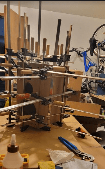

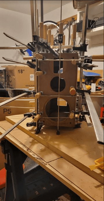

I also prefer to use clamps and have about 48 pipe clamps around to do just that. For my very large 12 cu ft box made of all 1.125" MDF, the pre-drilling with a KReg jig and using pocket screws really makes the clamping manageable.
If you don't have a brad gun or a lot of clamps, then they are a must. Countersinking them around an .25" makes for an easy $5 puddy job. and clean surface to pain or carpet. Countersinking is a necessary evil if you want a nice clean surface to cover or paint.
Building my grandsons speakers...
Dammned that looks awesome. be a great picture in a workshop!! I have maybe 6 steel ratcheting type clamps, if that. much like the ones you have on the outsides. Great Clamps! Cool Pics!
