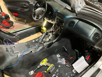

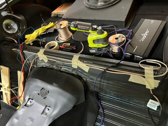

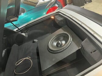

Well I'm almost done. I ended up using stuff i had on my shelf and only thing i bought for the project was the head unit which ended up being a Sony.

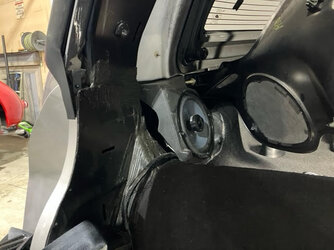

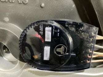

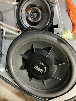

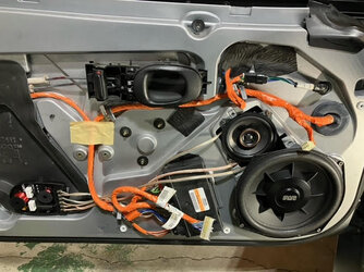

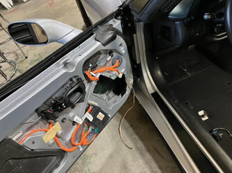

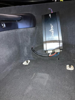

So Skar amp behind the driver seat to power the 15" Skar sub. behind the passenger seat is the Clarion amp that will power the component speakers. The component speakers consist of JL Audio 6.5" in the rear and up front in the doors is a SWS 8" with a Kicker DS 3.5". both these are ran through the JL Audio crossover.

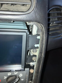

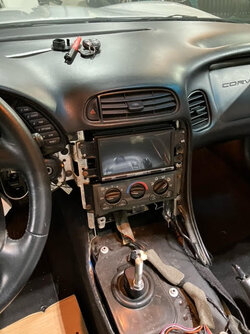

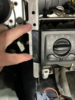

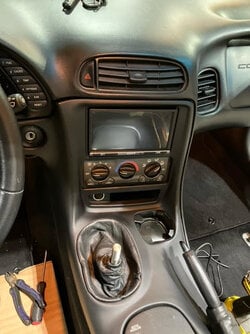

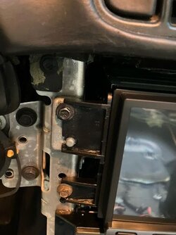

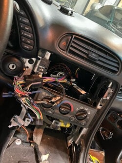

I took out the single din center console and replaced it with the double din console off ebay.. fitment was pretty good and install was easy.
Not sure how it sounds yet and I'm sure it will need some good tuning to get all these different brands what not to blend but for my weekend cruiser.. it will work
