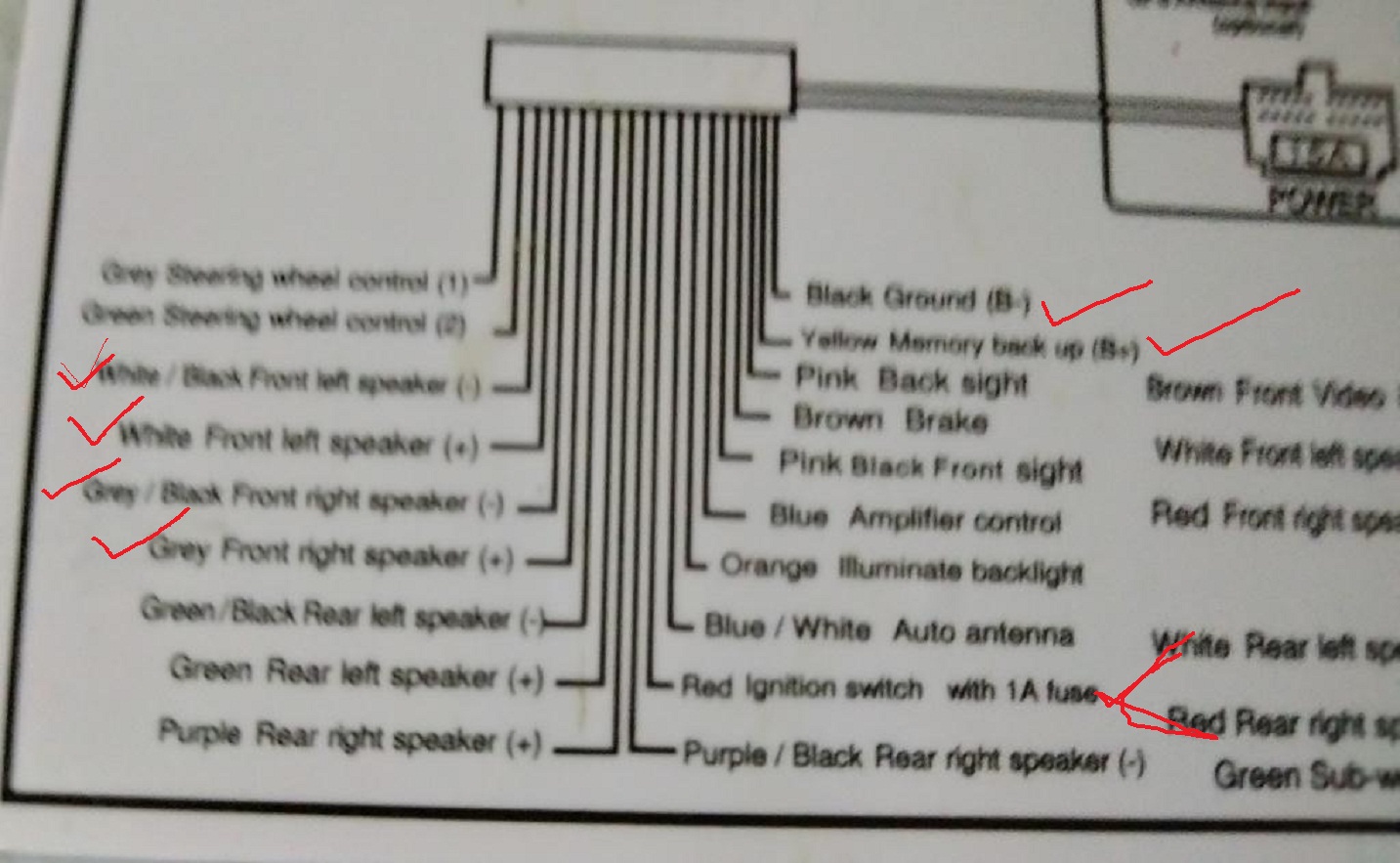

into my 05 Chevy express 3500 van it does’nt have steering wheel controls or amps. So I’d prefer to just run speaker wires an other required wires from back of the blaupunkt.
Here’s the wireing diagram on the blaupunkt I checked what I think are the required wires.

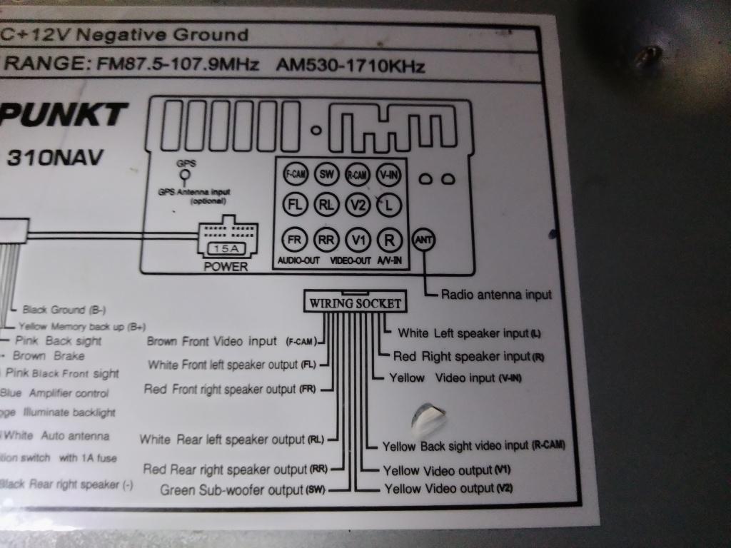

Since I’m not using a external amp can I bi-amp the front speaker wire w/ the backs?or is bi-amping only for external amps?
Also confused on speaker inputs or is this just for the rp4gm11 an using the vehicles amps?
Planning to use just fronts one pair of 3ohm speakers to make up for the lack of external amp.
Also use the Orange wire. It will be constant 12v.
Yes, you can bi-amp your co-axials. You just separate the tweeter wires ftom the terminals and splice them to the front channels. Then the Rear channels to the 6.5s. TBH I do not see a benefit to doing that. The speakers will get the same power whether you keep them as is or separate them.
I have no clue what those inputs are used for, but you can just tape them off.
