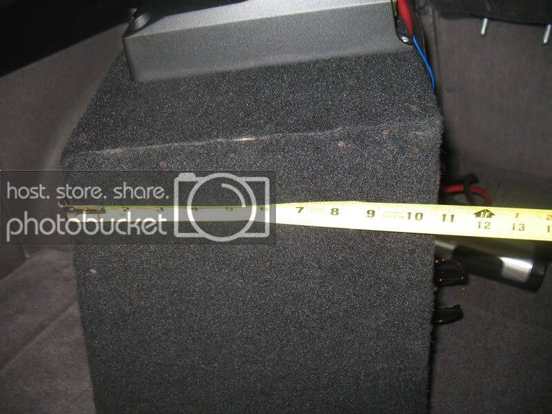

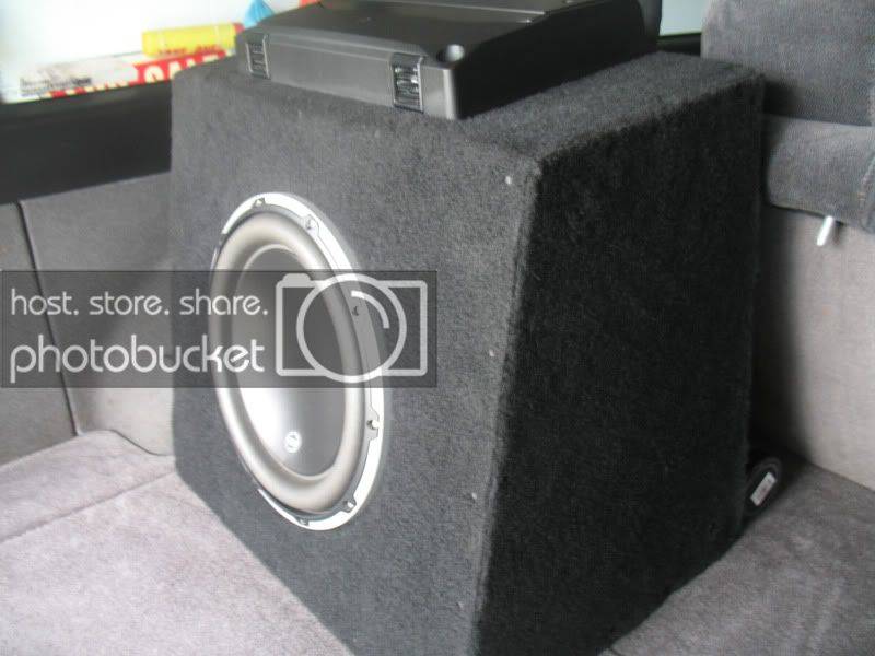

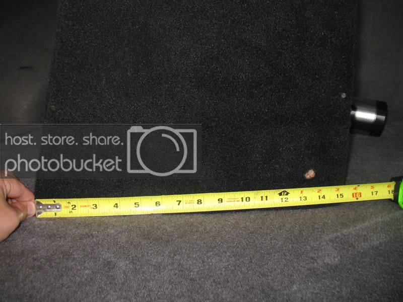

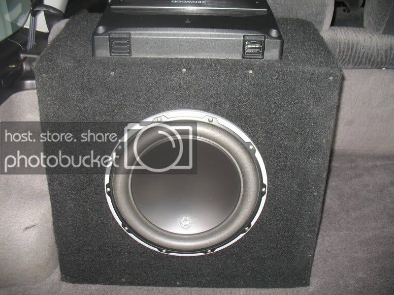

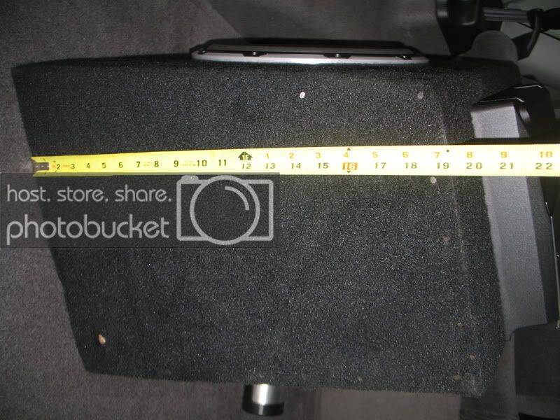

I'm new to this forum, but I hope I can get some good help. I have had my JL Audio 12W6v2 sub since November of 2009. Me and my friend built the box(See pictures below) for it, but its not a very good box, at least not for this sub. At times when i'm playing music I hear a noise and it sounds as if the back of the sub(magnet part) is hitting the back of the box. I may not know to much about this stuff, but I know for a fact that can't be good for the sub. Tomorrow I want to build a nice box that will make my sub sound even better and deeper. I just don't know what kind of box to build? At the moment my box is enclosed, but everyone always tells me that ported is better?

I got the 1800 watt Kenwood Amp, not the best from what I heard but I already have it so w.e.
Any help please? I just measured the distance of the sub and the distance of the box(width) and their is no way my "theory" of the sub hitting the back of the box would be true. Any idea on what could be making the hitting sound? It seriously sounds like something is hitting a box when i turn up the music loud?
Its the sub bottoming out within its own frame. The sub doesn't move within the box. The cone is the only part that moves. Regardless of how shallow the box is, the sub can't hit the back during music.
You're sending it too much power for the enclosure that it is in. That is what's causing the smacking sound and it will destroy the sub. Adding a subsonic filter might help. Building a new box might help as well. A ported box will up the output with less power and coupled with a subsonic filter will better control the cone and keep it from bottoming out.
