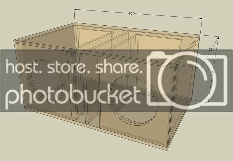

so ive been tryin to build a box for my 2 kicker 12" CVX for about 4 months. Cant do it help me out.
this is what kind of box i want.
Freq= 31-35 hz
Volume= 3 cuft per sub
kind of box= ported/ square slots
now the dimensions of my car.
W=44"
H=19"
D=27"
Could someone help me out here. my old box worked but it was to long for my new car.//content.invisioncic.com/y282845/emoticons/verymad.gif.3f39c5c2fd57527b671fad3efdfac756.gif//content.invisioncic.com/y282845/emoticons/pissed.gif.9f665f96bc89e98e708dabd4580bb591.gif
possibly i need someone to try to build one on sketchup or something because with the guidelines i gave i cant build a box that fits. (ive used sketchup. need someone that knows what they are really doing)
i like that design but i want a port for each sub like this. (this is my old box, everything works on it but it is just to long for my car. a matter of 3"s!!! Do this same design but could someone make it to my specs, Thanks)
I just built a box for my two cvx 12's. Its 36"w/21"d/15"t, with a single port... I ended up with 2.25 per sub and .76^3 ft for the port around 5.37cu ft total internal. I have it tuned to 31 hz and it slams and gets pretty loud! My port is 5" wide and 12" tall and 22" long... Maybe this helps, its definately smaller than your deminsions.
I don't know why you / the designer was having problems you have plenty of space. Do you want it to be a shared chamber or separate?
