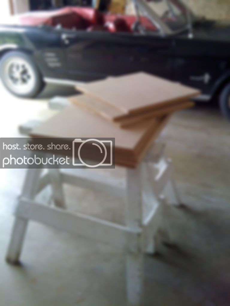

After a trip to Home Depot for a few things...
I know you see that special something in the background;)

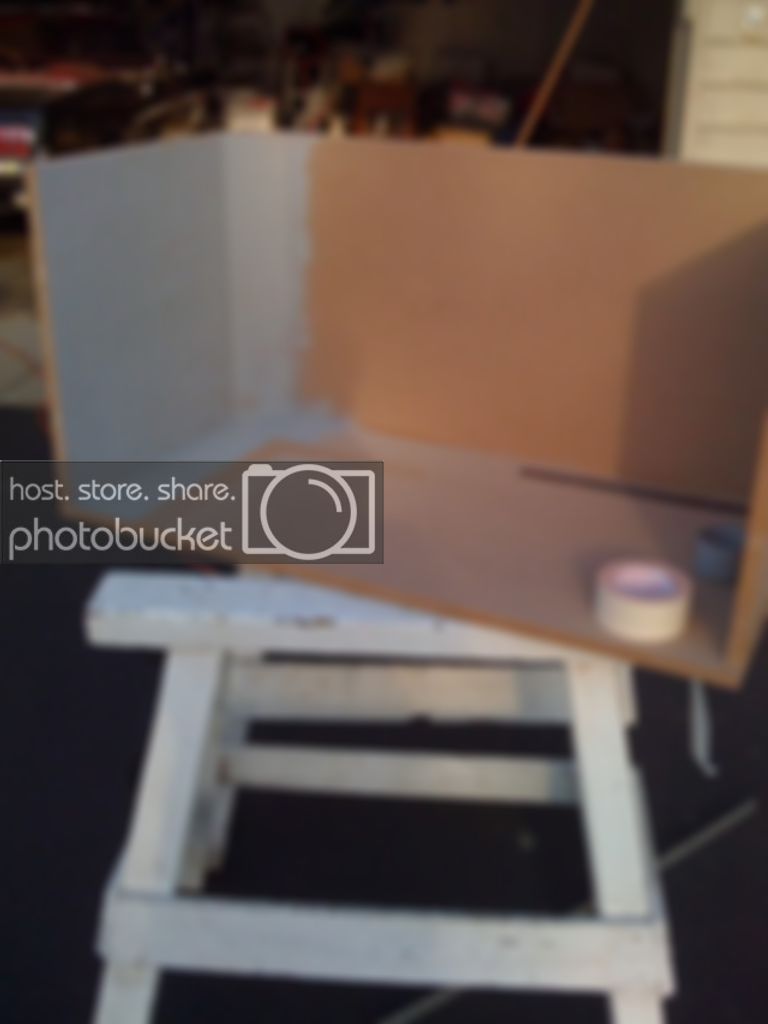

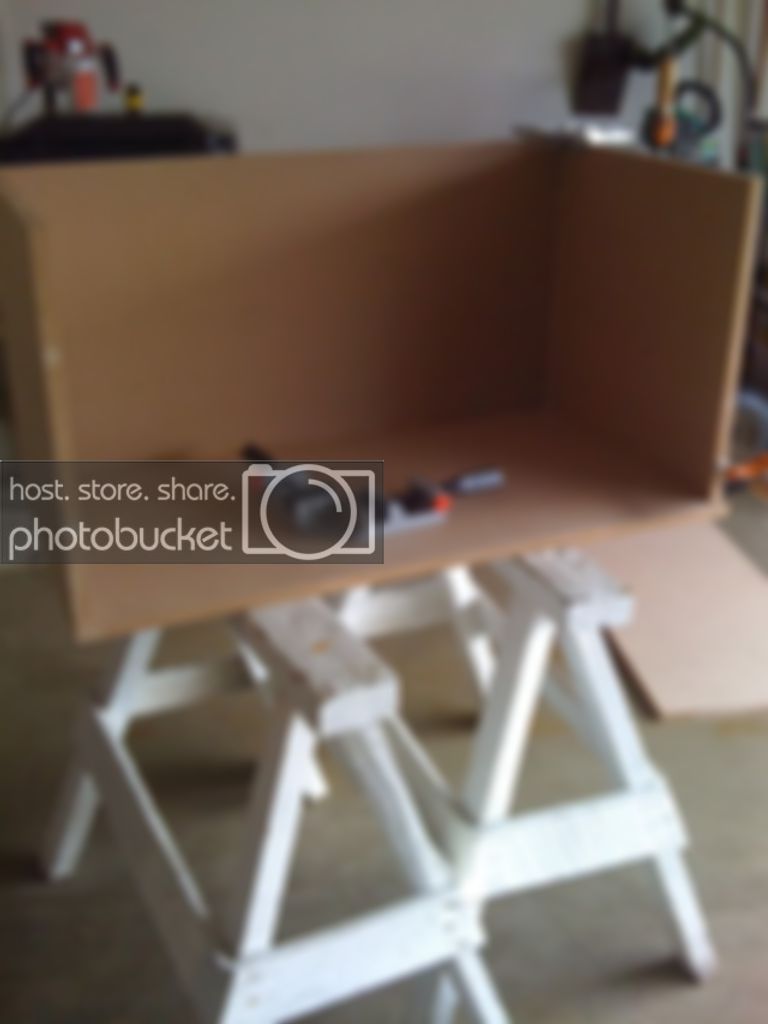

Sides up
Port painted in gray primer (who cares, it's a raw wood box anyways cuz my friend is a cheapo //content.invisioncic.com/y282845/emoticons/laugh.gif.48439b2acf2cfca21620f01e7f77d1e4.gif

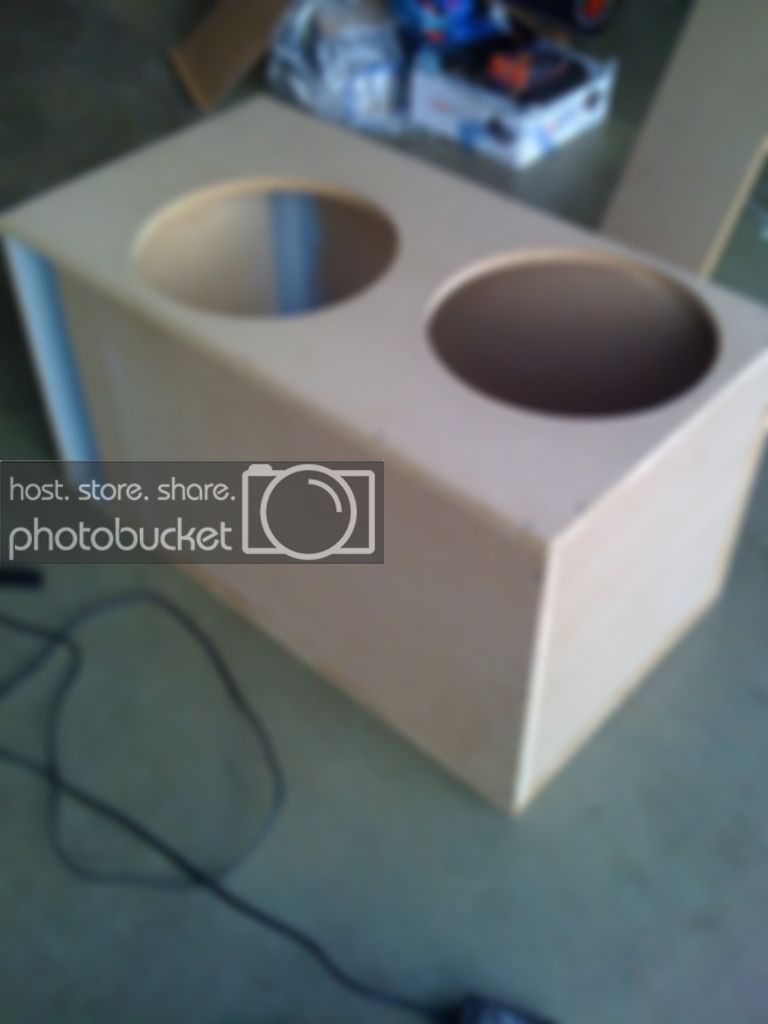

Front and top of box installed and holes cut
Don't worry these pics don't show it, but there is a vertical brace inbetween the subs going from the bottom of the box to the baffle.

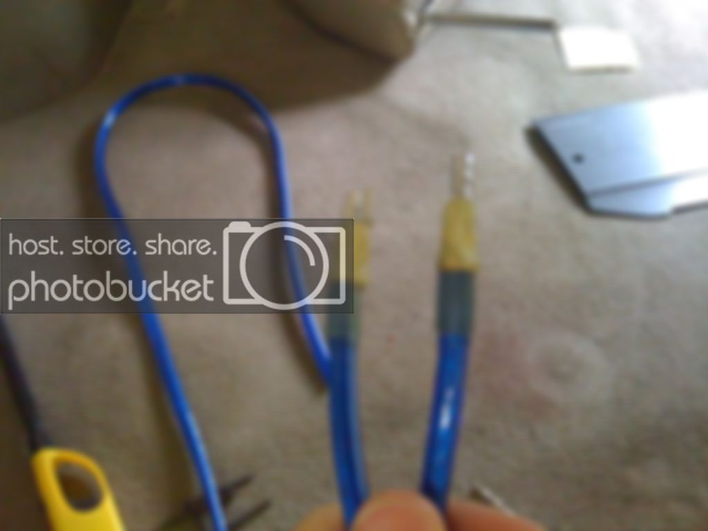

Some nice 10AWG wires I made for the speakers with some terminal ends and heatshrink tubing.

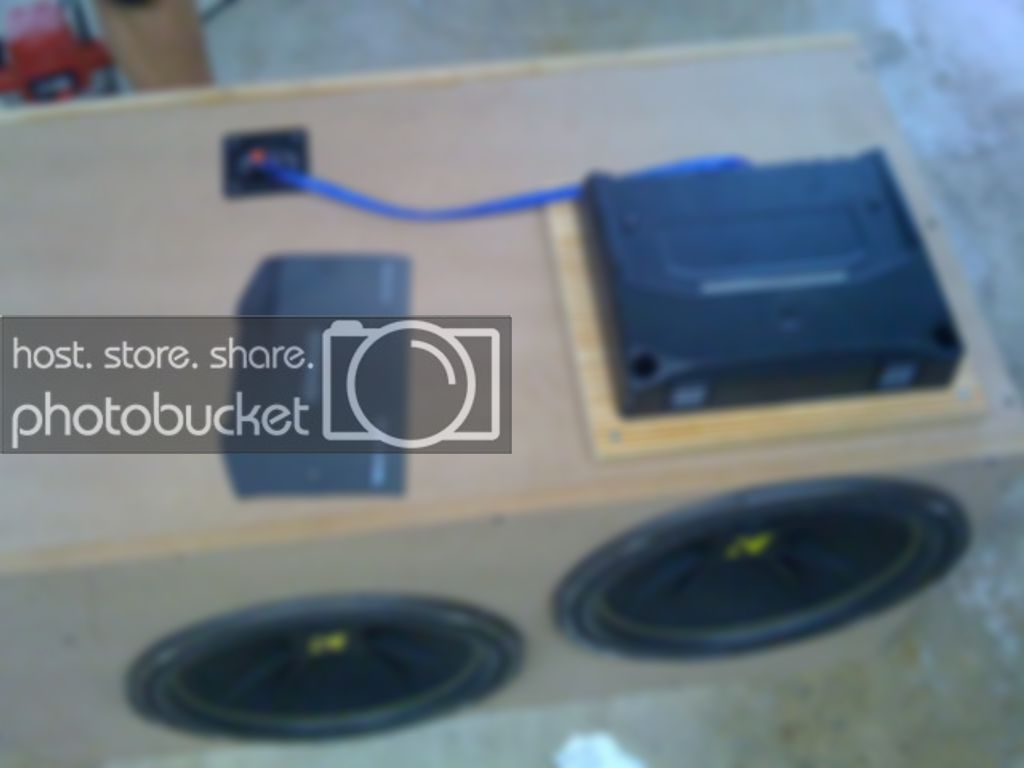

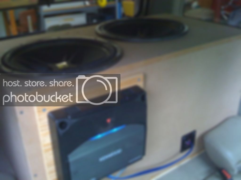

Wired the subs in parallel for final load for 2 Ohms and put in a terminal cup and wired it to the amp... do not ask me why my friend attached the amp to a piece of wood and then screwed it to the box. I gave him one job to do... mount the amp while I did the splicing into the factory radio and I come back and this is what I find. Whatever, not my slaps //content.invisioncic.com/y282845/emoticons/laugh.gif.48439b2acf2cfca21620f01e7f77d1e4.gif

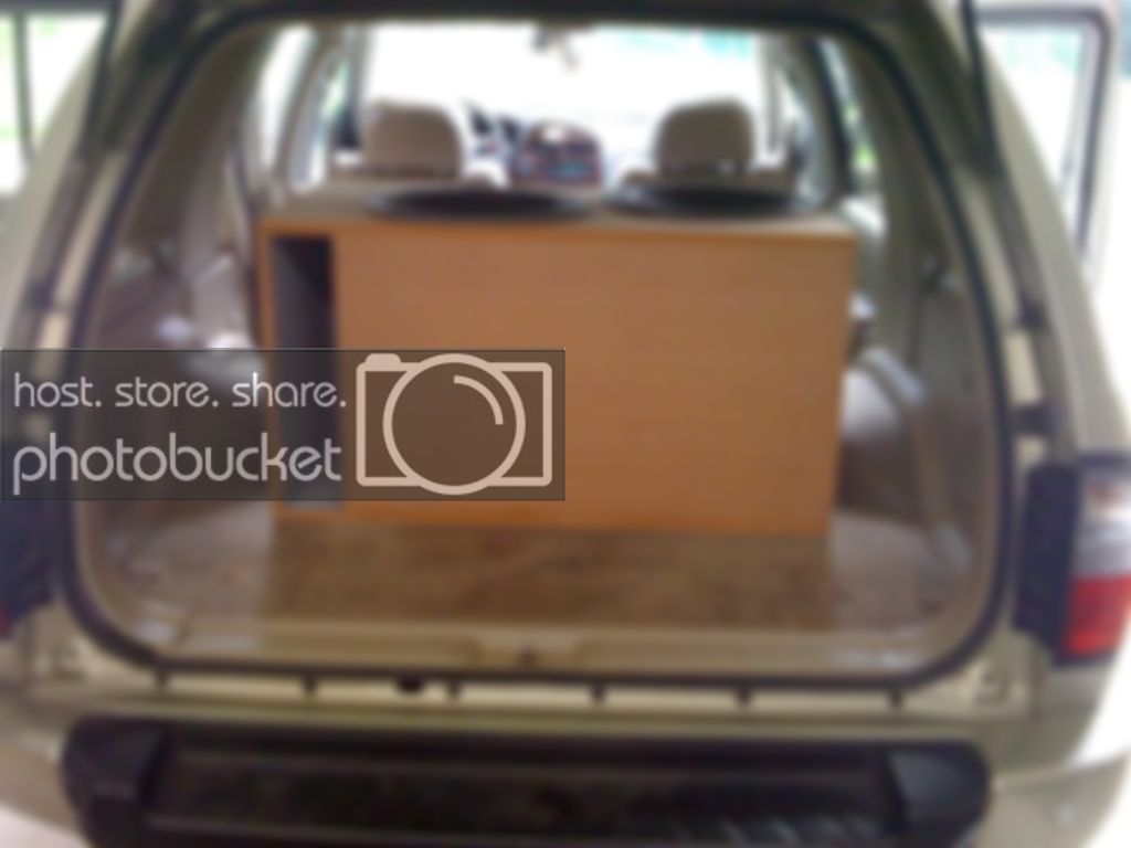

In the car and all powered up. Seat folds back fine, just had it folded forward while I was adjusting the gains and x-over
King kong in the trunk!
Ran into a few speedbumps along the way, such as the signal to the amp. I originally spliced a Hi-Low signal converter (LOC) after the amplifier in the trunk but apparently it had its own set of filters and the subs would really die down on the lows. After some help from the people in Wiring section, found out a solid low-level signal before the amp and I tapped into that and spliced/soldered in a set of RCA jacks. Hooked the amp up to that and it SLAMS the lows now. The little shade thing that you pull over the sunroof came off the track and it's just bouncing around now.
