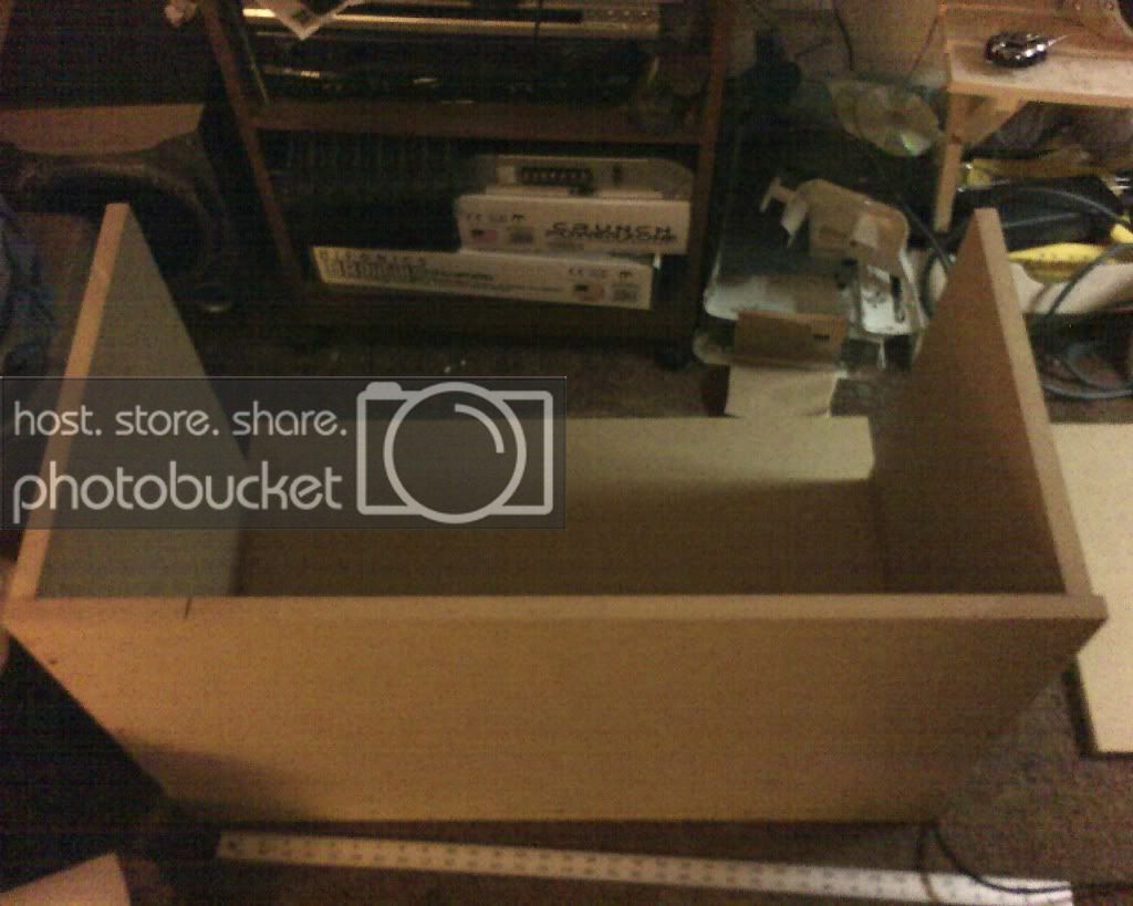

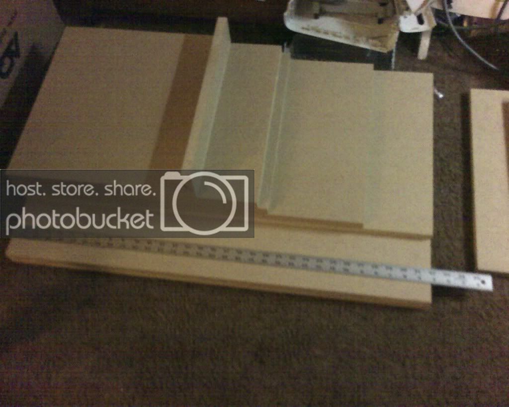

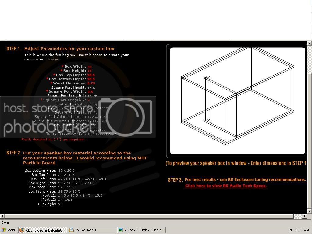

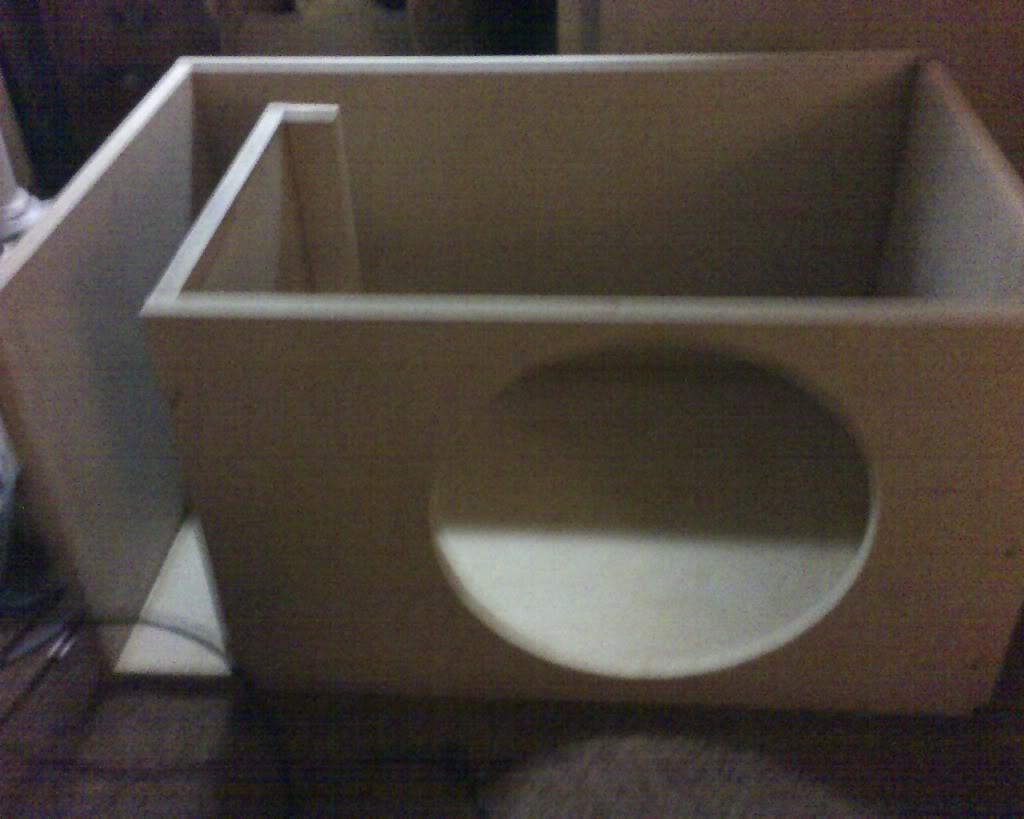

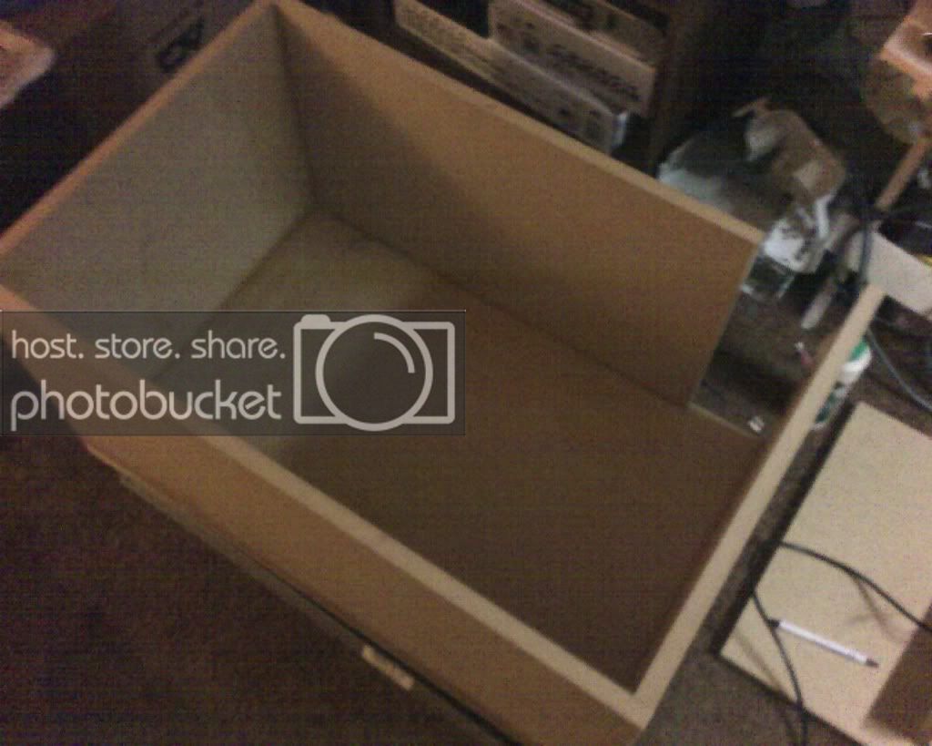

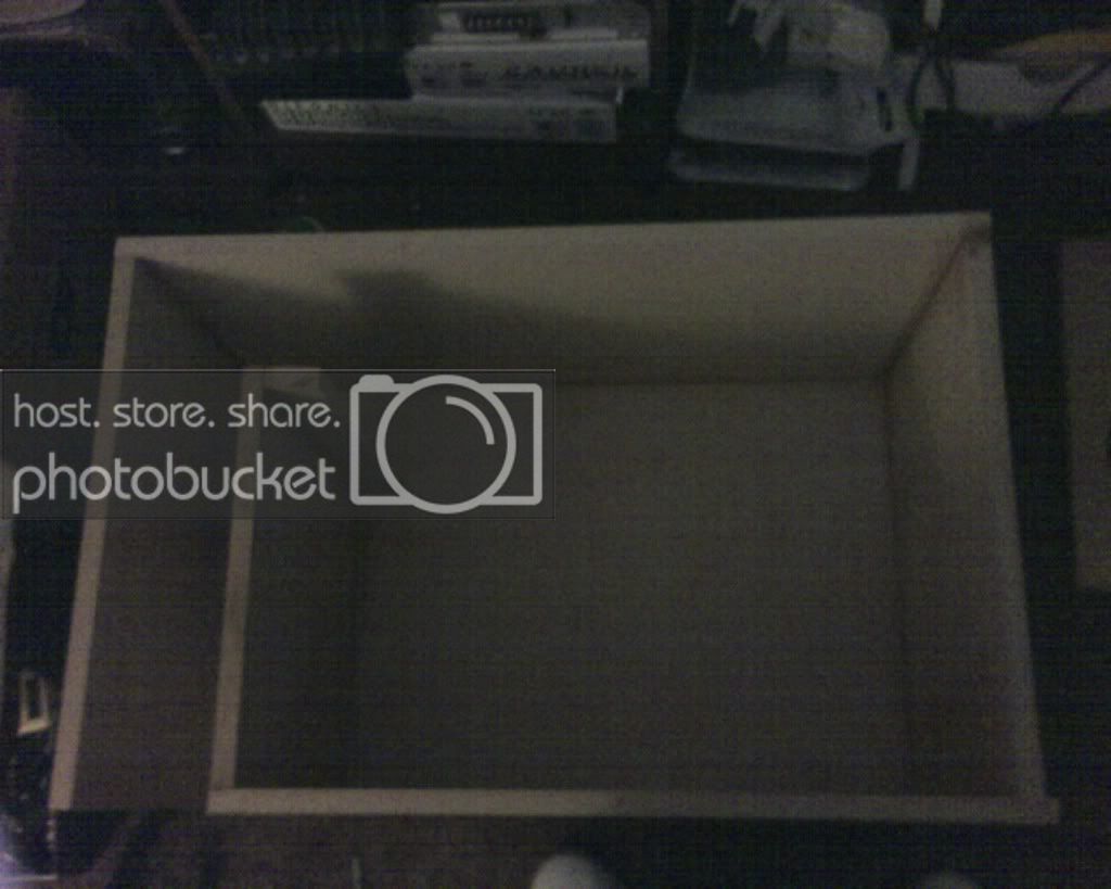

So I decided to build my own box for the first time. The build took about 3 days or so, not the best, but, for my first box I'm happy with it. The enclosure is 4^ft3 net @38hz after .15 sub displacement , dimensions are 32x20.5x17, port is 4.5" in width, total port length of 24.75 and sq. port area of 69.75. Used only tb3 and like 40 1 5/8" coarse drywall screws, I know its a lot of screws but I can always remove them and fill in the holes i guess(no clamps:crap:). Ended up not fitting in the trunk, building new one as we speak, but, I was able to get it in the back seat of my 94 century //content.invisioncic.com/y282845/emoticons/biggrin.gif.d71a5d36fcbab170f2364c9f2e3946cb.gif, sounds amazing, especially with the sub inches from your ear, pushed some clean, loud lows. Just thought I'd share.
Looking good..

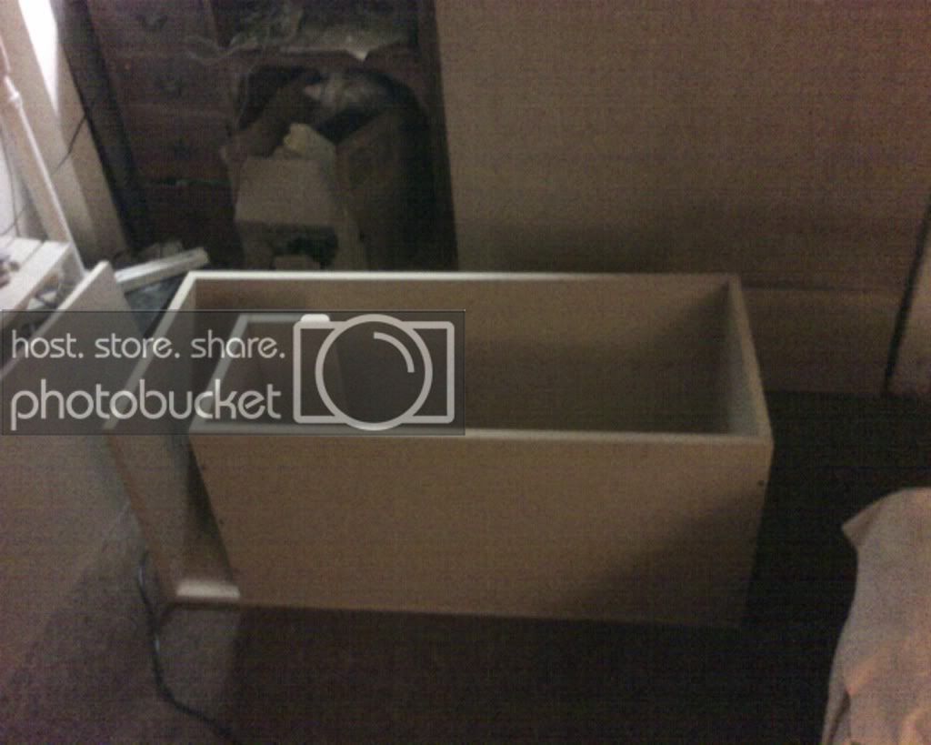

Thanks. Since this one didn't fit I picked up more mdf and started a new one, its almost done just have to glue the top panel on, only fit in the trunk with it off, gotta glue it on inside the trunk, //content.invisioncic.com/y282845/emoticons/crazy.gif.c13912c32de98515d3142759a824dae7.gif going nuts trying to accomplish fitting this big of a box in my tiny trunk.
Re-designed enclosure all glued up and ready to go, already in the trunk, just need to add top panel. This one is 39x17x17.

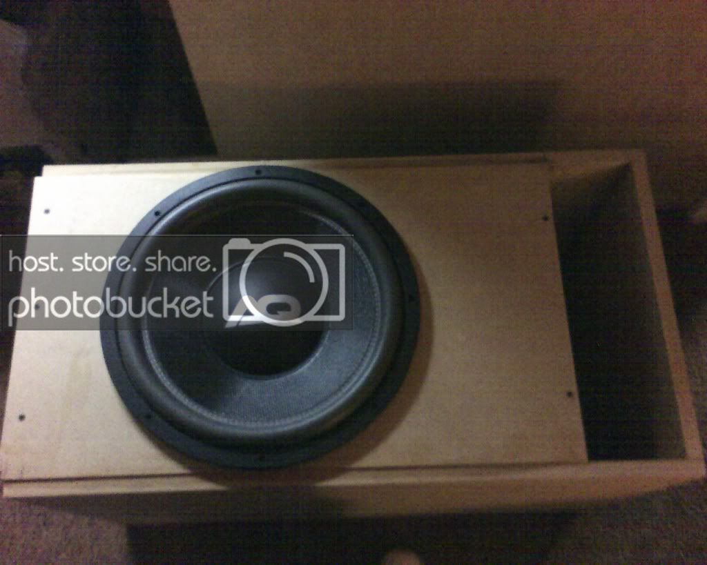

Thanks. Ya, with 4 cubes @ 38hz these subs get **** low and loud. Unfortunately I got ahead of myself and didn't realize exactly how small and a pita the trunk of a 94 century can be to fit 4 cubes in //content.invisioncic.com/y282845/emoticons/redface.gif.62fdbfe1a101588a808c4cff71bcb942.gif. The box didn't fit at all, so I put it in the backseat sub right behind my head //content.invisioncic.com/y282845/emoticons/biggrin.gif.d71a5d36fcbab170f2364c9f2e3946cb.gif. Just hearing it for an hour or two is enough for me until I get the perfect box dimensions for my trunk. I was amazed at how the lowest note in hypnotized hit the loudest:crazy:. Going to get to work on a new box tomorrow.
