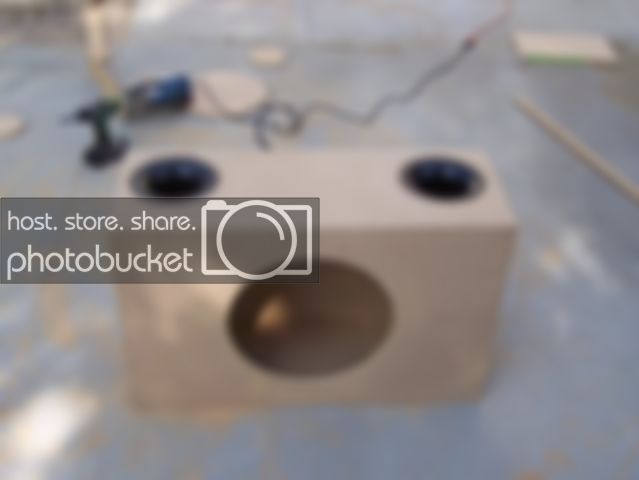

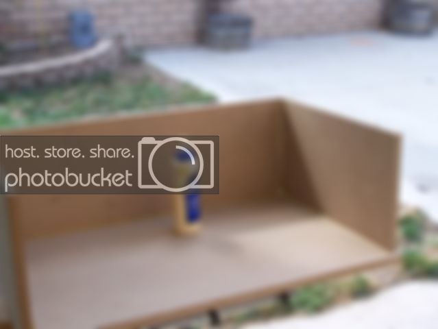

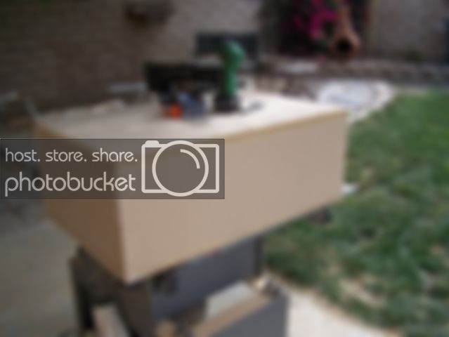

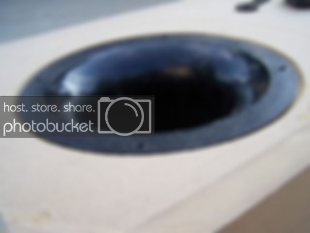

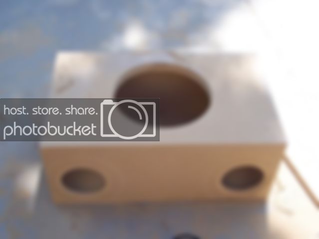

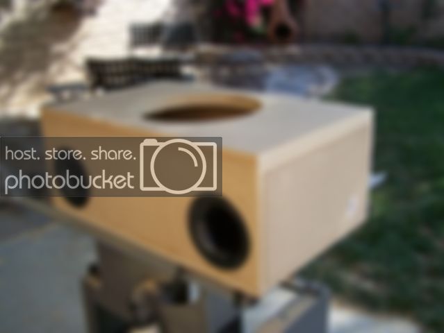

Box is 3.5ft^3 @ 33hz. two 4" Flared Ports. Driver will be a 15" Eclipse TI Pro. 4hp MONSTER!
View of the side

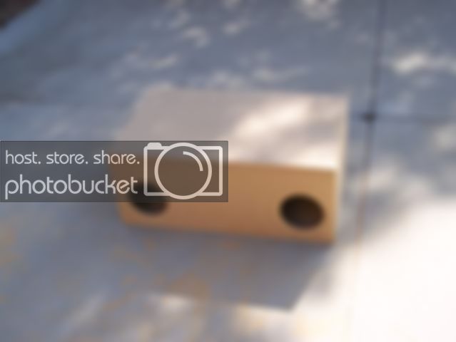

Flushmounted Port

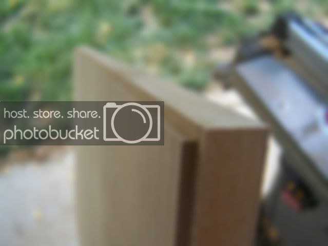

Nice work. Is the "track" around the edge to put carpet in?
yup. makes it a whole lot easier to carpet any edge lol. cuts total build time down about 30 minutes but mostly looks hella clean
edit: you can do this with just a dado blade on a table saw BTW. takes long as **** lol
