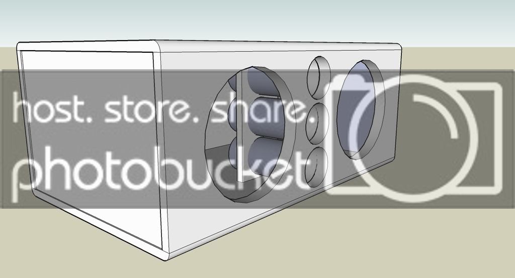

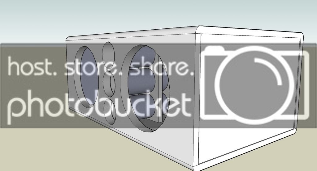

Build For lambofgood91: 2 HDC312's in 5cf @ 40
jmanpc
CA.com Nostalgist.

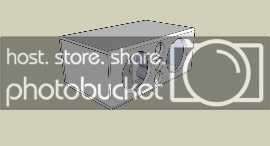

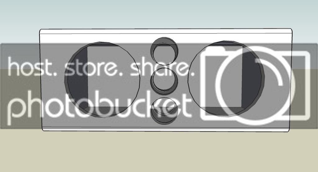

36" wide, 22" deep, 15" tall
3 4" Aeros tuned to 40hz
Scuse my sloppy skills w/ Sketchup

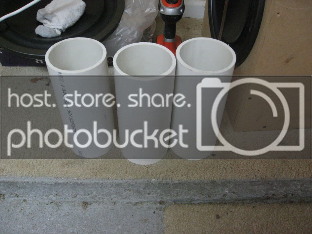

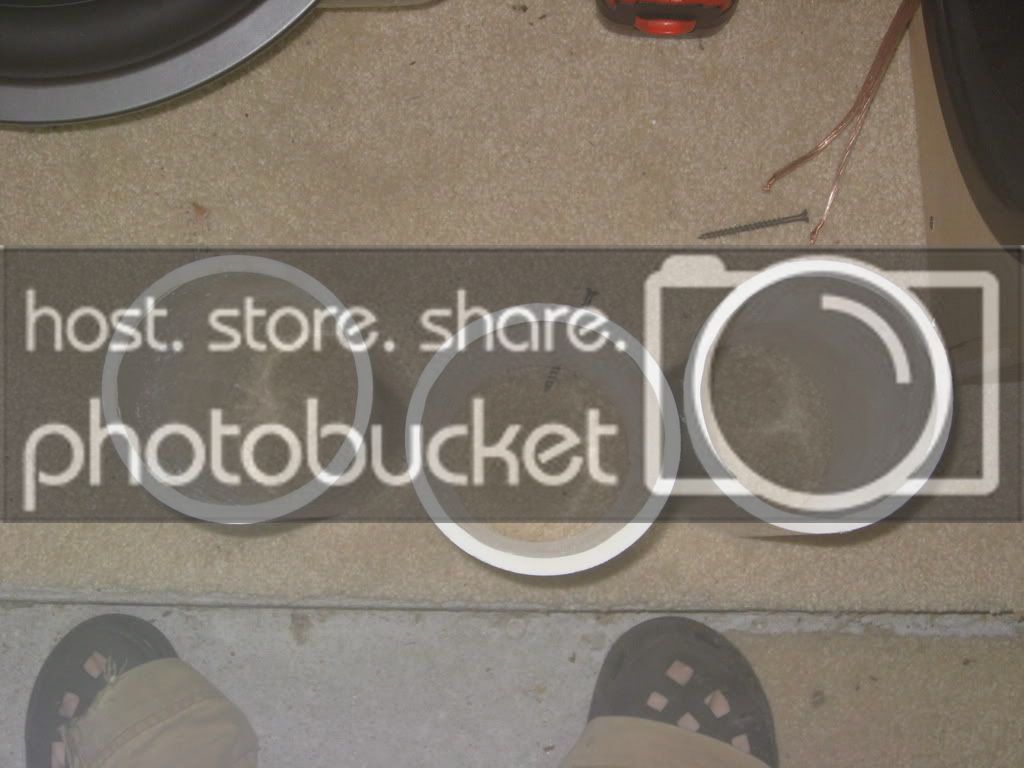

Pizzorts - 4" diameter, 10" long

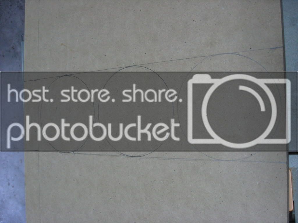

Where they're going

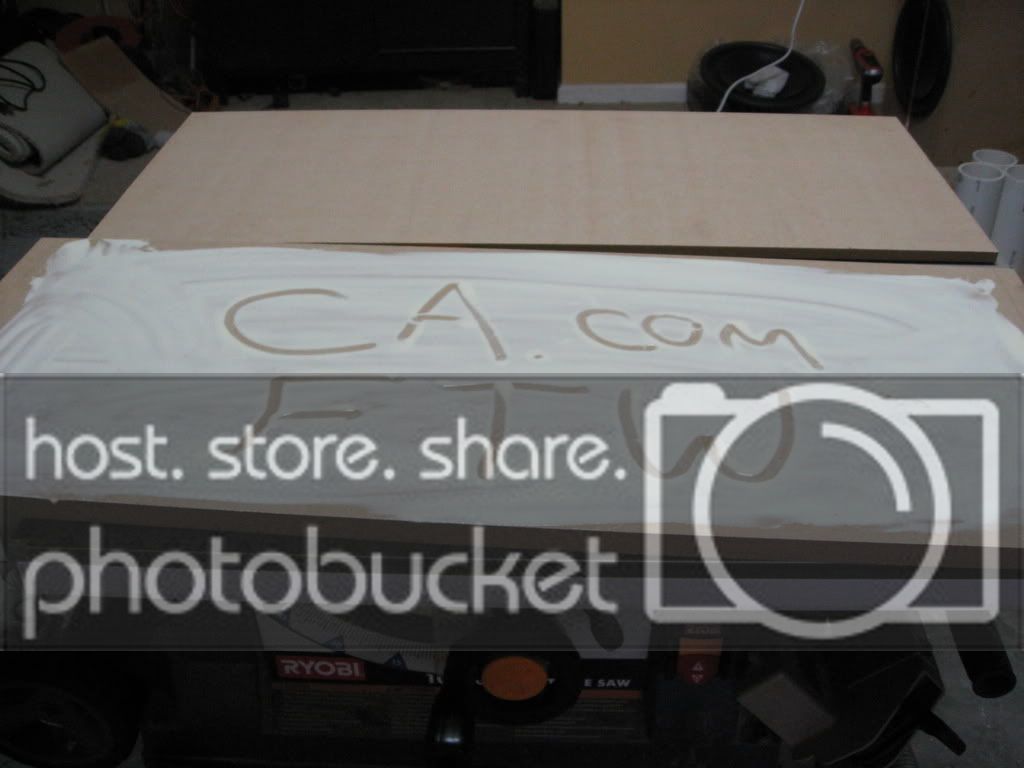

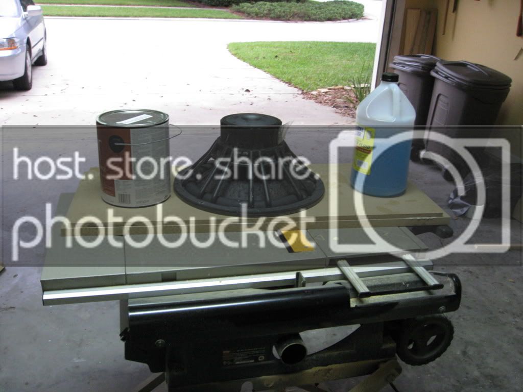

Need weight for that shit to dry
Doing a 1 1/4" Baffle... glued together a piece of 3/4" and a piece of 1/2"
