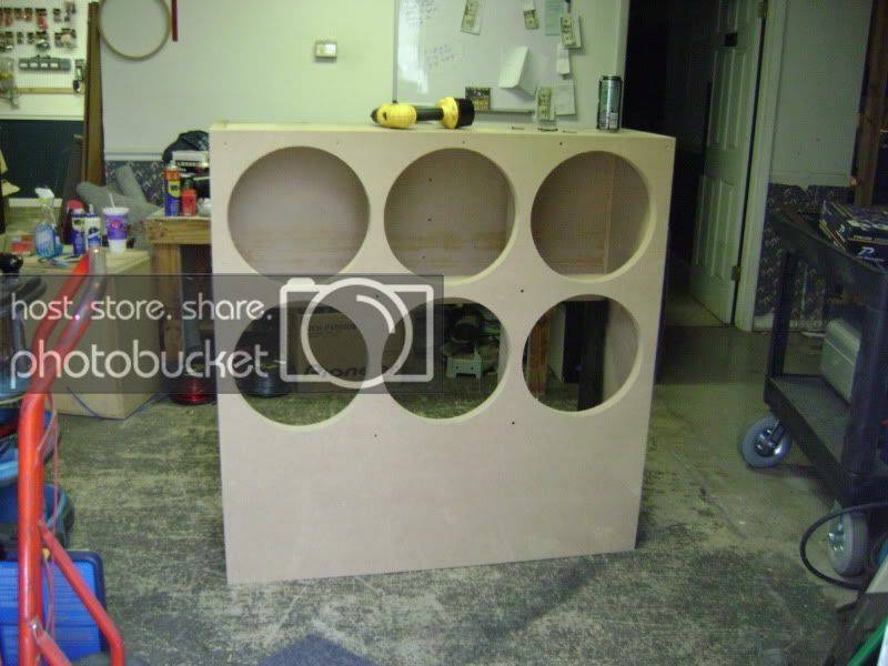

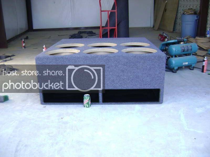

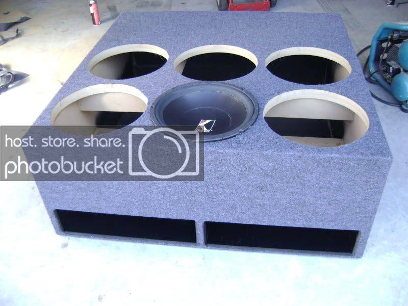

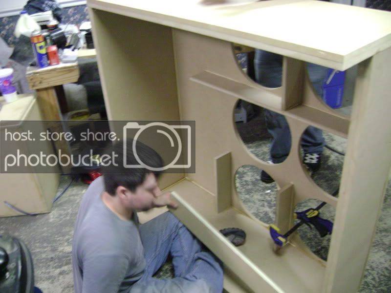

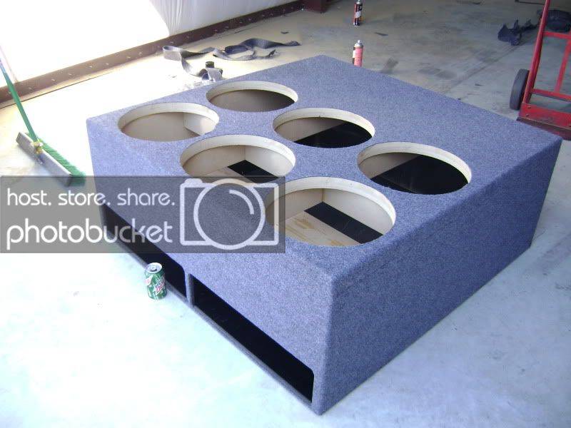

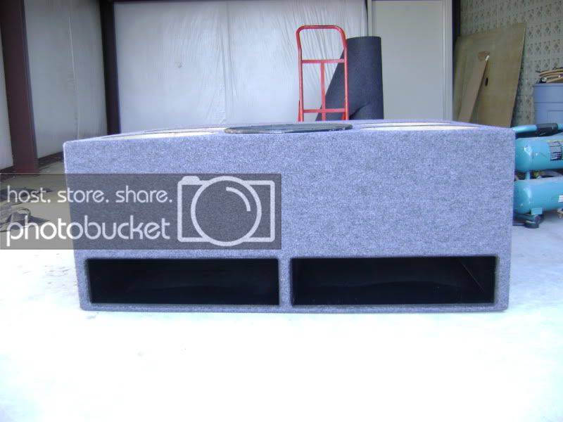

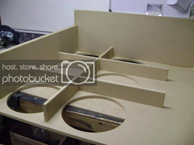

Had a guy show up w/ some old school Kicker "competition" subs. He wanted 6 of them in a ported box for his suburban, so to the table saw I went.

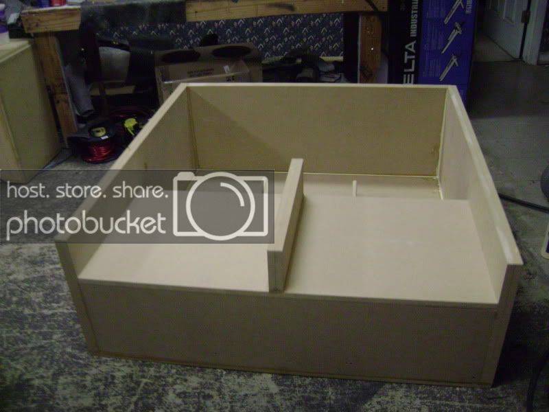

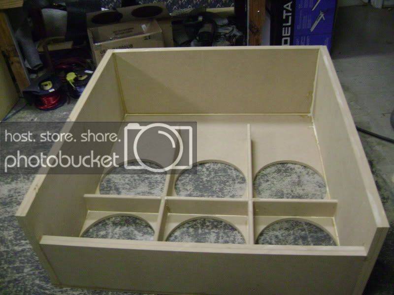

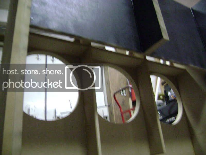

Every wall but the floor it 1.5" thick. 4" braces between sub.
18cuft 34hz. He is coming wednesday for the insall. Will have a MMATS 100hc powering them.

His old Kickers look like they are on their last legs. Don't think they will handle the MMATS 100hc very long, all of them sag pretty bad //content.invisioncic.com/y282845/emoticons/crap.gif.7f4dd41e3e9b23fbd170a1ee6f65cecc.gif
