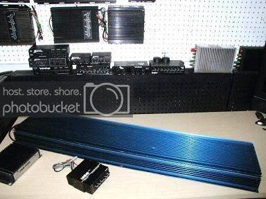

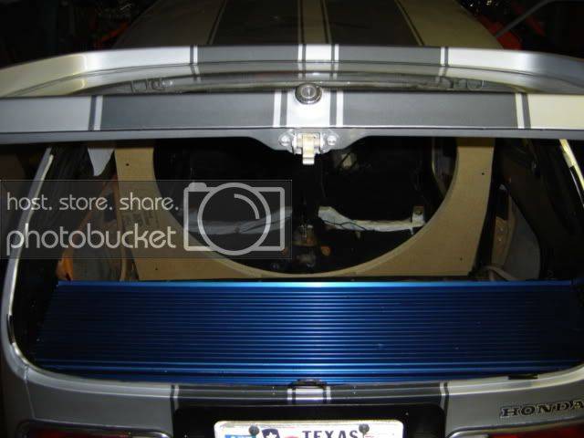

Next we have the amp power. I am going old-school amps in this. My first choice is about a dozen Zapco 151A amps for mids and highs, and a very-large Linear Power amp for the sub. (blue color amp in pics) . I tried a US Amps VLX-400, but it is very hard to fit into it. (45-inches long) . The 6/3 channel Linear Power amp is 42 inches long and I can barely fit it into the car. Still weighing options on using it or not. 3 possible ways to fit it in the car. Might go with something else.

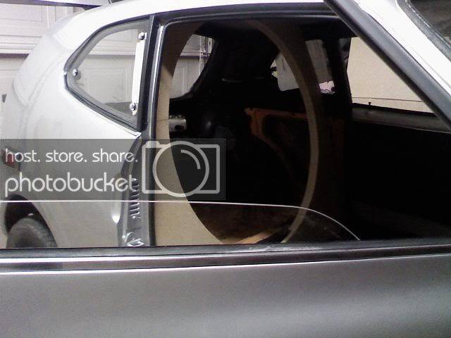

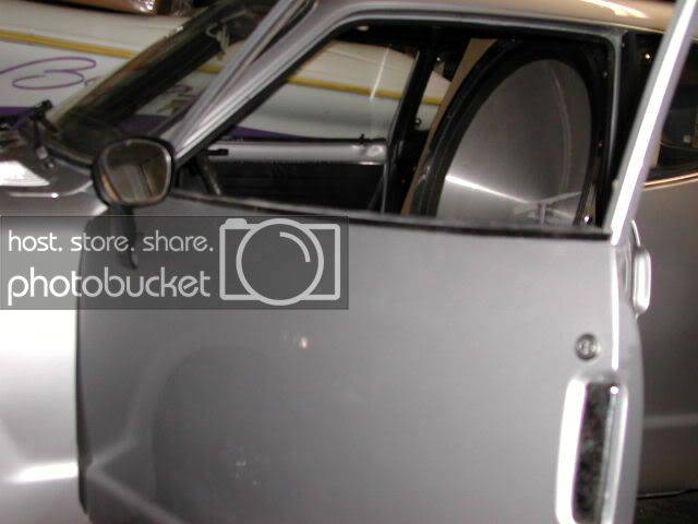

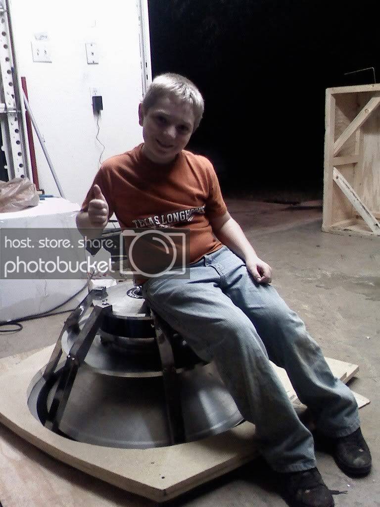

The sub is an Audiobahn AWT34X. (measures 36-inches, 211-lbs) ...I built a baffleboard and it took 3 of us to fit it into the car. (about an hour, and we were worn out afterwards) . Tried it in the baffle and it plays 5hz to 30hz fine. After that, it fizzles out. So I think that I am going to try to enclose it.

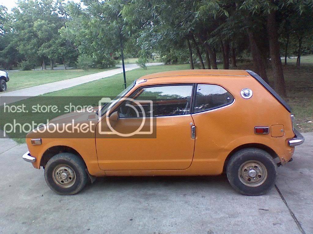

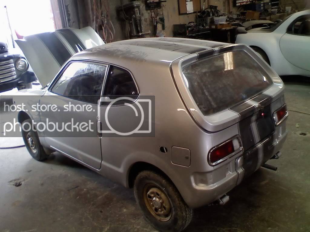

This is when I first got the car. Faded Orange.

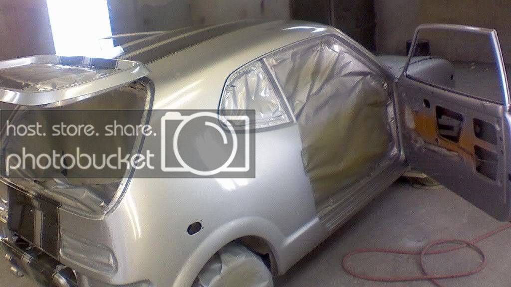

Bodywork done, getting paint...

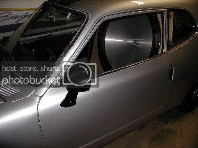

Now that the sub is in, I hooked up 2 Harrison Labs 800 amps to it. I tried it out at different frequencies. 5hz to 30hz sounds great. After that, it will move, but will take a lot of power to move it properly. So, I am going to enclose it and try to get the frequency to go higher. Airspace is going to be hard to get, and a very difficult box to build. That is where I am at on it now. LIMBO... Will get back to it soon.
I have been playing it without the car running using a big battery charger and one battery. (poor battery) The engine is about to jump out of the car at 15hz. Funny... Will get a video of that soon...
