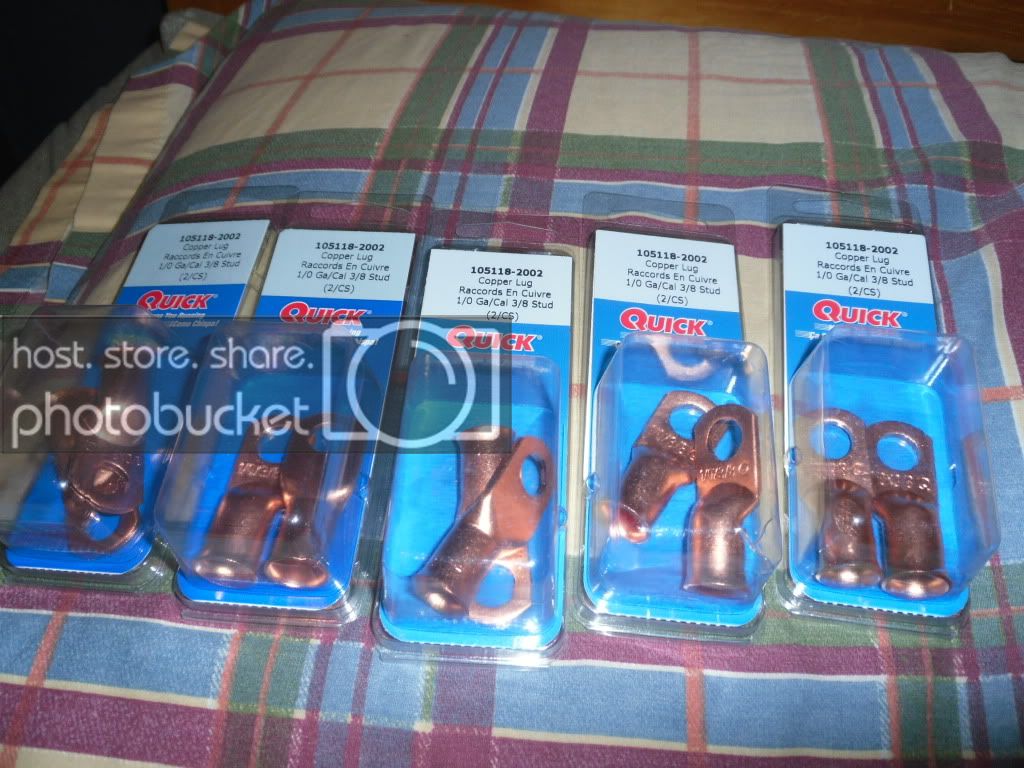

got some 1/0 ring terminals today, should come in handy. Not sure if I got enough, or too little .. we'll see I guess.

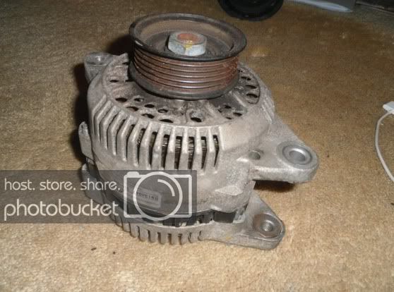

I got this alt laying around, its oem for my car, used .. I was thinking of getting it rebuilt, friend of mine has a scort and had his rebuilt by a guy an hour or so away from me for no more then 200$ max and got 152A out of it. So this is a possibility.

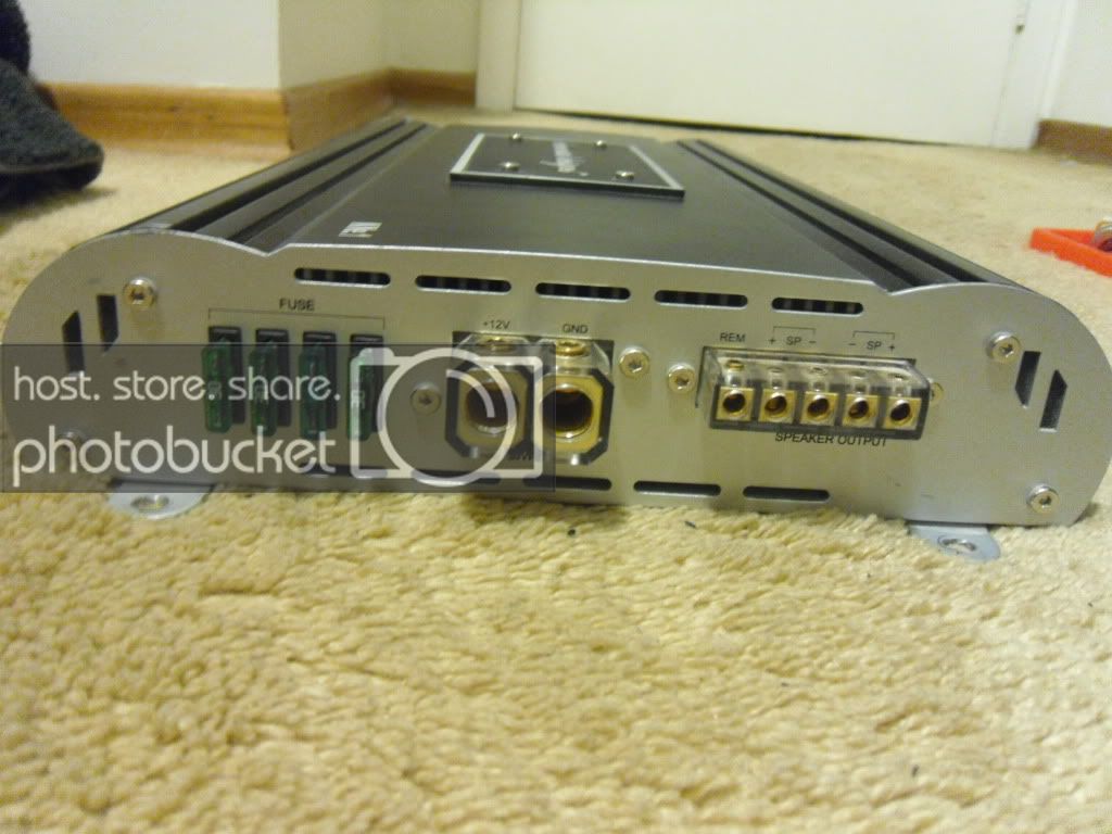

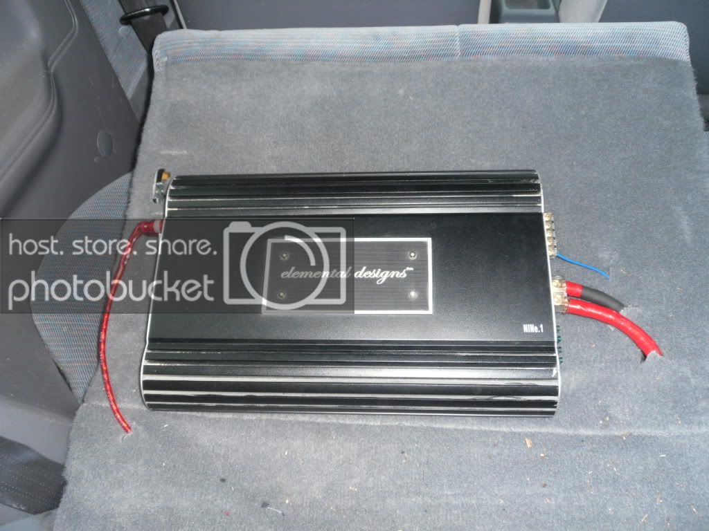

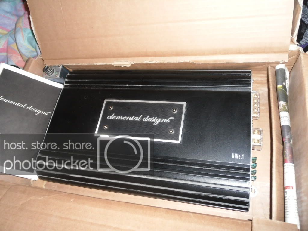

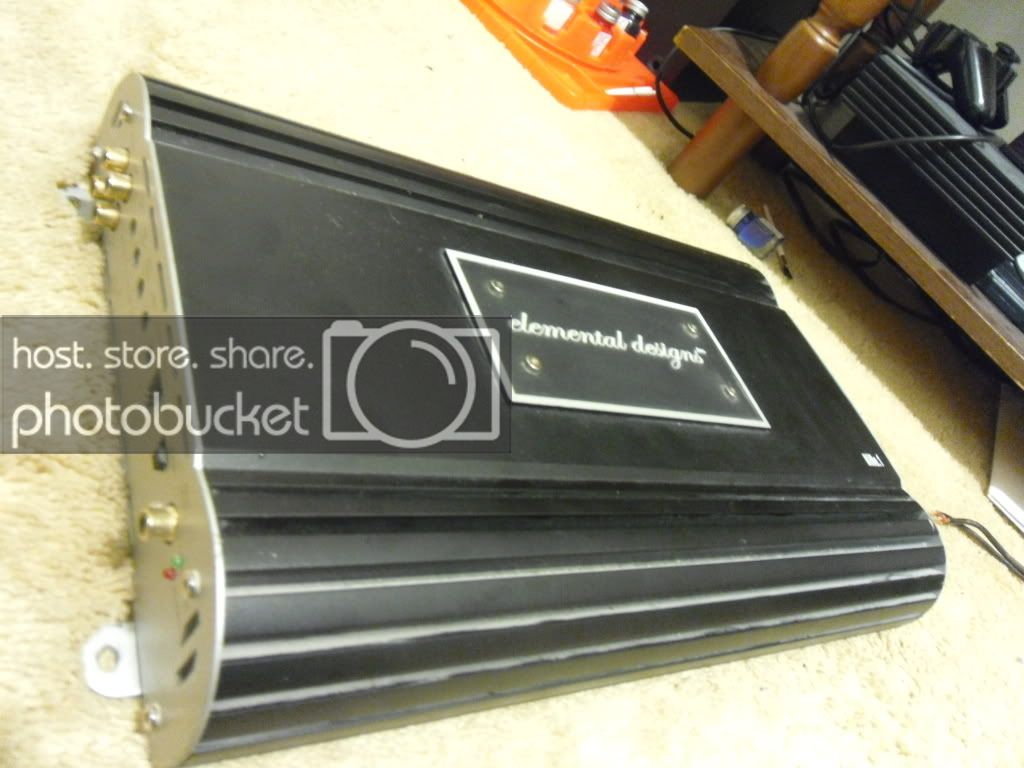

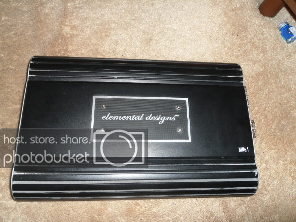

Got the amp today, for those who are excited to know what it is!
Elemental Designs NINe.1 - rated @ 12v - 1200WRMS @ 1 ohm, 700wrms @ 2 ohm, and I was told its .5 ohm stable and strappable.

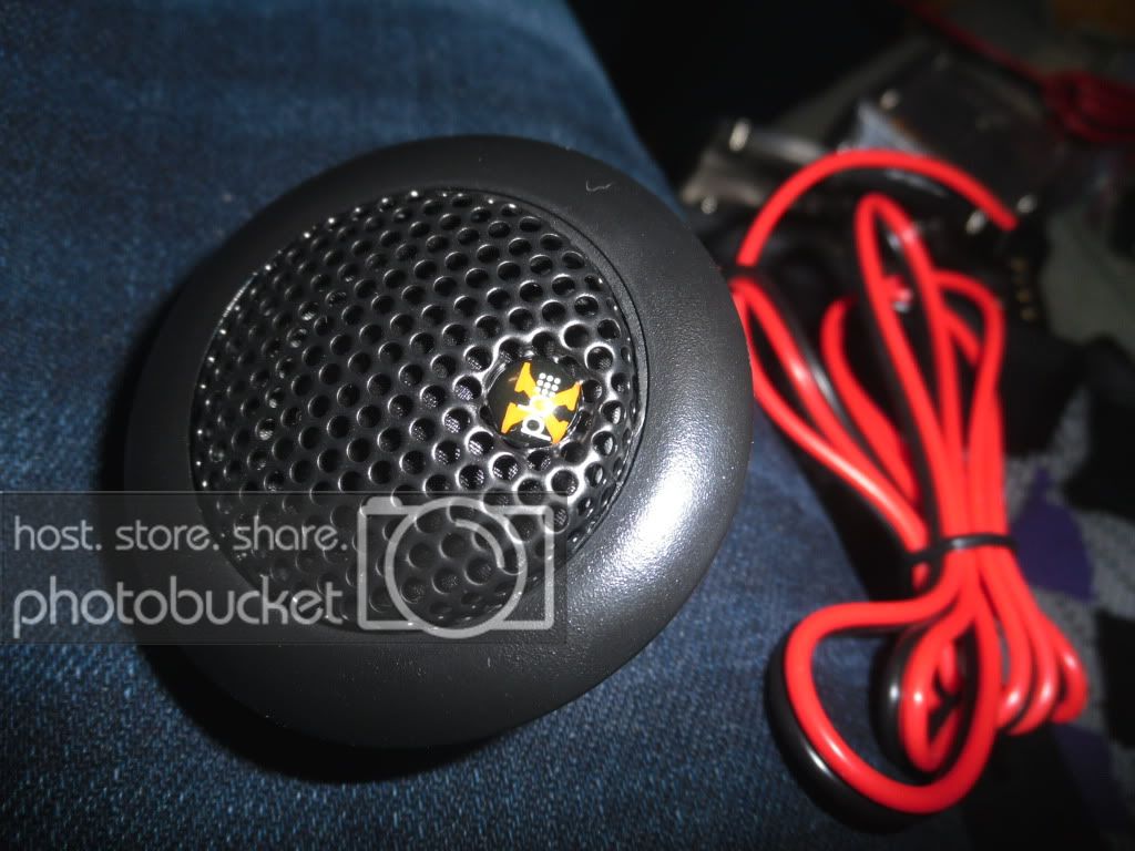

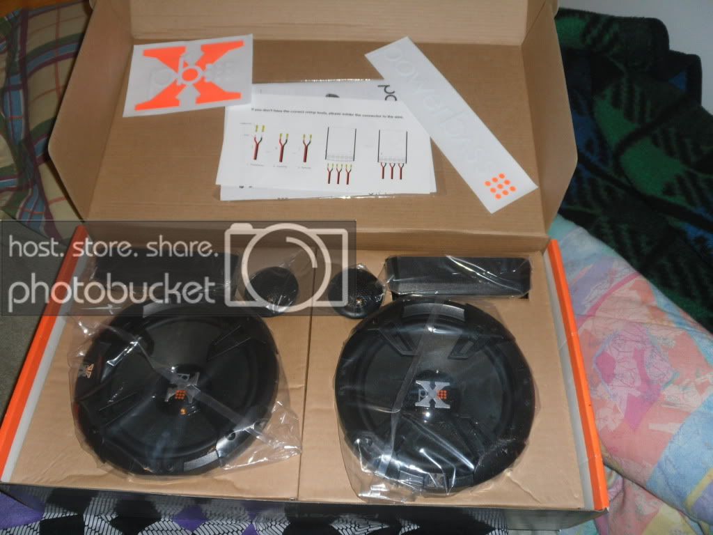

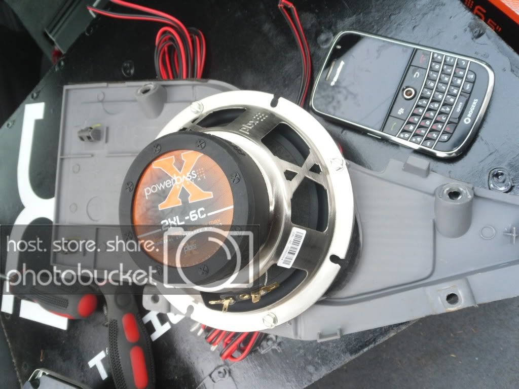

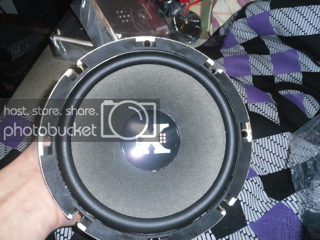

got a set of 6 1/2" powerbass 2XL components for the rear, got a good price on em so I figured I'd run em! now I need a 4 channel

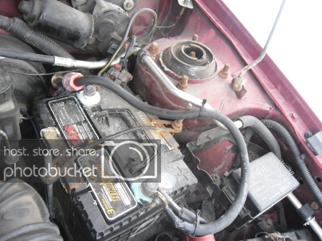

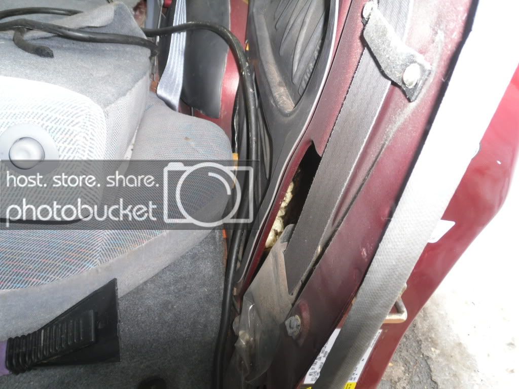

got the 1/0 ran from batt to the trunk today as well

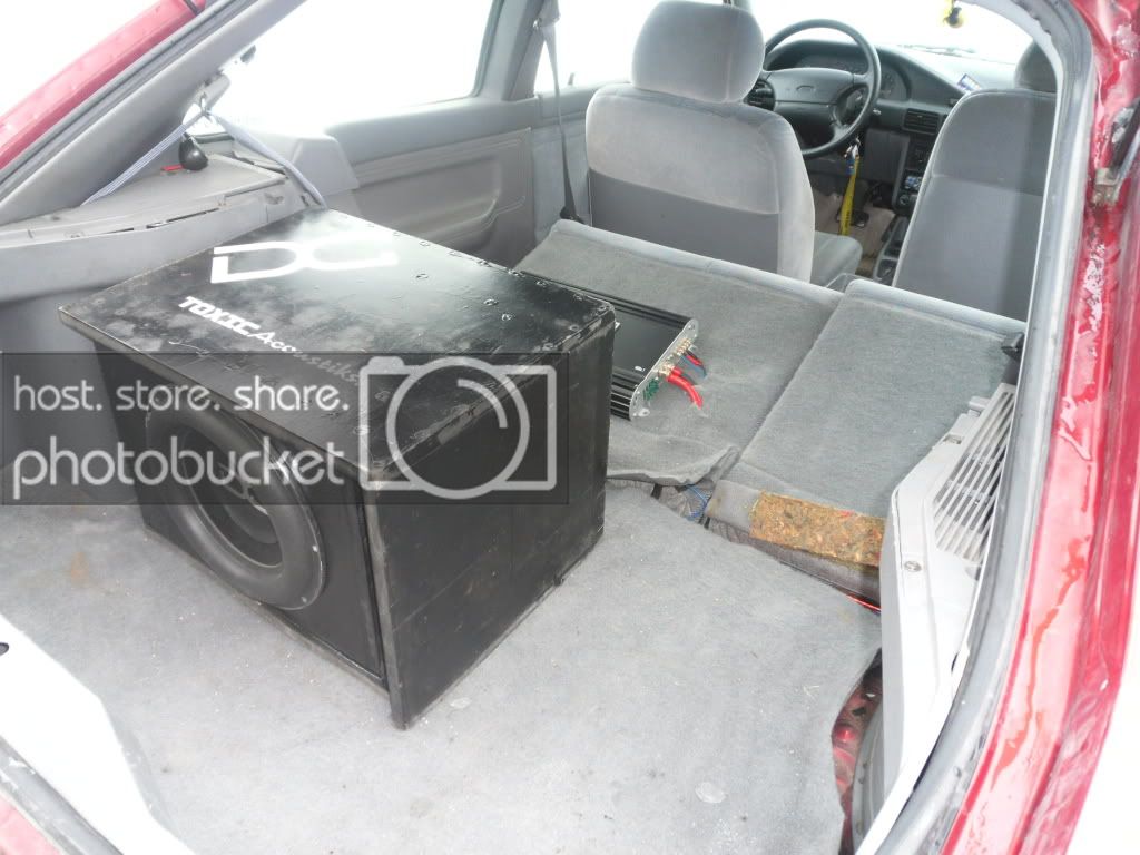

got the amp mounted to the seat
anl fuse, and fuse holder installed, need to get the bigger batterys soon, waiting on a couple sterlings

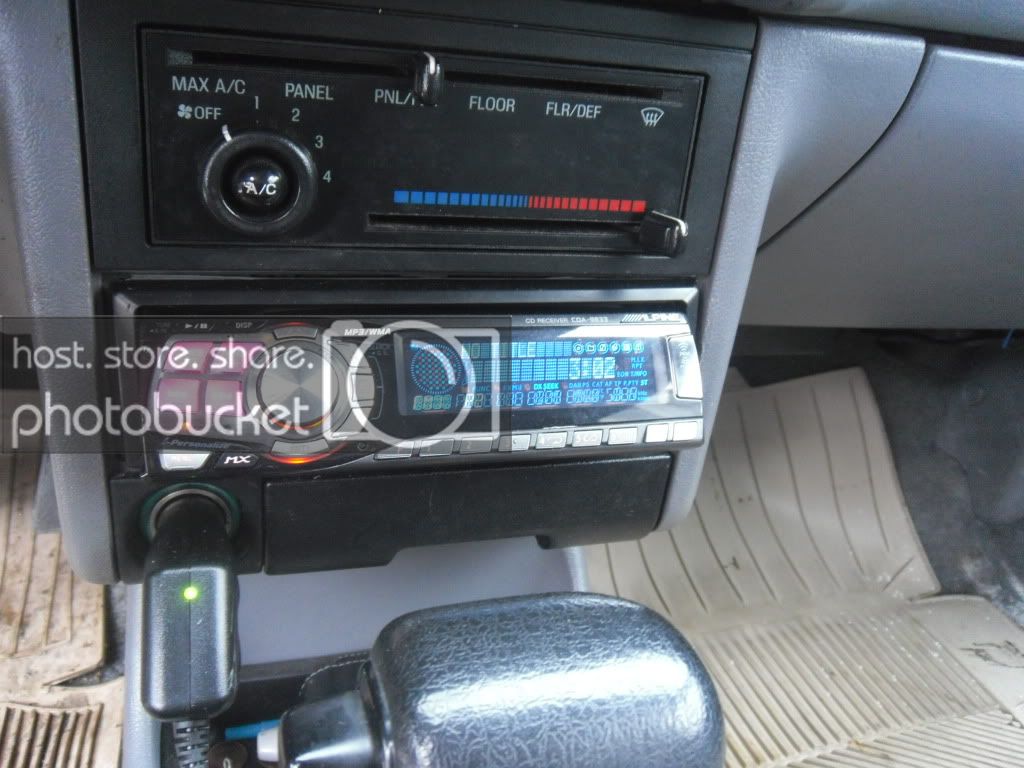

alpine cda-9833
I have morels up front, I want to try those, these powerbass comps are too big to fit in my doors anway don't feel like making temp plates and makin em work, if I really like them I'm going to get a set for up front (which I most likely will do haha)

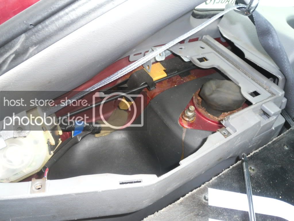

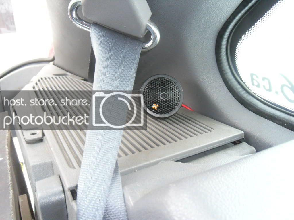

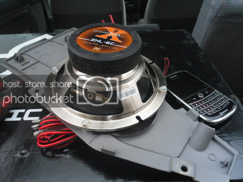

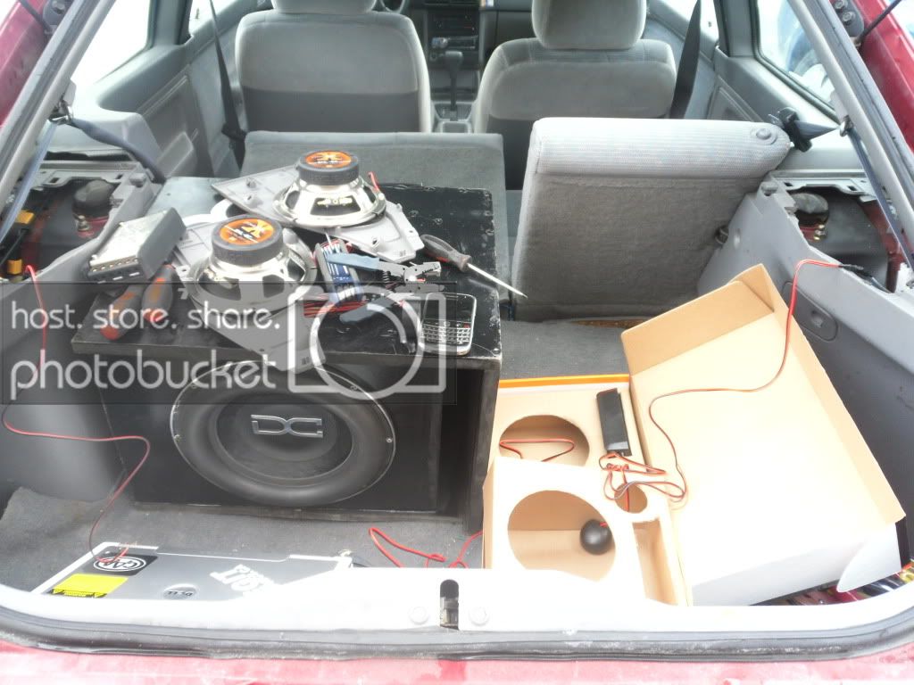

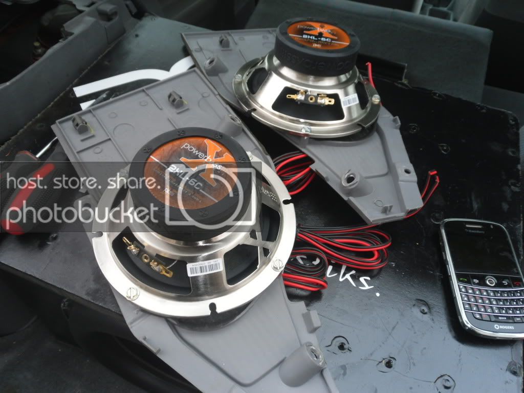

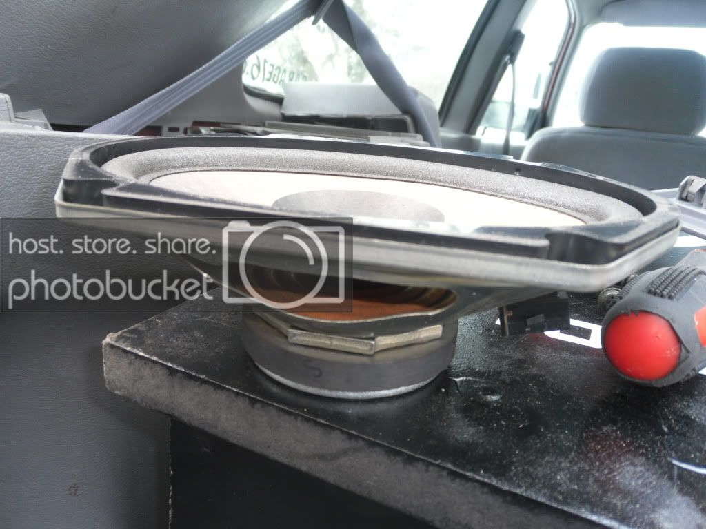

got the rears in today, maybe next weekend if the weather is nice again I'll do the fronts, heres pics of todays progress
stock rear speakers, 5x7

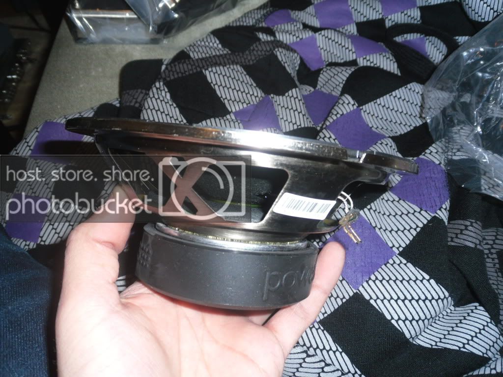

the 6 1/2" powerbass 2XL mids barely fit in the stock location
tweeters mounted, the rear speaker cover wasnt screwed in yet
trunk as of now, box is temp
