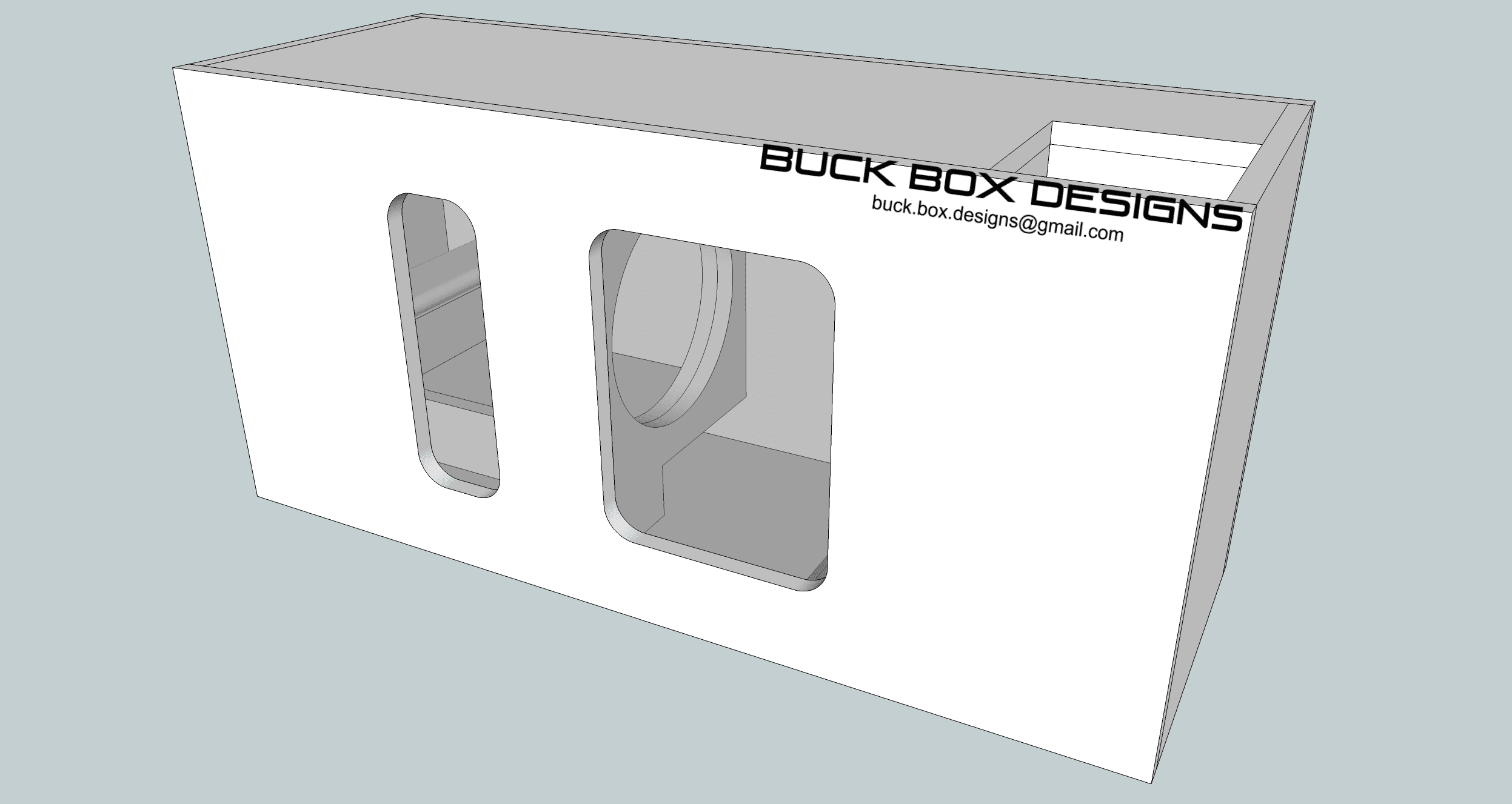

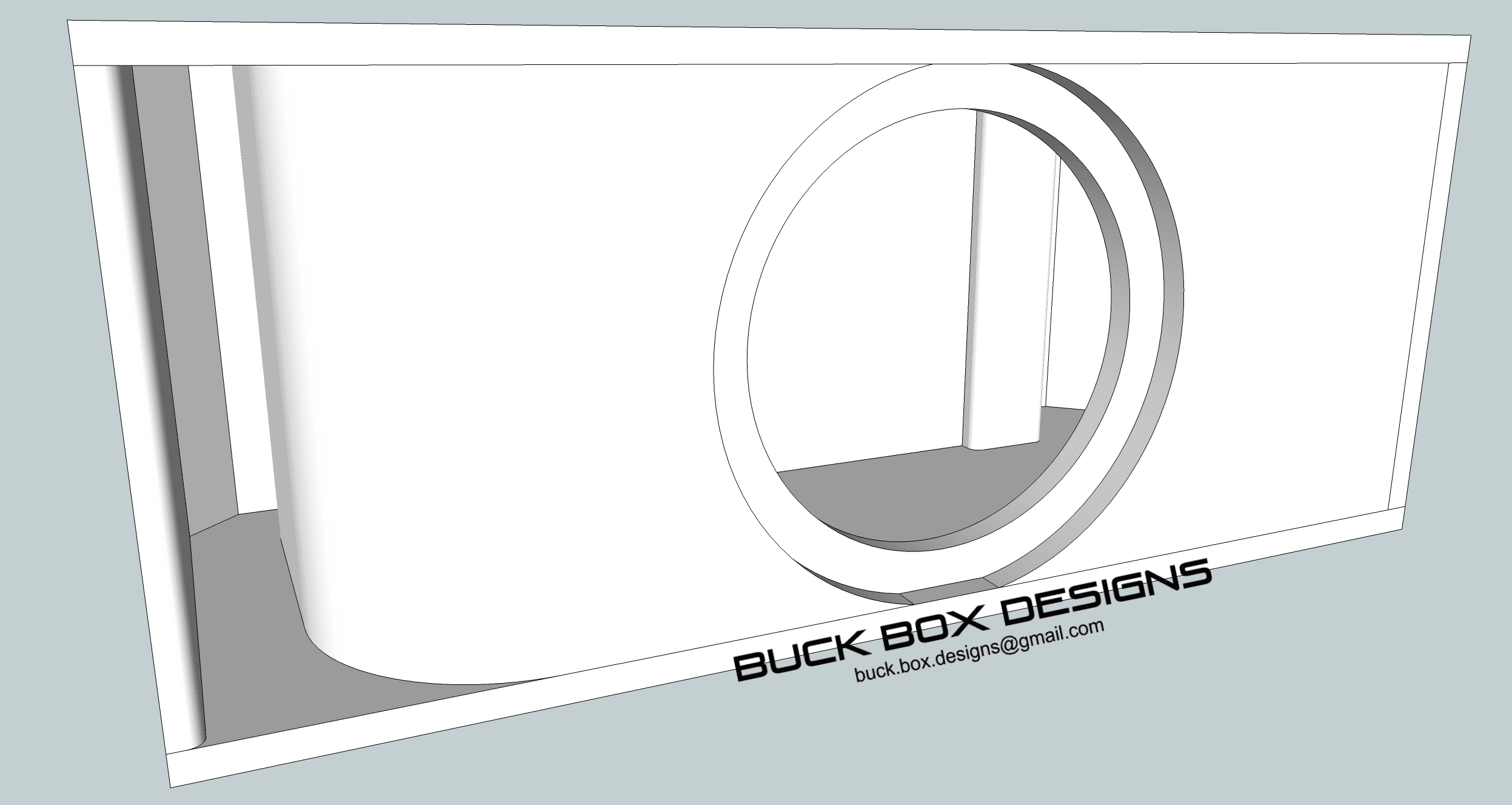

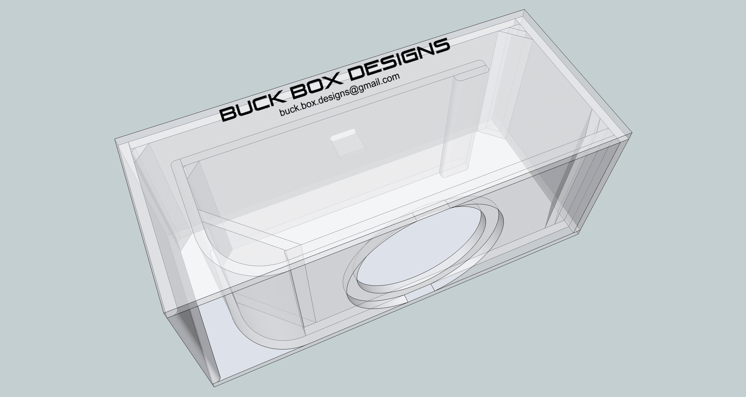

Theorizing if this would work for a home audio t-line setup for a 15. This one is modeled for a Fi IB3 15, tuned for Fs.
