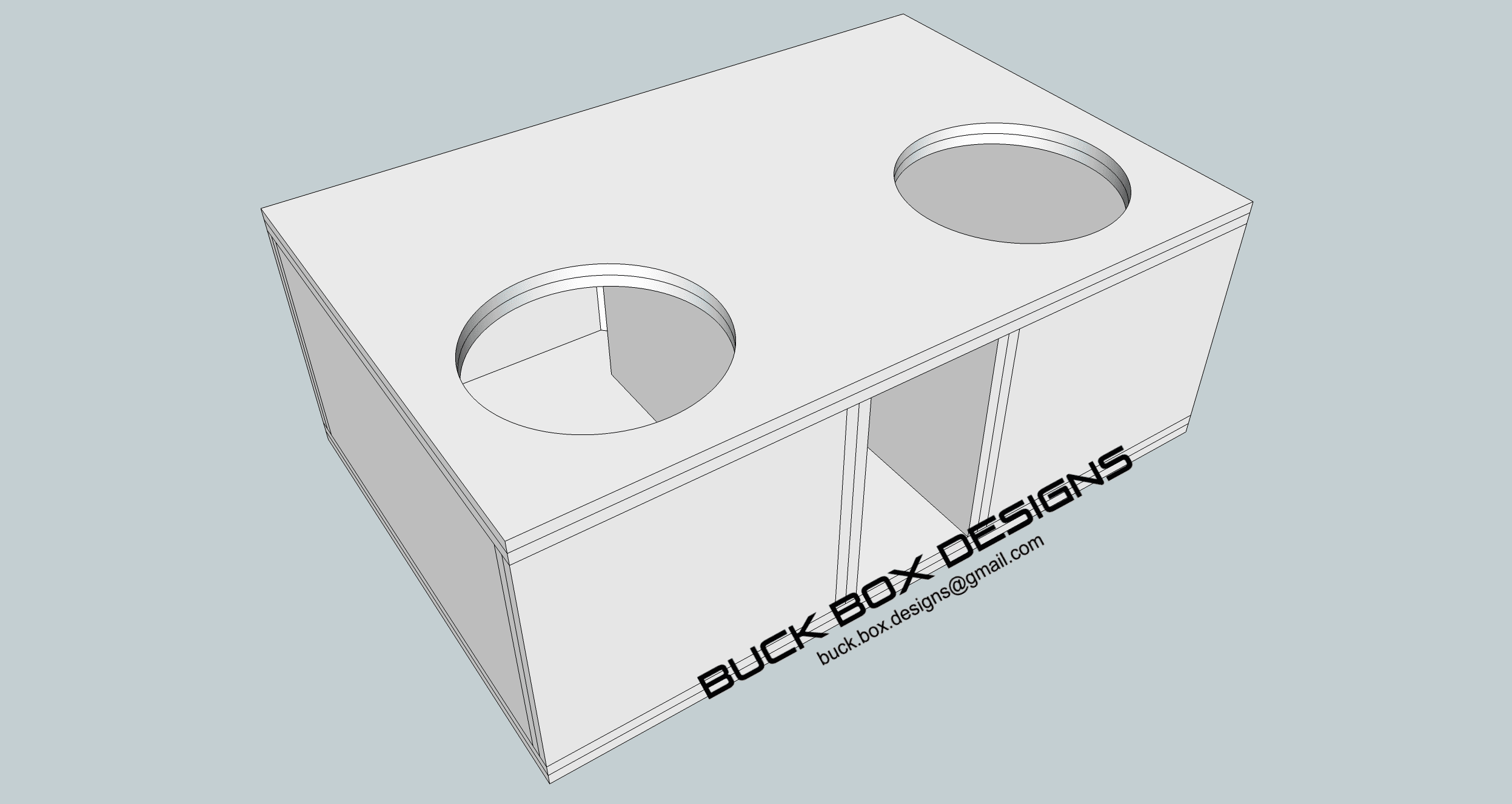

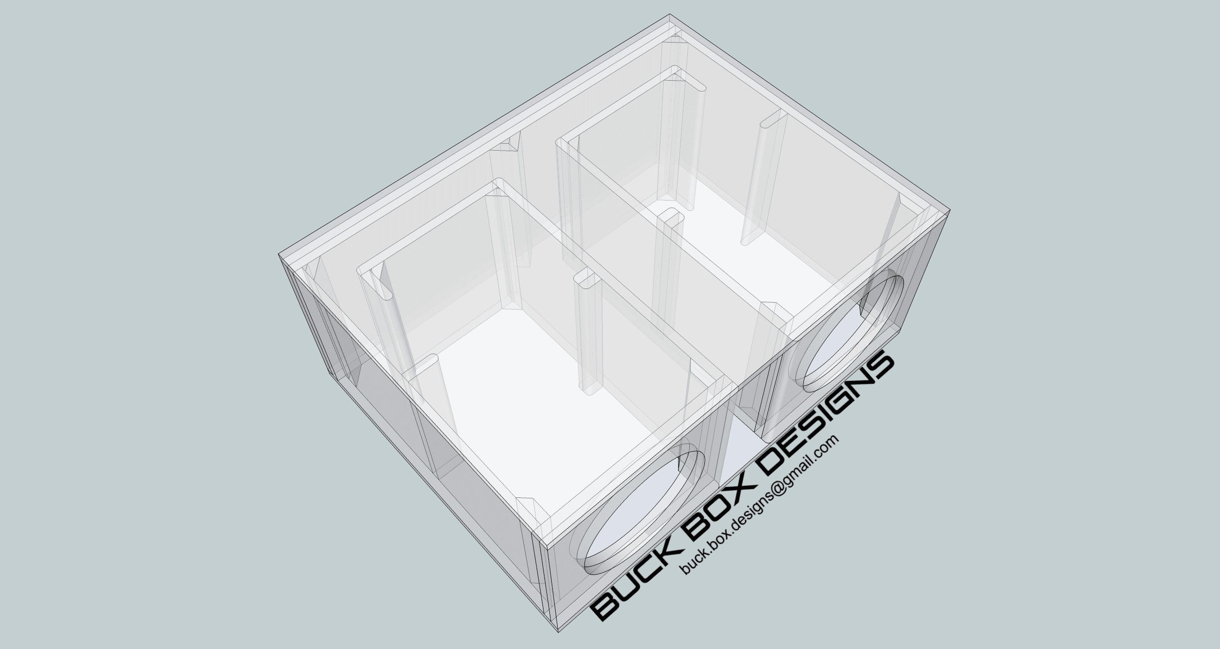

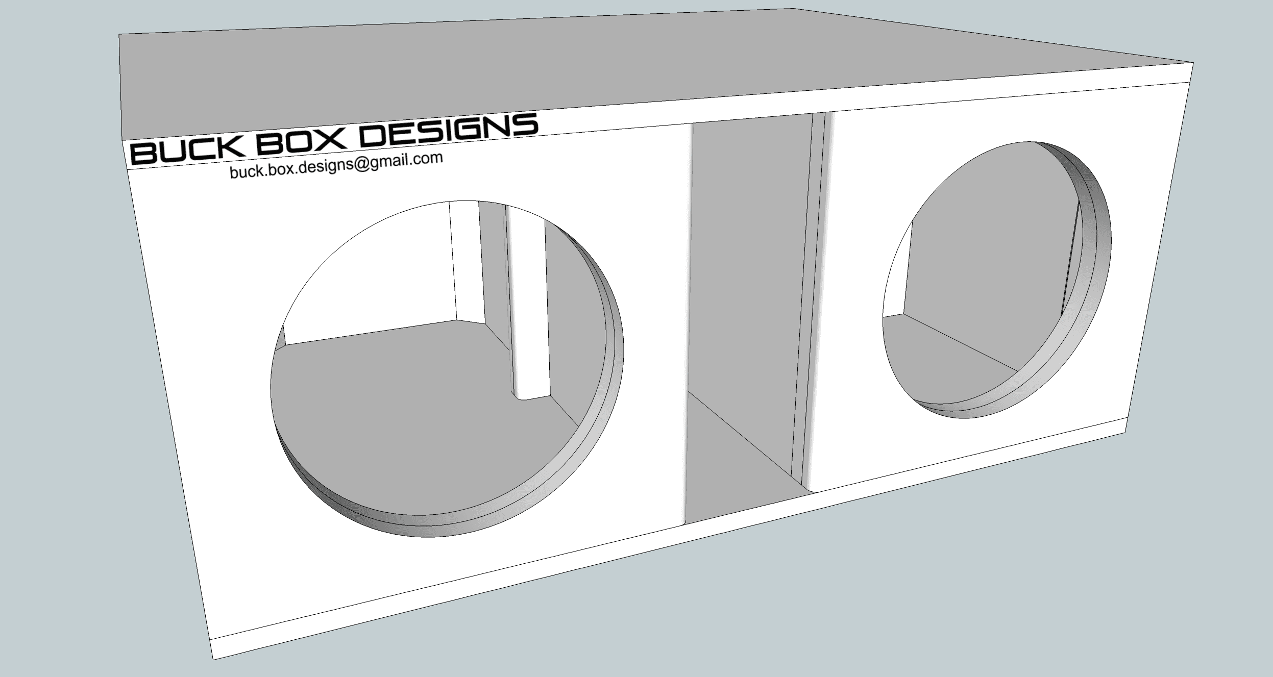

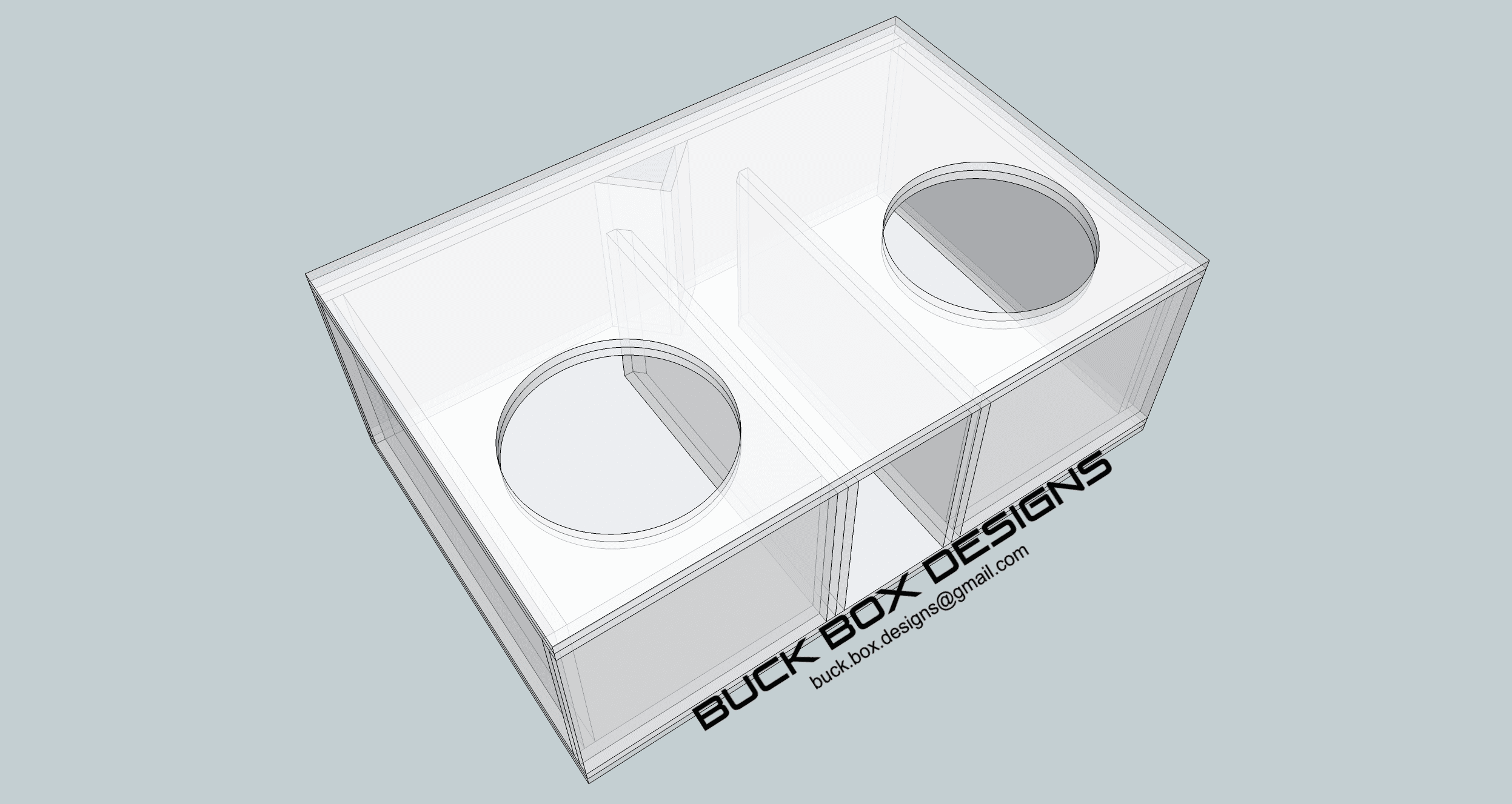

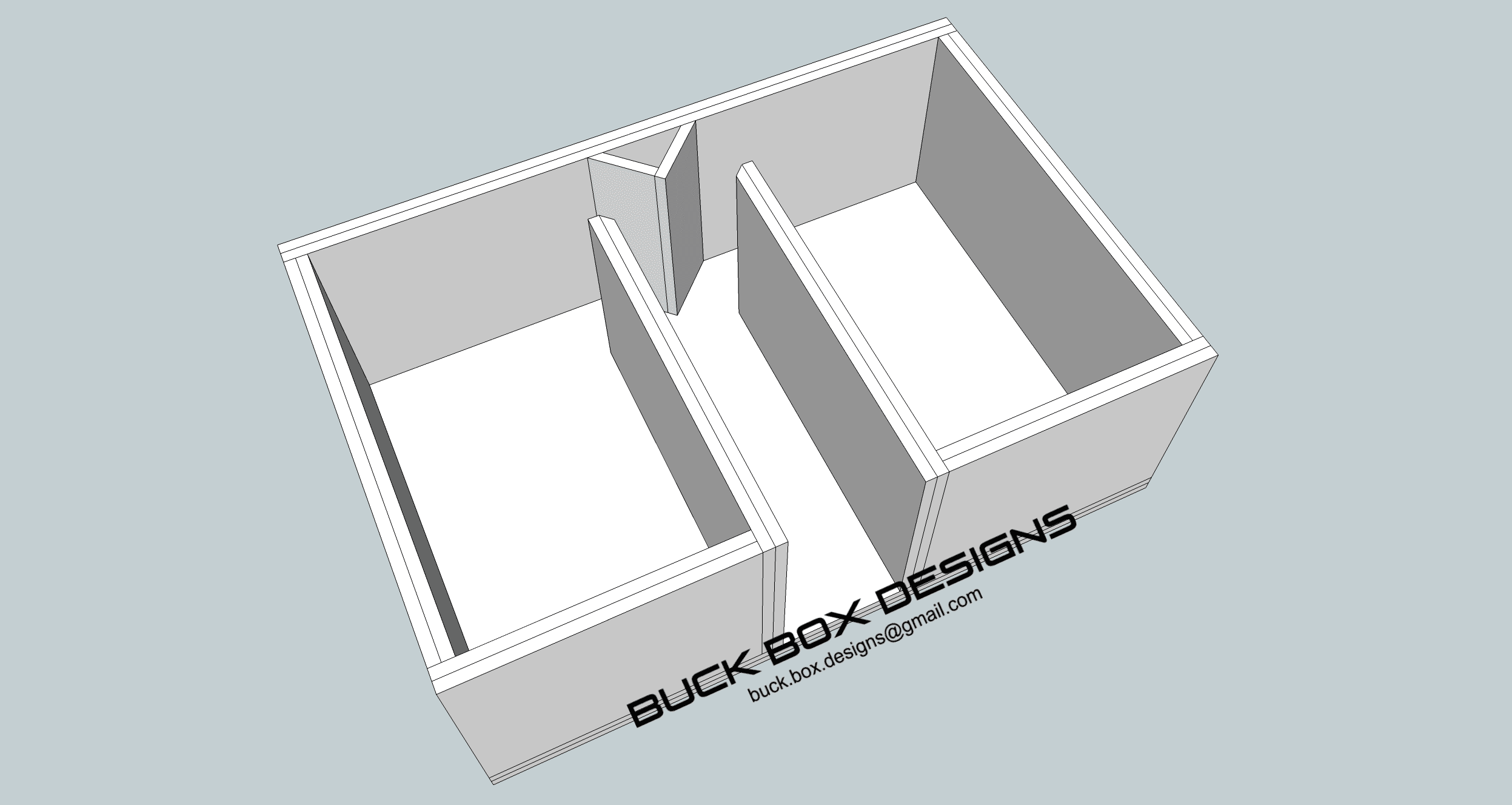

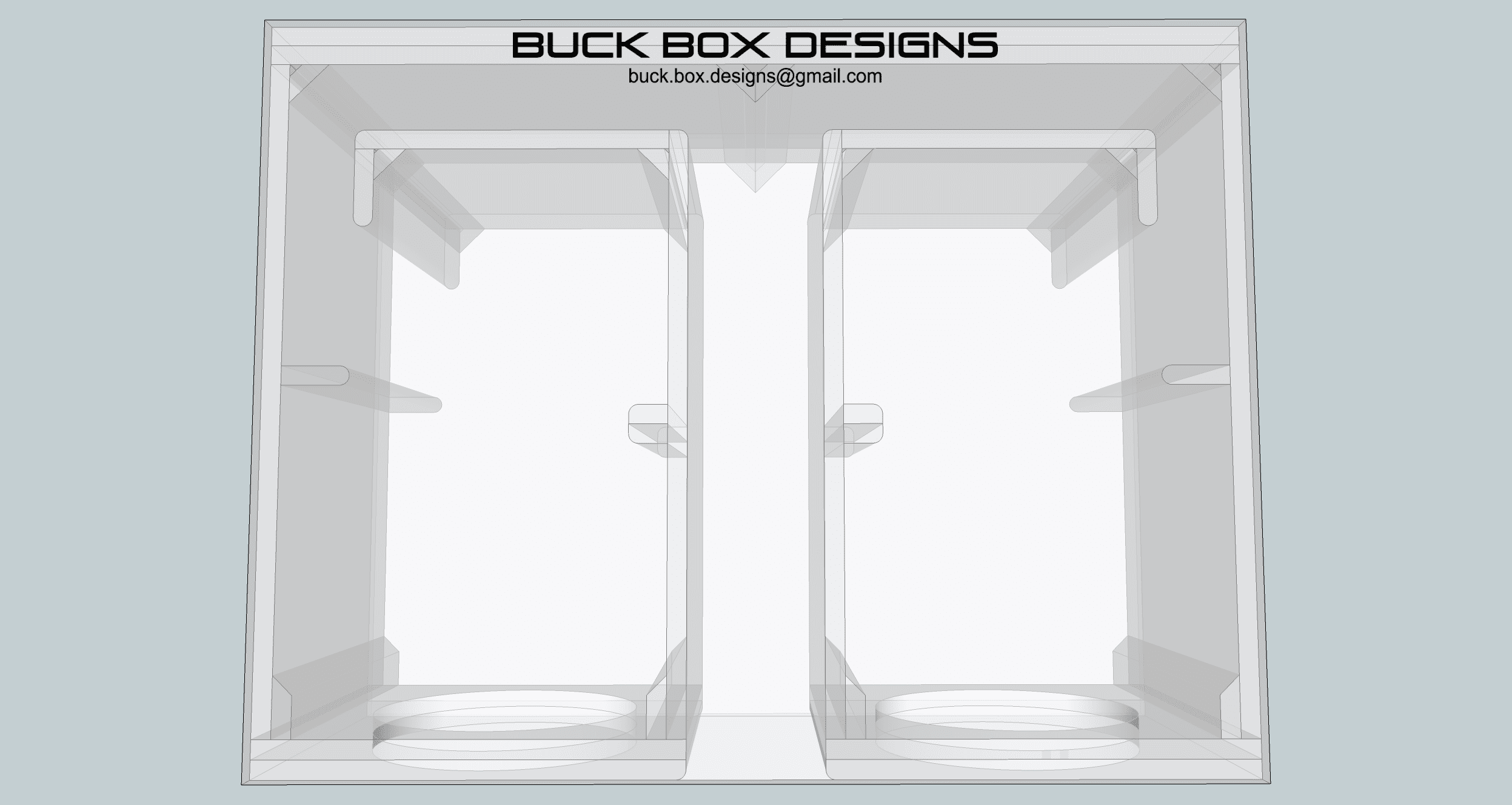

2 Skar ZVXv2 15's ported in a big SUV
26922
26923
26924
All that port area. What's the tuning?
Big port area means more peak around tuning frequency, in exchange for tad more sloppy sound the farther away from tuning you get, Correct?
you can fit a straight port in there?
It's about 32 hz. It's a larger port but not too large, not overly large. That port isn't straight, it's actually turns.
Some designs are the way they are from requests by whoever is going to own the box. Different people have different tastes, so I design to what they want, to the best of my ability and within the limits of the equipment and space.
How do you decide when to put 45's in the corners?
There's a variety of factors. Sometimes they're used for strength and trying to help some with standing waves in corners or helping the port air flow through a corner. Sometimes they're used to literally take up space, for legitimate reasons. And sometimes they're used to make a port longer.
Some people just want them in their box. Some people can't cut 45's, so I'm not able to do it. Like sometimes 45's can't fit in some corners, but they're still wanted where they can fit.
I do what people want and/or what I think is best, it just depends.
