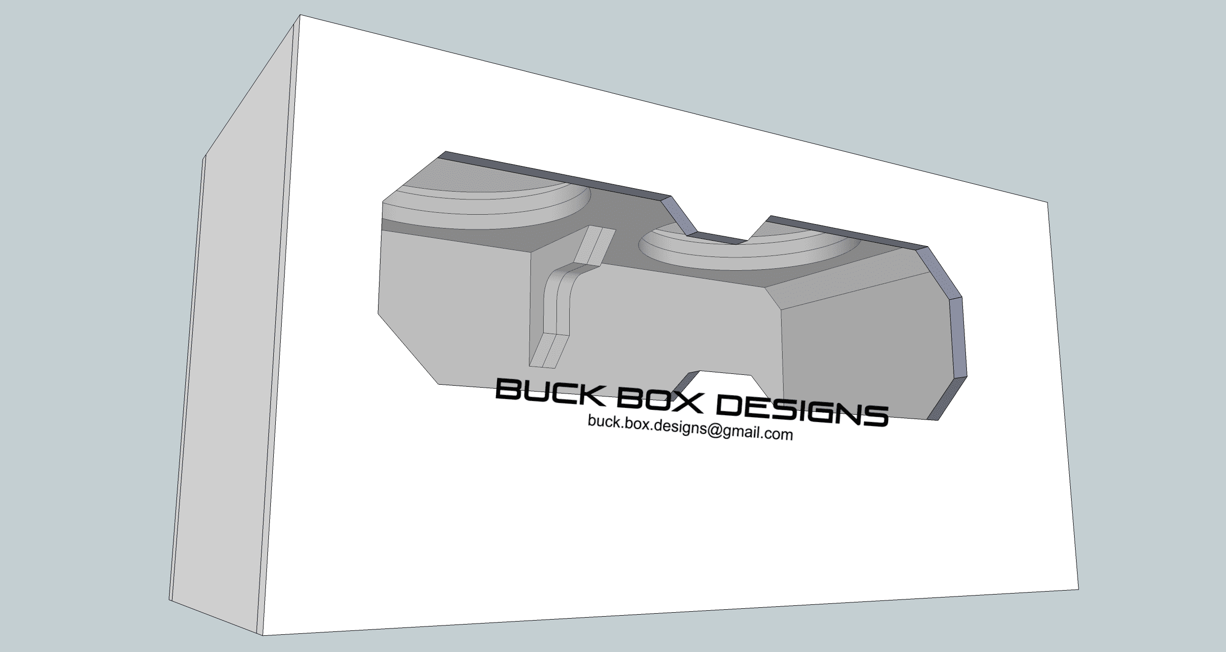

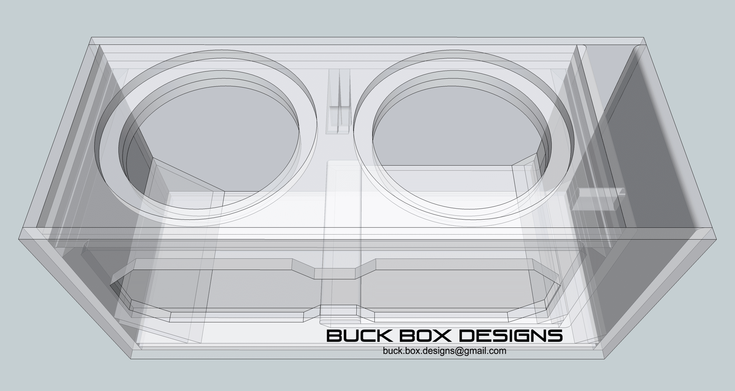

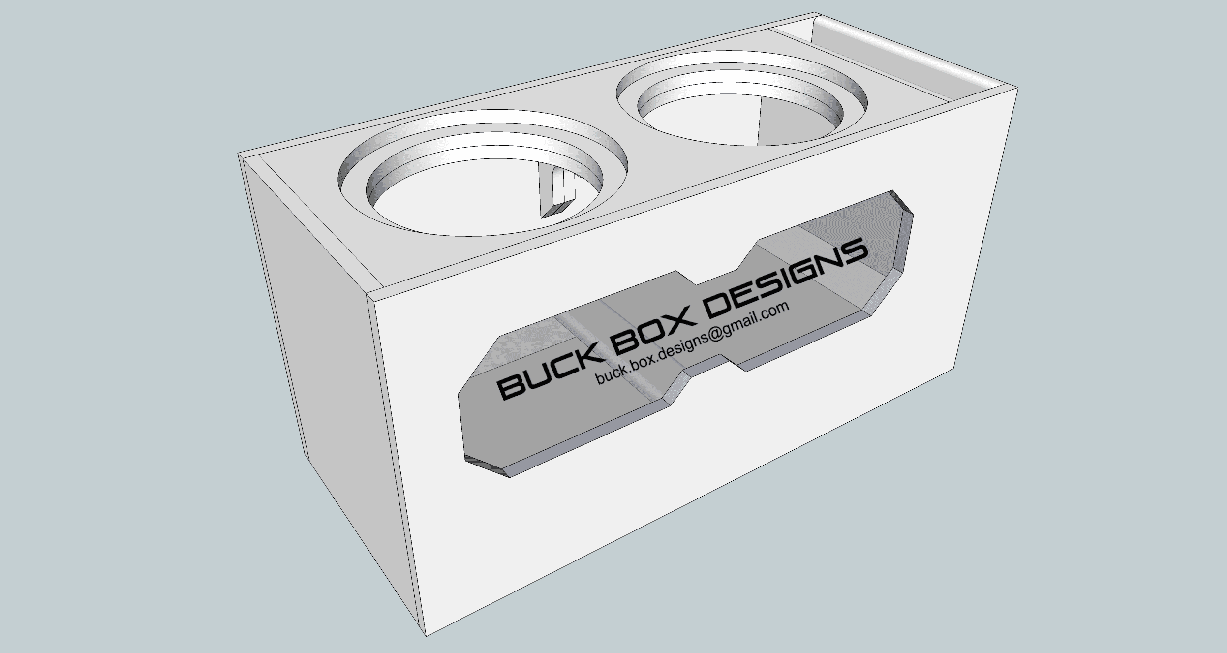

2 DC XL Elite 12's ported in a small SUV with a good looking Lexan window.
