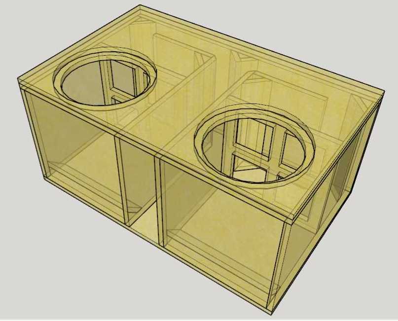

It is a Skarfab...4cf. That's before .3cf speaker displacement for two DDX's. Is that 4.95ft3 before putting the speakers and port in?
This box?
I'm not sure it's TOO small, to the point it would cause mechanical problems. How big is the port though? It looks way undersized -- and too long if it's as small as it looks. Maybe 2" x 12.5? Does it go to the back of the box and turn back a couple more inches?
Maybe I'm just seeing the photos wrong :unsure:
