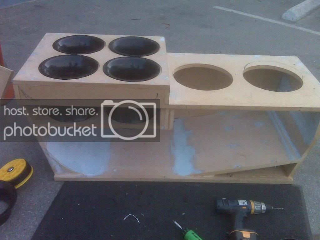

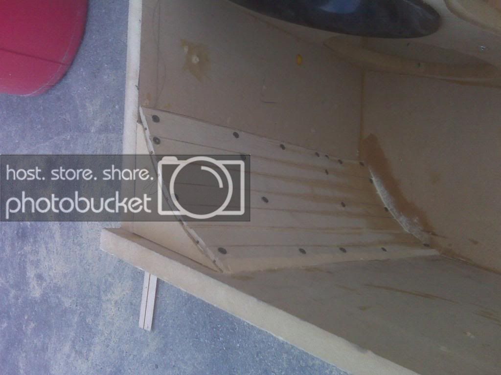

mylows10 5,000+ posts B2,singer,ampere rep 22,678 76 monterey , ca Aug 21, 2012 #18 woofer forward and port forward ,external .the trick is to direct the air flow from the back side of the woofer in to the port .45's are just angles inside the box to do this and a whammy is a larger version of a 45. like these
