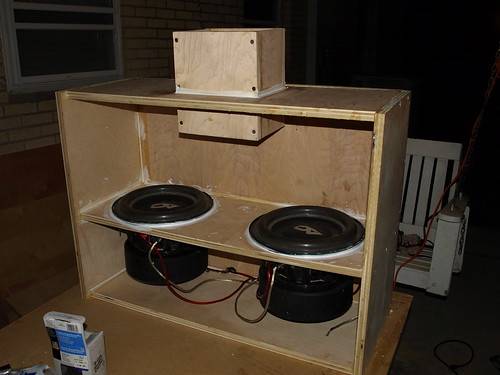

Just like this but you seal off any sound wave from entering back into the trunk with foam, blankets or whatever else you have laying around.

Doesnt matter what you do to the back of the box with the wall as long as the front where the port and subs are sealed off from the trunk. If you are talking about sealing off the back of the box. No that wont work, you need to seal from the front. It has to be sealed tight enough so that no sound wave can come back into the trunk which is wasted output. Main idea here is that everything needs to be directed towards the cabin without allowing any sound from going back into the trunk.
