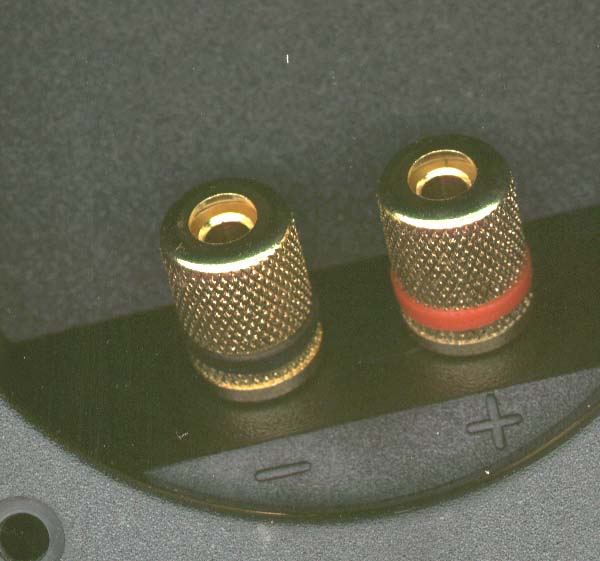

wiring the sub, do i wire the sub then drill holes for the wire to pass through? Or do i need to mount a terminal outside?

4-a terminal is always the best idea, if not, just make the wires comes out from the port //content.invisioncic.com/y282845/emoticons/wink.gif.608e3ea05f1a9f98611af0861652f8fb.gif.
