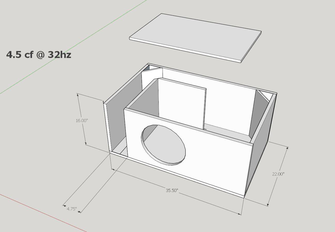

Here's a design for ya. It's using your exact max diminsions and I could squeeze 68" of port area with a 4.75" wide port at 32hz. This particular design is lower because of the way I designed the braces but that's all up to you
Port length was calculated to be around 33" via Winisd so I modeled it around that.
Not too shabby! However, those port pieces with the angle cuts that touch each other has me concerned. Maybe throw in a 3rd piece in between to "strengen up" the area, make it look more professional looking, if you will? Hope this makes sense. I have seen angle to angle to form a flat at the corners of the port opening.
Nice!... I'm tryin to learn sketchup as well... can you make that same volume/ port area/ tuning with a port/sub up configuration?
