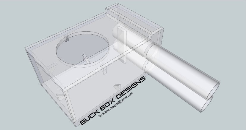

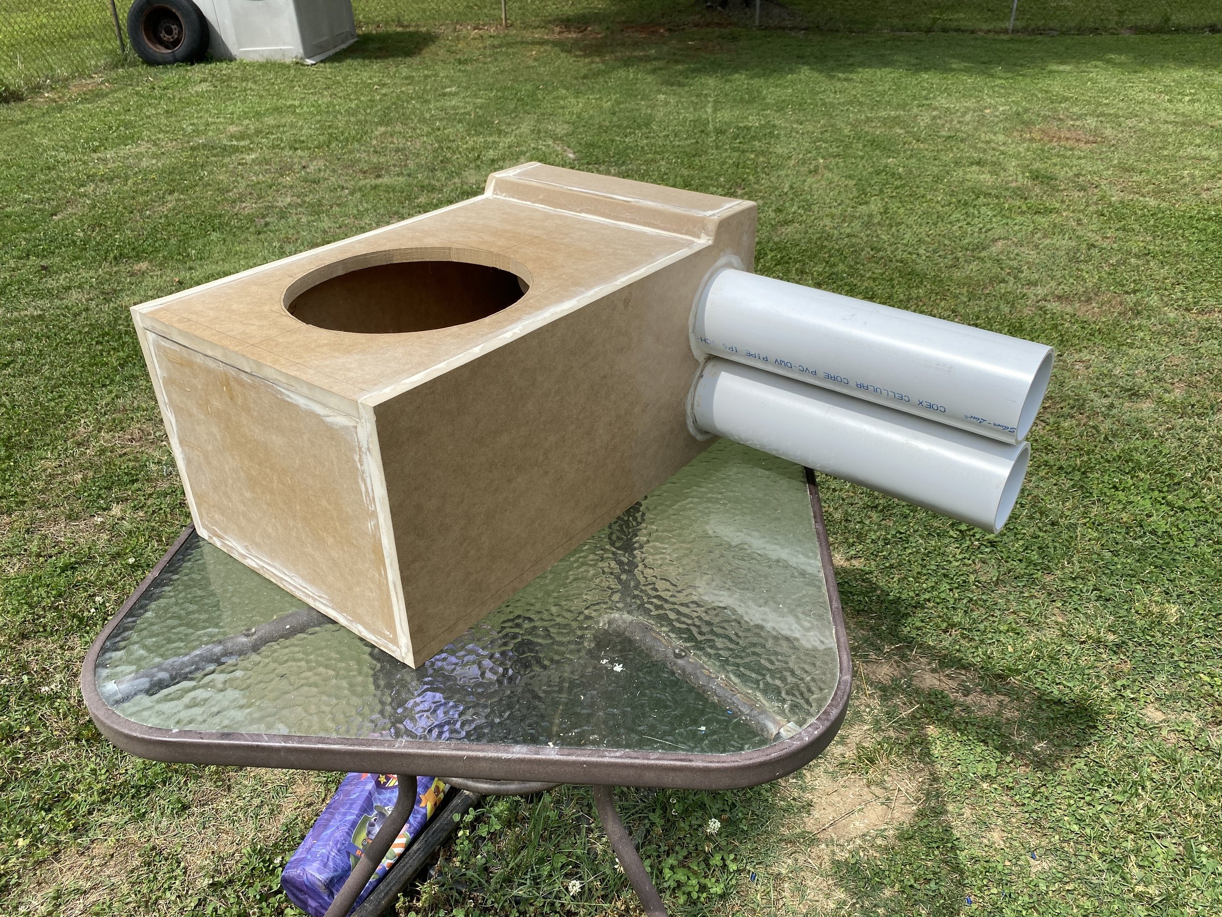

@Buck hooked me up with a design and I’m currently in the process of building it. Along with a box for my Adire Audio kh501’s. Anyways, box is 1.8@35hz net.
Didn’t snap many pics but I’ll share more once the box is finished. Center console in ‘96 f150
Hey man, if you want too, you could make a little wedge on the external parts of the ports, and glue that in there in between where they meet, give the ports more stability. I wanted to leave that up to you, bracing the external parts of the port, if you wanted to. You'll do way better than I can on that, because you can actually see how much space you have behind the seat and do whatever you need to back there, if you want to. The schedule 40 pvc is fairly strong from my experience.

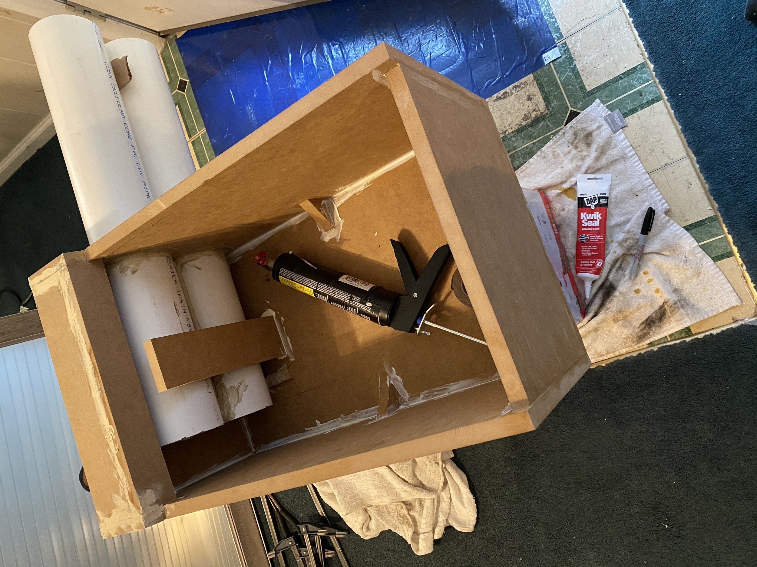

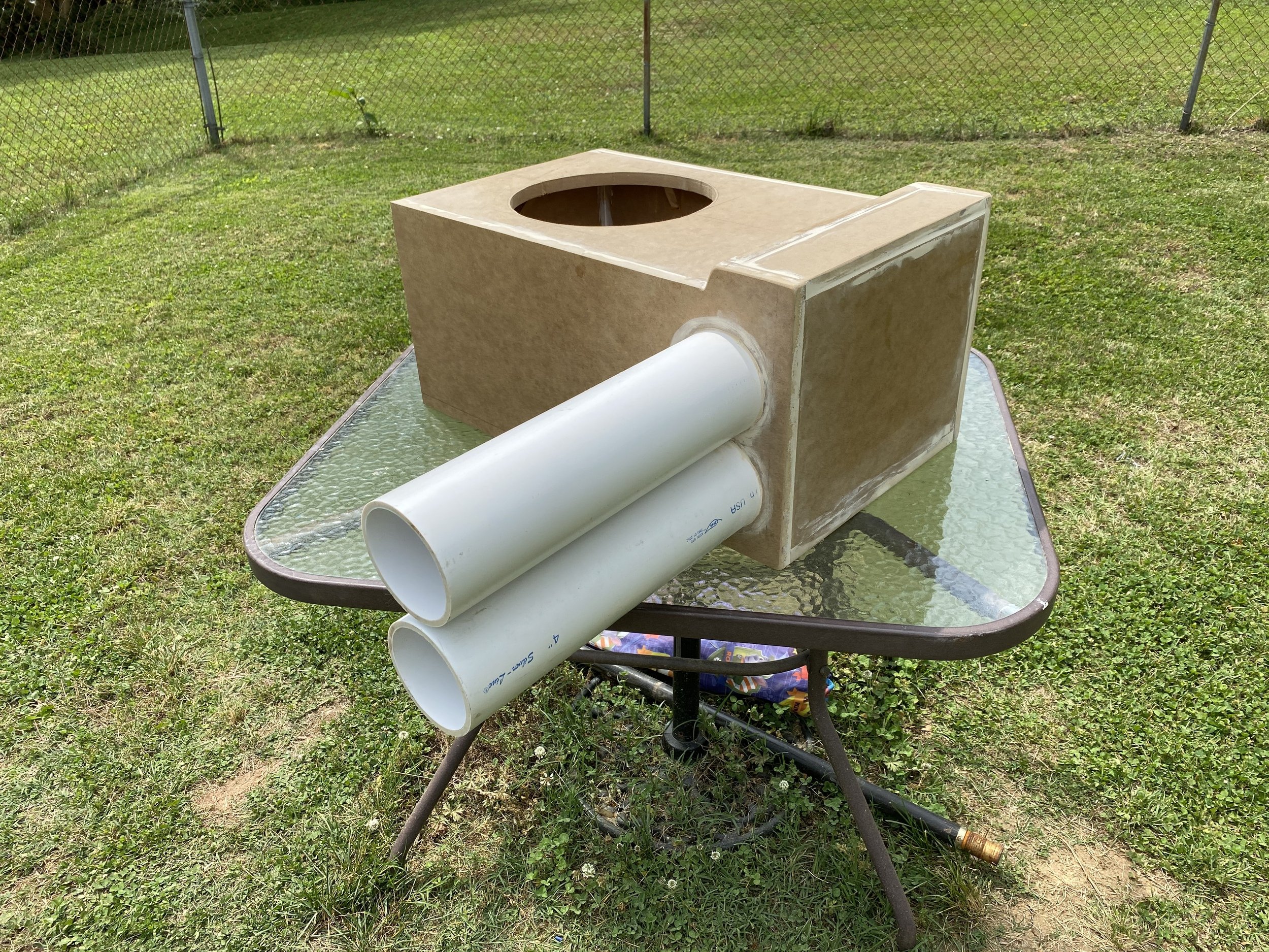

I was going to make some rings and attach to outside of box where ports enter the box but I got tired of cutting wood,lol. I’ll incorporate something nice and make sure they are sturdy!

I don't think it'll matter too terribly much either way. Just lmk, you can shoot me any ideas you have, if you want.

Just make sure those ports are sealed around the holes in the side wall there. I almost put rings there too, but I didn't want to torture you haha.

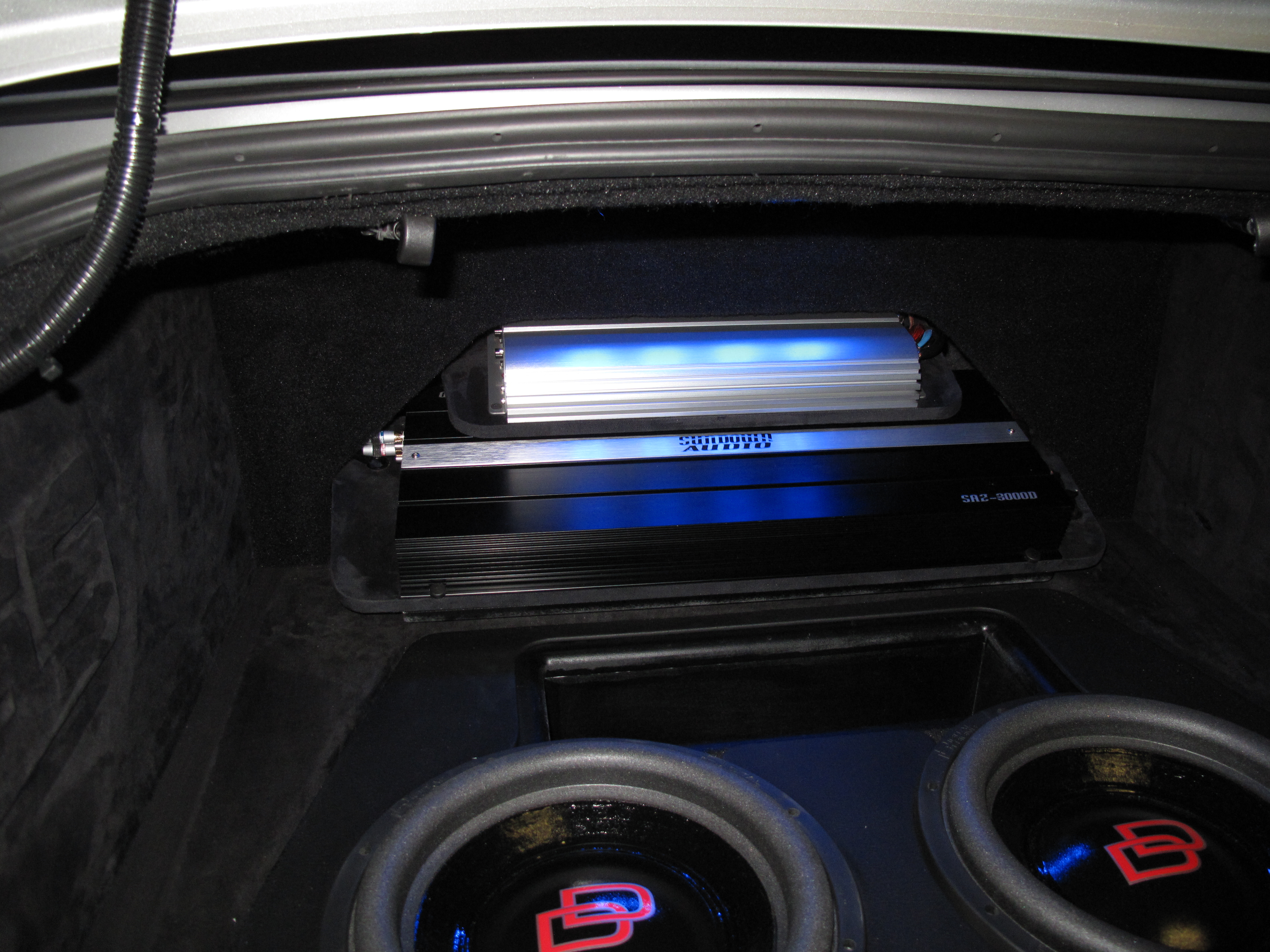

This was the DD/SAZ setup
It was in a 2007 Cobalt ss/sc
