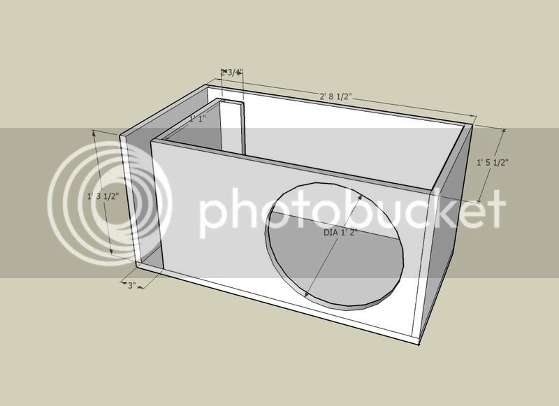

box design
17"high 38" wide 21" long, tune to probably 50 or 60 hz, and i don't really know a lot about airspace
50-60 htz i way too high for daily, you'll be bottoming out and the sub will act like its free air one below tuning notes. Id recommend 35-40 htz.
Id also do around 3.5 cubes for airspace.
Ill get on the design tomorrow.
Thats awesome Fargof.
What do you mean by that?

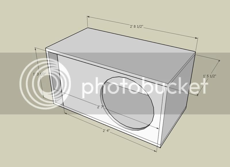

Anyway just finished up. Its 3.5ft^3 at 40 htz
Cuts:
Top and Bottom: 33.5x17.5"
Sides: 17.5x15.5"
Baffle: 28x15.5"
Back: 31x15.5"
Port L1: 13x15.5"
Port L2: 15.5x2.75"
