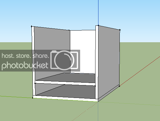

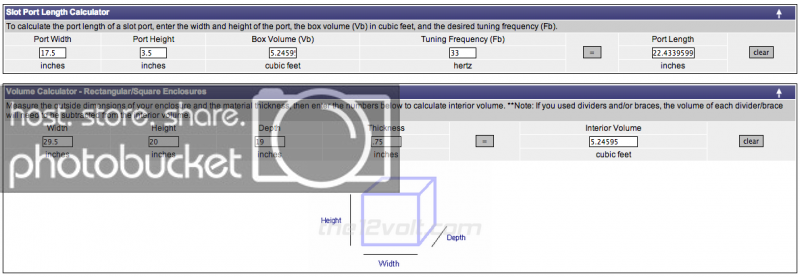

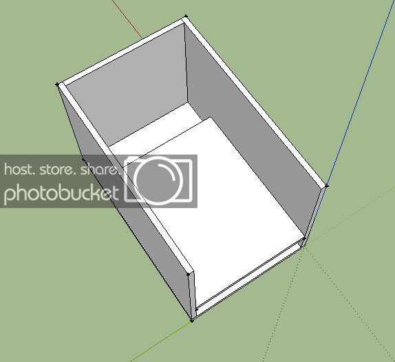

making an enclosure for an 18" @ 33 hz... how does everything look so far? would anyone change anything?
My 18's in 4 cubes were really peaky around tuning of 37hz in 5 cubes per played pretty well I am currently building a 12 cube box for 2 of them with 230 inches of port tuned 30hz
I dont really have time currently if those measurements are the most roon you got shoot for 5.5 at least just get port area up. I have customers boxes I am working on currently.
what program are you using to do this?
Google Sketchup
---------- Post added at 02:44 PM ---------- Previous post was at 02:44 PM ----------
okay, how many sq inches of port should i shoot for overall? also how do i calculate how many sq inches of port?
thanks man
Square inches of port is just width x height shoot for 16inches of port per cube. Not to be mean nut not knowing this not sure you should be trying to design the box til you do some more reading.
