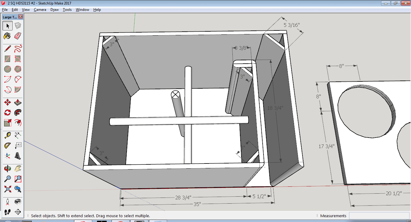

Box design help for 2 JL W-0 15'
I agree, maybe similar to this... IDK, I'd have to see what I had laying around, but I'd brace it for sure.
Not quite lol
I always brace no matter how small the sub is. That way if you upgrade the subs you still have a solid box.
That's kinda small for 2 15's below... lol... Just over 8.2ft3 net, yes OP that aero/round is your best bet and even with that the box is still small but better than a prefab.
