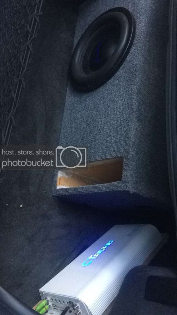

So I just bought a 2005 Lexus ES 330 and put in my 12 inch fiQ in a box that I made for my last pick up truck it was in hooked it up to the stock stereo via line output converter and it sounds decent but not as good as the truck because the trunk is sealed off pretty well.
So I've been looking at a few posts on here about aero porting through the rear deck spot that has an 8 inch stock sub which I would remove and fire the port through and I was thinking about facing the sub forward towards the front of the car and sealing it off from the trunk so that it fires through the ski pass opening that My car has.
Just trying to see if anyone has attempted or tried this set up and how it sounds
Also if you got any ideas of how to attach the aero port to the rear deck securely
Current setup

I think he means the ported section is ported through the rear deck or through a ski pass if you car has it. I am probably going to do this with my volvo through the ski pass in the rear seat. Good thing about 4ths in cars like this is you have no rattle at all. I wouldnt guess at ratios or tuning on a 4th at all. Have someone model one depending on the range and goals you want. I have a 4th design that has a larger sealed section and smaller ported section tuned to 60hz. I wanted a flat response from 70 down. The ratios and tuning changed based on what you are trying to achieve. If you want loud and low, you may end up with a larger ported section with a lower tuning.
I was definitely looking into a 4th order design, I'd be interested in going that route if it still enables me to get a full range of response like i'm currently getting out of my ported box. Are there any good free calculators out there for 4th order design or is this completely custom?
I also really like the idea of no rattle and not having to leave my skii pass door down all the time for example if I have a rear center passenger riding bch
