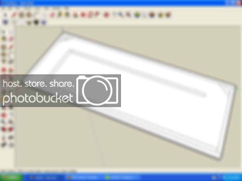

First picture is the base board with the sketch of the walls + port.

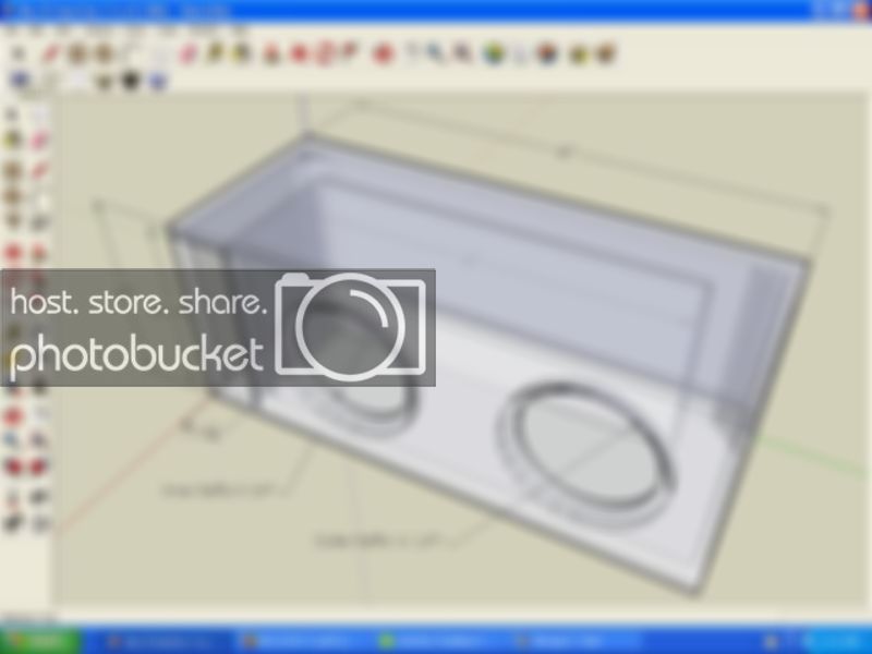

Next picture is with the walls and port constructed.

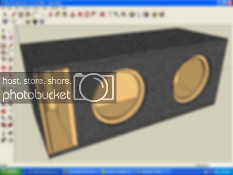

Next is a picture with the box completed and carpeting + wood texture added.

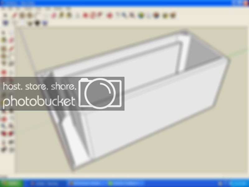

Finally is a picture of the completed box with translucent walls and some dimensions to get an idea for the cutsheet and construction of the box.
Hope this is kind of what you were looking for JDBoogie. Suggestions/constructive criticism welcome from both JDBoogie and the rest of the community.
