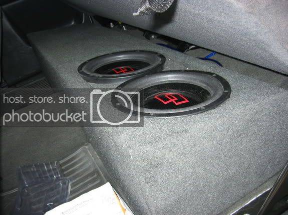

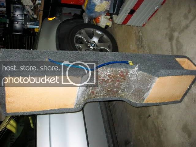

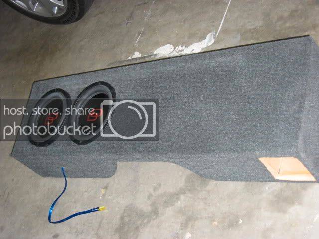

raise the seat 1/2". go ported to the rear. glass it over the hump. upfire the woofers otherwise acoustically weird stuff happens with the frequencies coming from cone.
six boxes later, we nailed it. this thing with two 1000 series 10"s was flexing the roof like mad with 1100 watts on the pair. this was in my 05 silverado.
