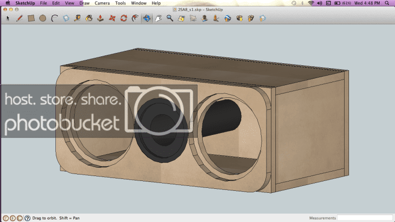

Heres a little design i came up with for 2 SA8s the box is 1.27 cubes before displacements with a 3" areo 10.75" long tuned to about 35 hertz. I plan on putting this in my 99 tacoma extended cab behind the drivers seat. Comments and suggestions are appreciated!
That's 1.27 gross before speaker and port displacements I think It comes out to roughly 1.02 after displacements if all my math is correct. It gives it about .5 cubes per sub which is what's recommended.
Thats probably only after sub displacement port will take up even more... You need 1.2 after at least
Yea I knew subs were .1 each I thought recommended was .5 to .7 per sub guess it's back to the drawing board lol thanks for all the input guys I'll get this figured out
Ok I went back to the drawing board and came up with a new design that gives me 1.43998ft^3 before any displacements. I figured the port displacement to be around .03ft^3. The port is still a 3" aero at 11.75" in length and it is flared on each end. Since the subs are .1ft^3 per sub this should come out a little closer to the 1.2ft^3 at 35Hz that I was shooting for. The tricky part in trying to calculate the port displacement was trying to compensate for the inner flare of the port but I suppose that a few thousands of an inch isn't really going to affect the tuning to any noticeable degree? Again any comments or suggestions are greatly appreciated, you guys have been EXTREMELY helpful thus far! //content.invisioncic.com/y282845/emoticons/peace.gif.2db28b618ed8d1964ebbe2f5021d2c39.gif
I hope you don't plan to stick with that baffle board.. looks REALLY weird
yea i thought the same thing when i finished it but i was too lazy to change it lol. Im gonna get rid of those rounded corners so it fits square with the rest of the box.
