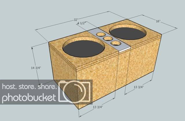

box design for 12" mach 5 ixl
Well there's your problem... with that amp mounted upside down, you're losing atleast 15 deebeez. Box looks good though. What are your plans? Raw wood, carpet, paint?
Hopefully that top piece isnt glued and cured yet, would be kinda hard to paint the port, or at a 45 degree piece at the sharp turn in the port if you wanted to.

I'm putting 2 of then in this in the near future. Its going to have removable/changeable ports

kyle i can tell ya the box it tuned way to low, and is to small. also how did the type R sound after we set up your amp, how did it compair to the IXL in our box?? what was the tuning of the type R box you built. we need to make sure your compairing apples to apples here. the IXL is a great sub and in the "right" box can walk all over a type R. the other thing kyle, what are you expecting with the power you have.

3. box - the box you had initially was completely wrong. Too small and tuned far too low. It also leaked and the subwoofer wasn't mounted correctly causing a rattle.

1. correct box - I happen to have one in my showroom as per Jay's photo above
