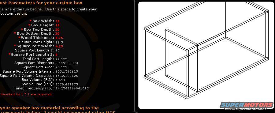

OP chambiec1 10+ year member I'm not loud at all?!? 229 0 Towanda, PA Nov 12, 2007 Thread Starter #34 Turns out with my max. dimensions I have around 7^3ft(before any displacement)... so I should have the room for a good 6th order, or even a decent regular ported box, correct-a-mundo?

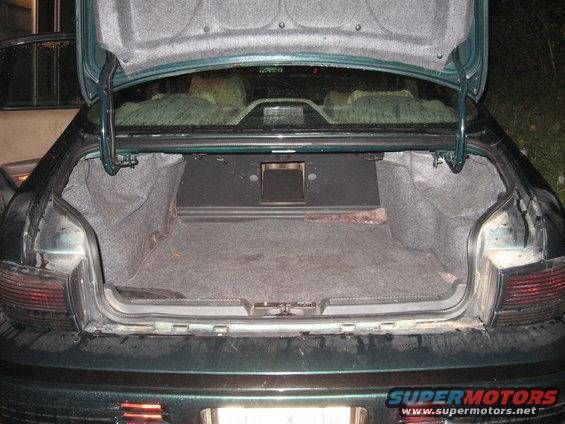

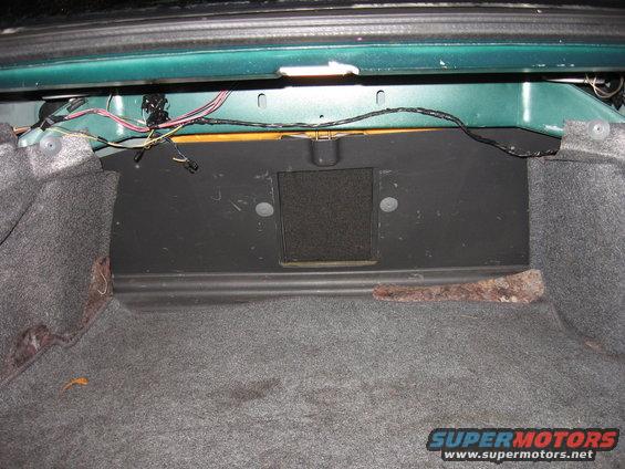

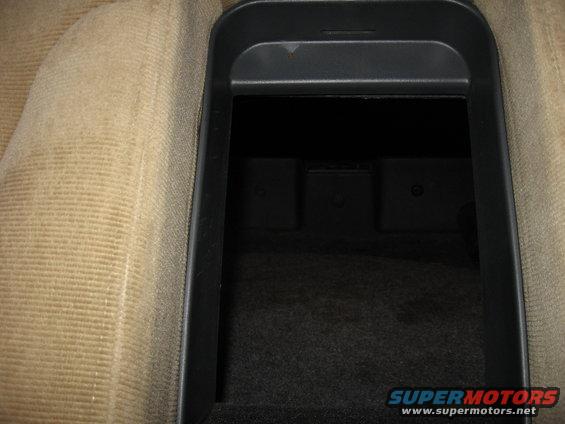

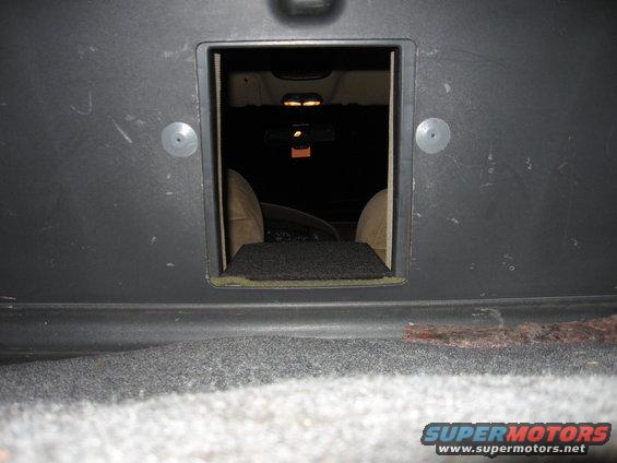

OP chambiec1 10+ year member I'm not loud at all?!? 229 0 Towanda, PA Nov 14, 2007 Thread Starter #35 Here are some pics of the setup of my trunk, just thought I would post them up and maybe you guys could give me some better help. Let me know what your guys' ideas are. Right now its a toss-up between a 6th order BP or aeros through the armrest.
OP chambiec1 10+ year member I'm not loud at all?!? 229 0 Towanda, PA Nov 14, 2007 Thread Starter #36 Could I do sub up, with 1 or 2 aeros aimed at the armrest or would that cause any issues? Or even sub back, port back and centered?(same as above)
OP chambiec1 10+ year member I'm not loud at all?!? 229 0 Towanda, PA Nov 19, 2007 Thread Starter #37 Well... I have been thinking lately. Should I pursue the possibility of doing a port through armrest, or just got with this design? Is there any way to do sub back, port back and centered? How would this box sound forward facing with the armrest down? Thanks for the help so far.
