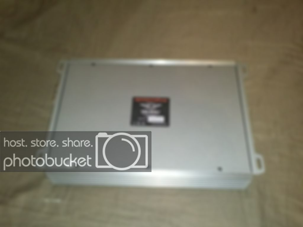

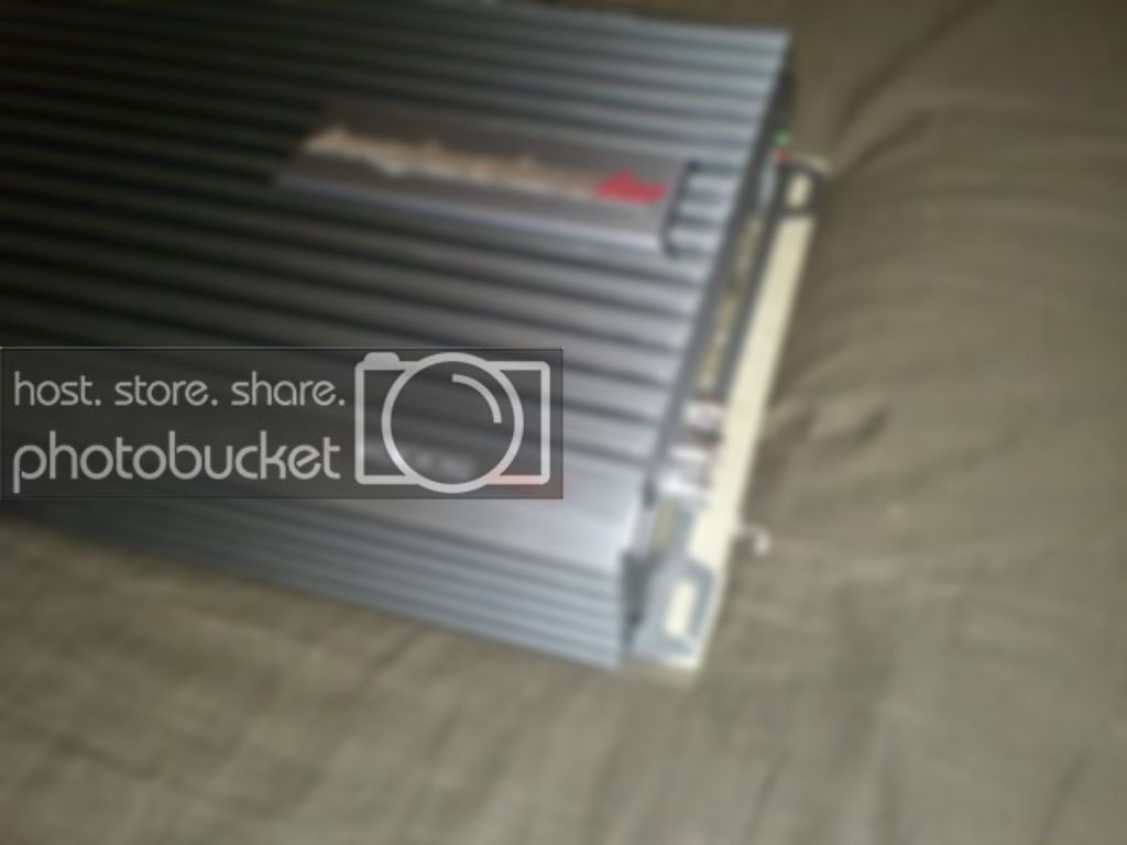

first the amp

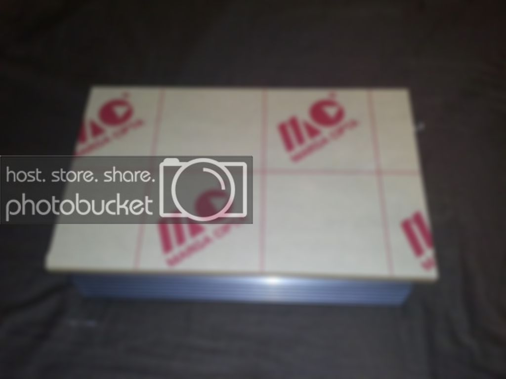

plexi on amp

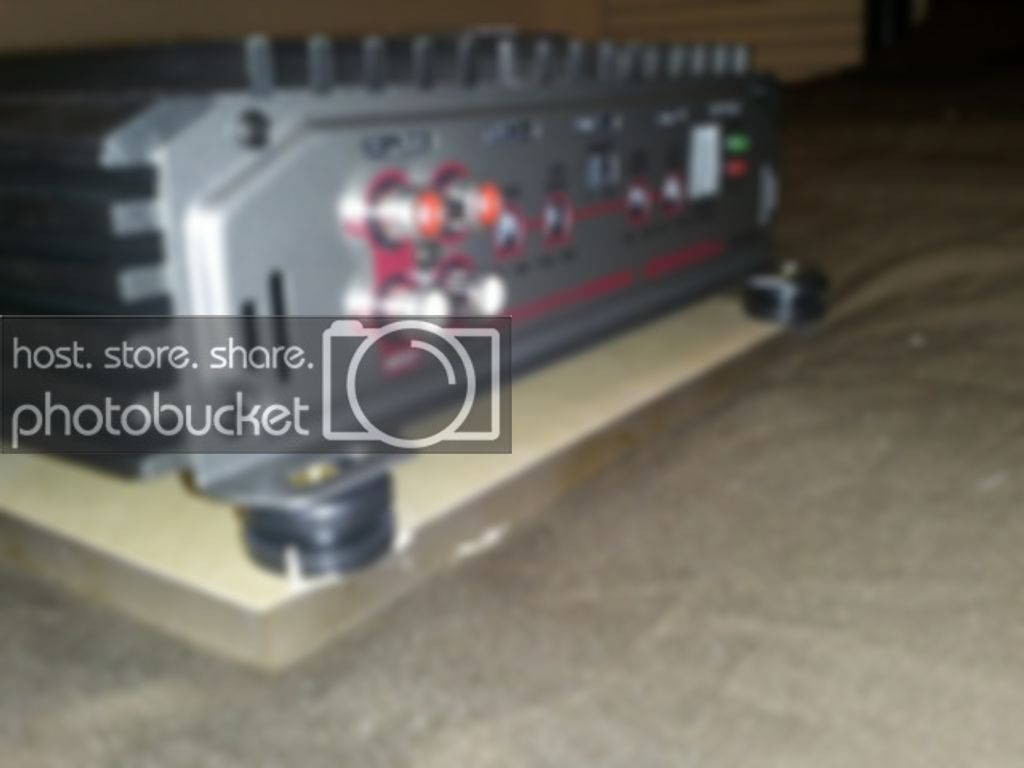

right side up
spaced out(going to have to get a tad bit bigger ones.... power wire wont fit lol

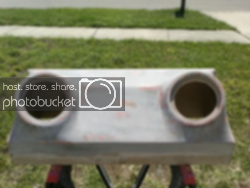

well got alittle work done today

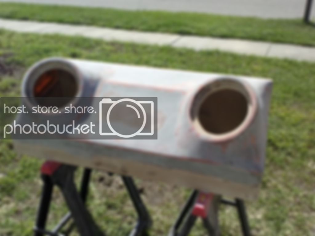

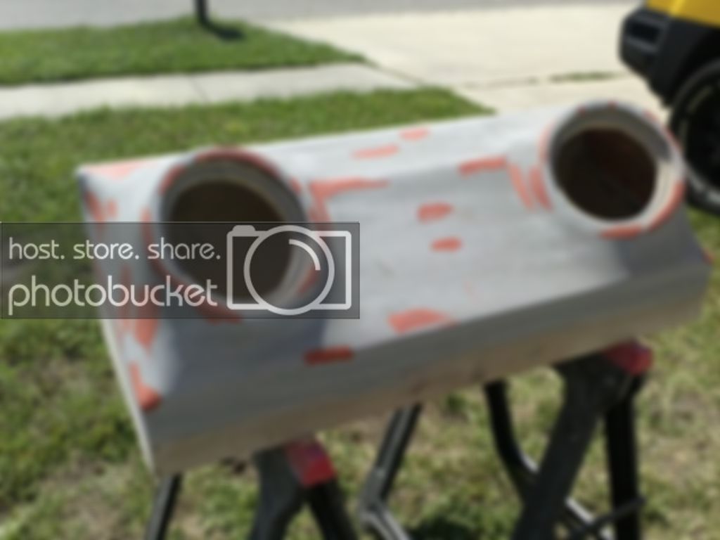

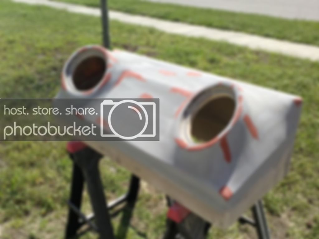

finish pics before first coat of primer(guide coat)

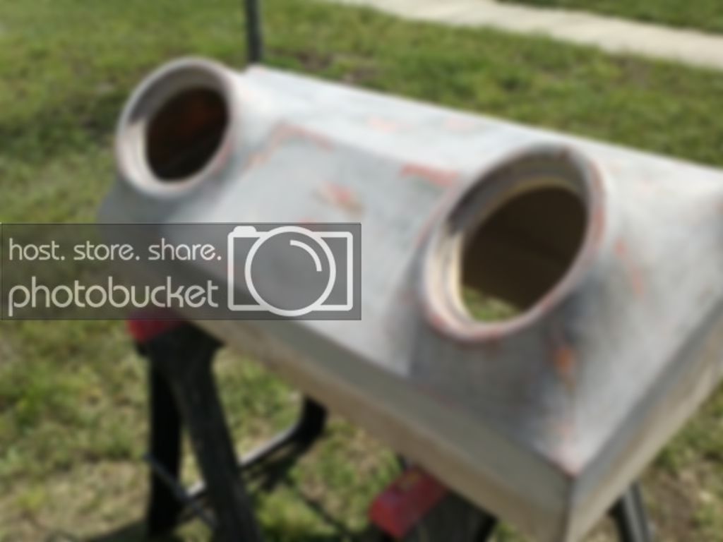

then primer with some spot putty

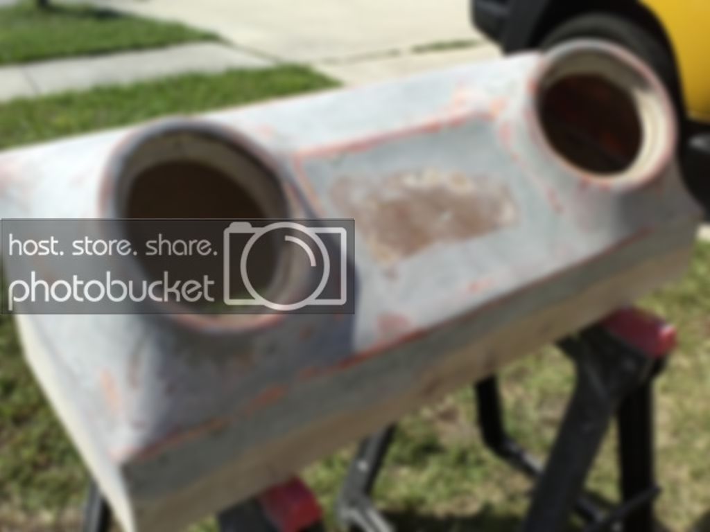

then sanded spot putty areas and then wet sanded the whole box with 400 grit....**** is smooth like a baby's butt..... still have some work to do on it before paint gets laid down.
Did you figure out how you wanted to mount the floating rack? So many options and they all work out pretty well haha.
yeah going to use schedule 40 pvc pipe to make 2 spacers to send a bolt thru each one and the plexi making sure it goes through the wood on the box to attach.... then of cousre the amp will be spaced from the plexi so i can run the wires inbetween the plexi and amp
