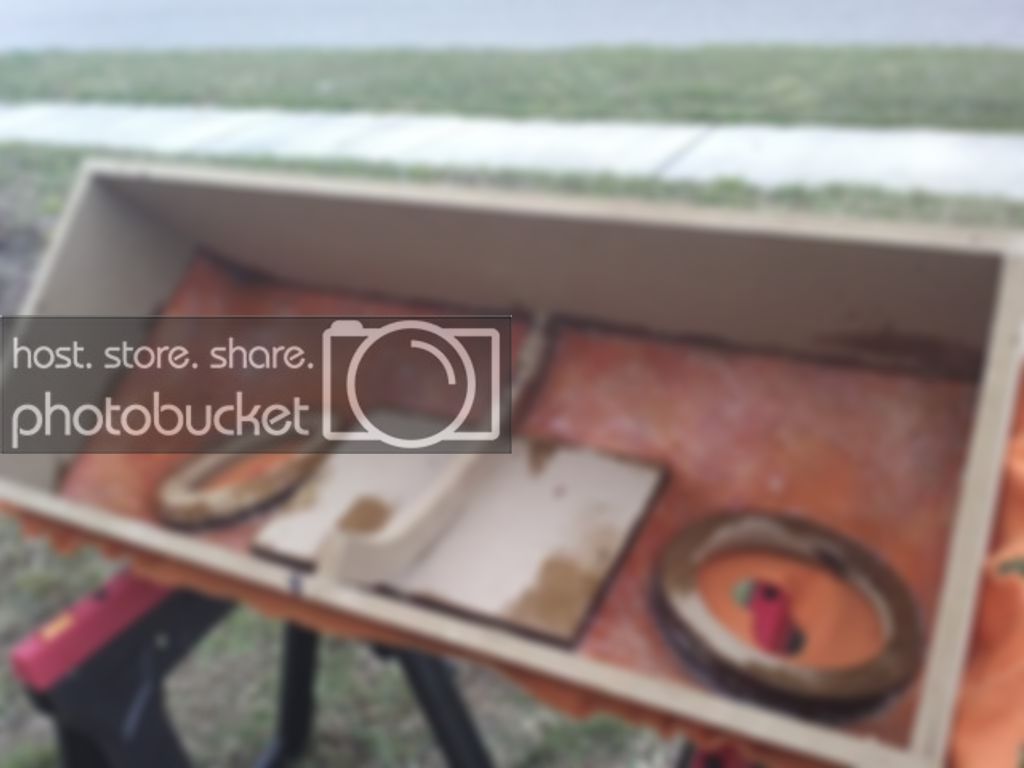

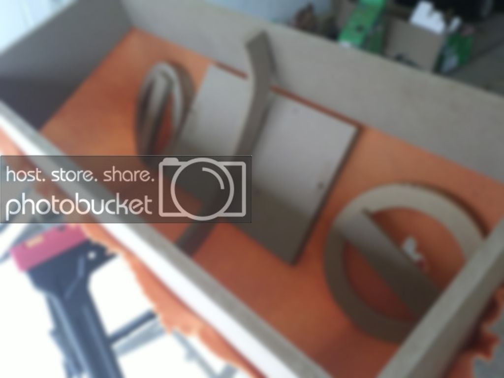

well the box went under surgery today.... took the bottom off to open the inside and started to lay down layers.
i first started with just a resin layer to make sure the fleece got soaked on both sides and then i built it up so far with two layers of fiberglass and resin. weather took a turn(sun went away) plus i ran out of brushes so stopped at two for now lol.

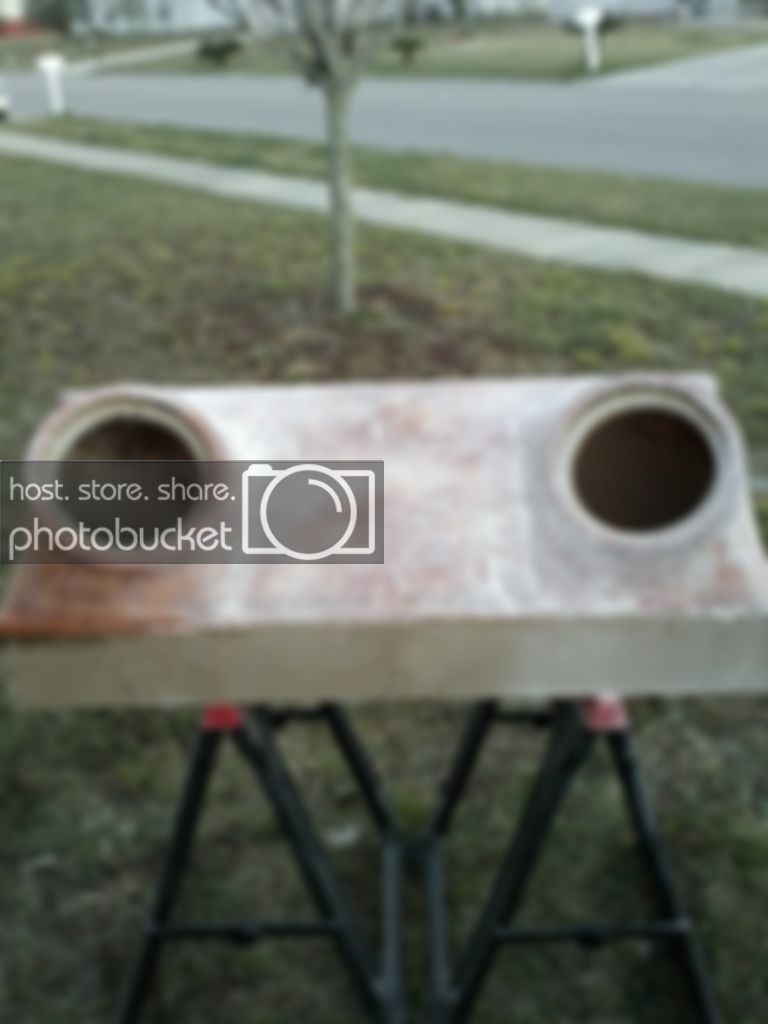

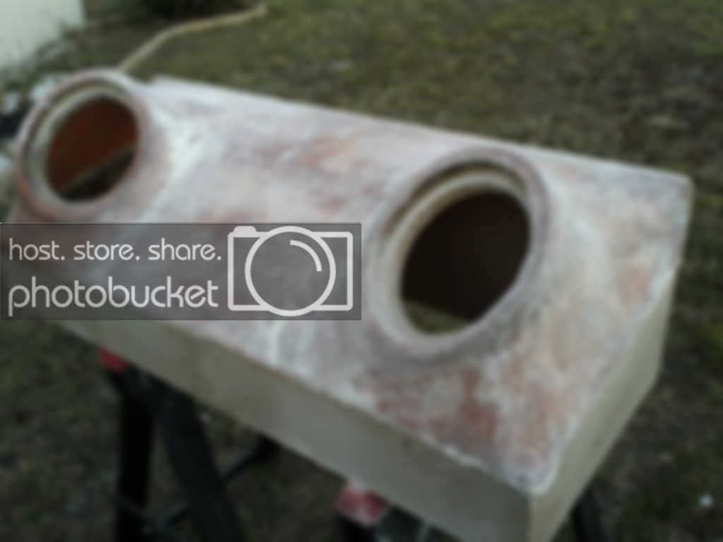

well weather(high wasnt even 50) wasnt the only thing that slowed down progress on this box today... this afternoon it warmed up to where it was barable outside so i tried to sand the box down to get ready for filler, well my palm sander took a crap on me so i have to go get another one.... i think i might get an orbital sander instead but here is what the box looks like now.
not much different but can see i trimmed off the extra fabric and for the most part trimmed out the speaker holes.
