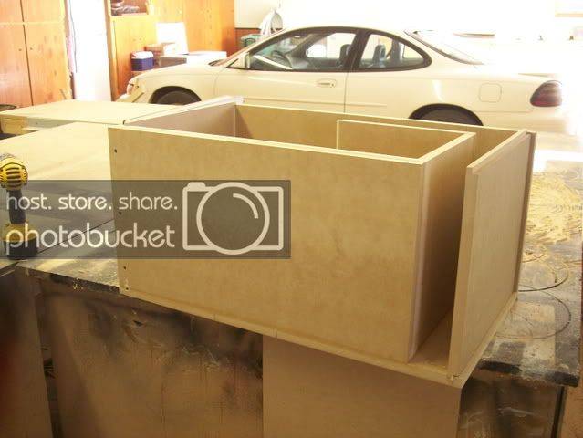

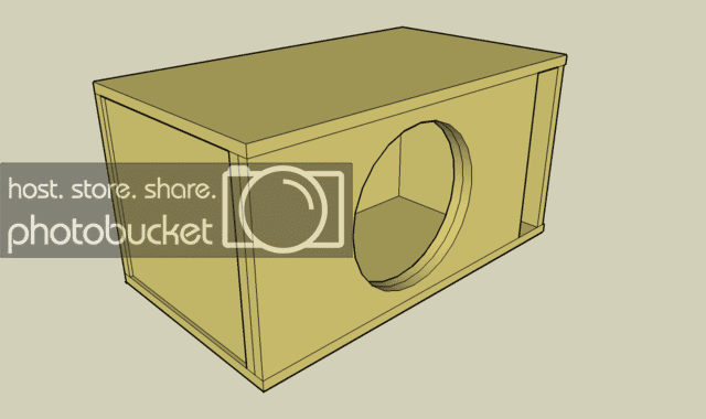

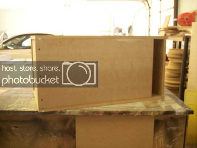

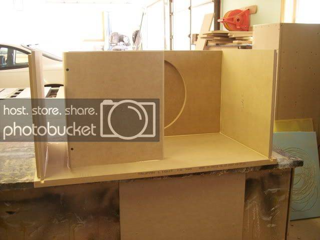

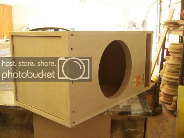

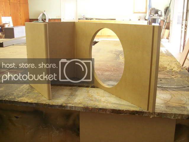

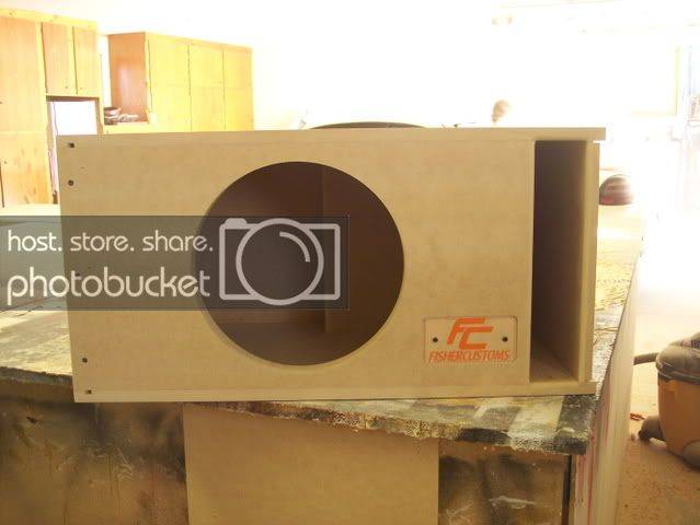

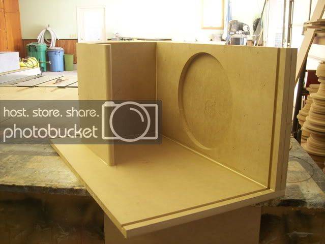

This box is 2.15 @ 36 hz for 12" HDC3. Double baffled, and will be left bare.
wow....i like the way the pieces fit in with each other...//content.invisioncic.com/y282845/emoticons/clap.gif.178cba2c538c68e720c727fcb024b19c.gif
