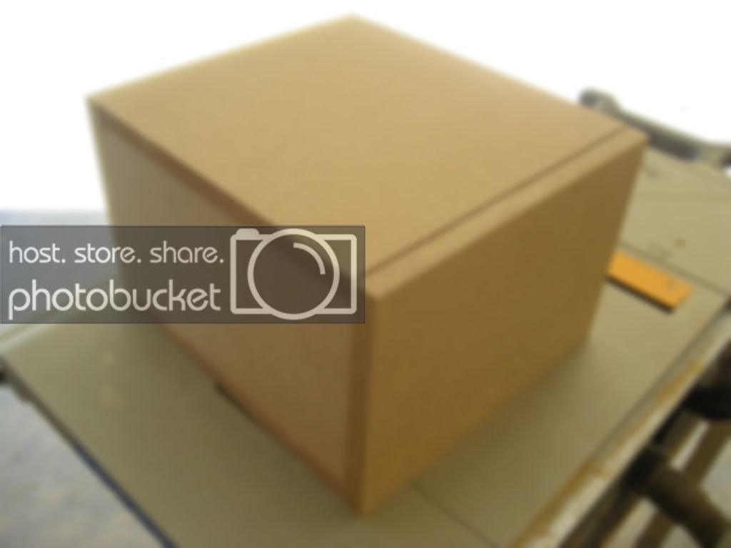

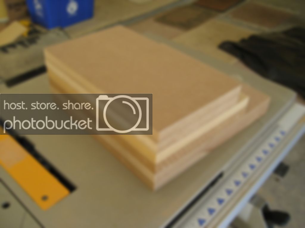

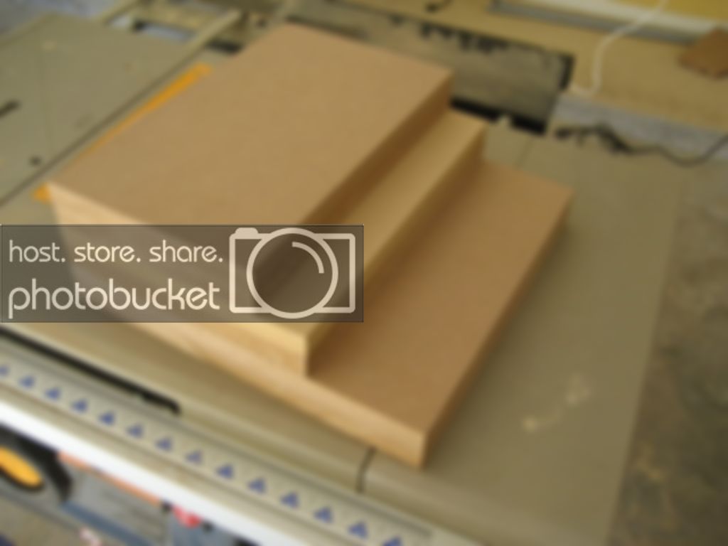

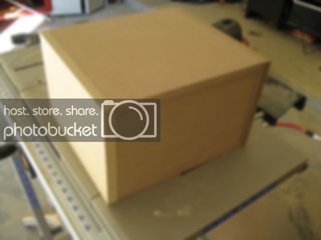

Anyhow, I started on the second one today... funny thing is, this one is coming along better than the other one, even though I'm on vicodin making this one. Go figure.
Yes, I know one piece of wood is a different color, you wood-racist bastards. I just ran outta wood on the board I was working with, so I grabbed a piece from my pile.

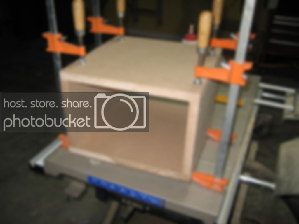

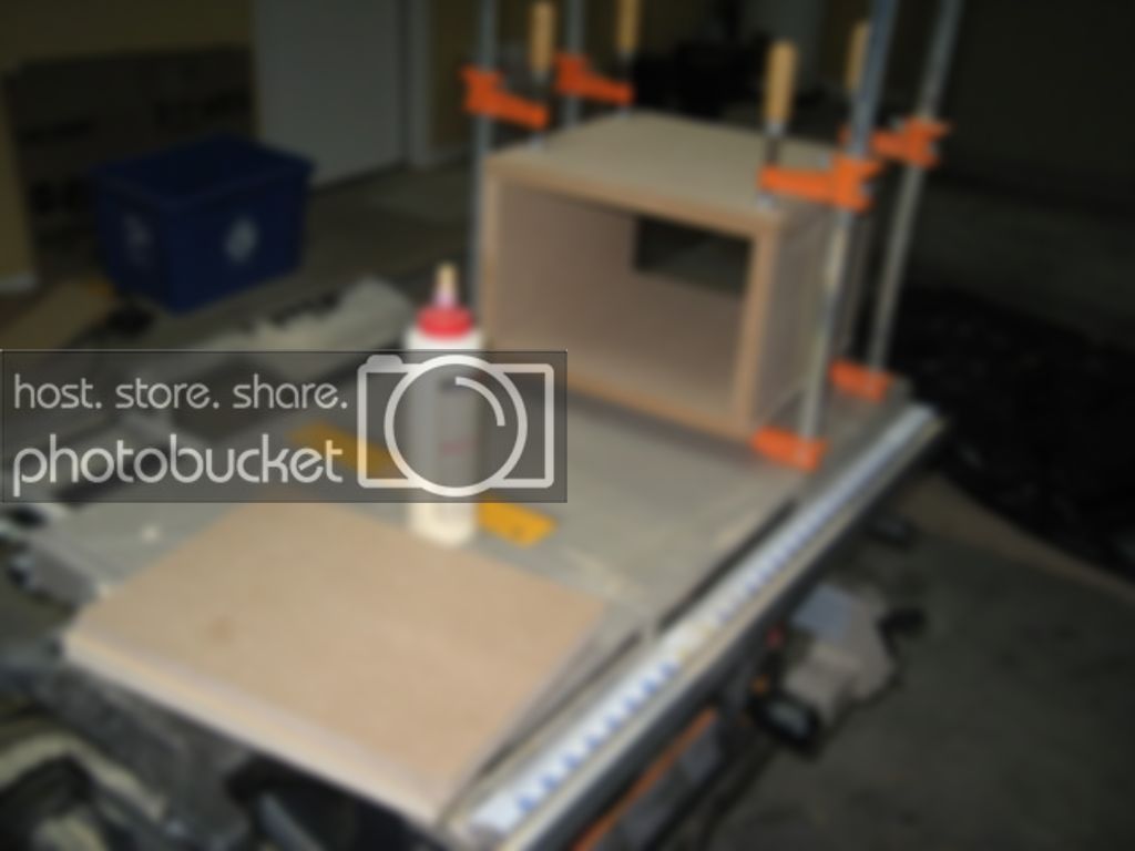

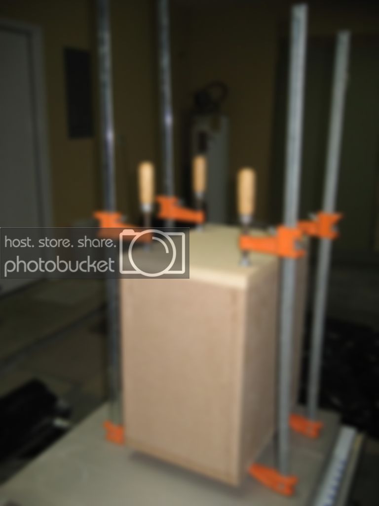

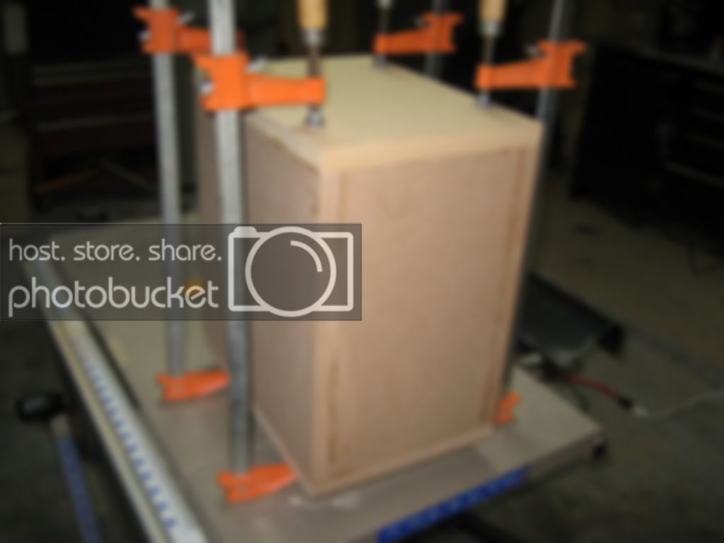

Mocked up. It's gluing right now... the cam ran outta batteries, so I'm charging it for a sec so I can take more pics of it being clamped.
Ok, here it is clamped together. Coming along nicely. Everything matches up perfectly.

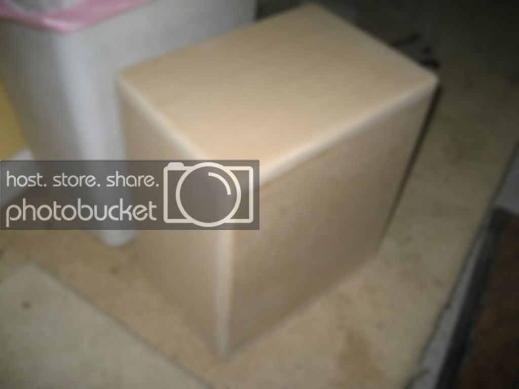

There's mr. Titebond (Pronounced Tit-e-bond)
And the other one chillin, waiting on its bro to be finished.
Looking good so far. You did make sure the crossovers would fit through the driver holes, right? //content.invisioncic.com/y282845/emoticons/smile.gif.1ebc41e1811405b213edfc4622c41e27.gif
//content.invisioncic.com/y282845/emoticons/laugh.gif.48439b2acf2cfca21620f01e7f77d1e4.gif Brings back horrid memories.
The worst is when you put the xover in first and the baffle last then you blow a cap and have to rip the box apart... //content.invisioncic.com/y282845/emoticons/verymad.gif.3f39c5c2fd57527b671fad3efdfac756.gif
