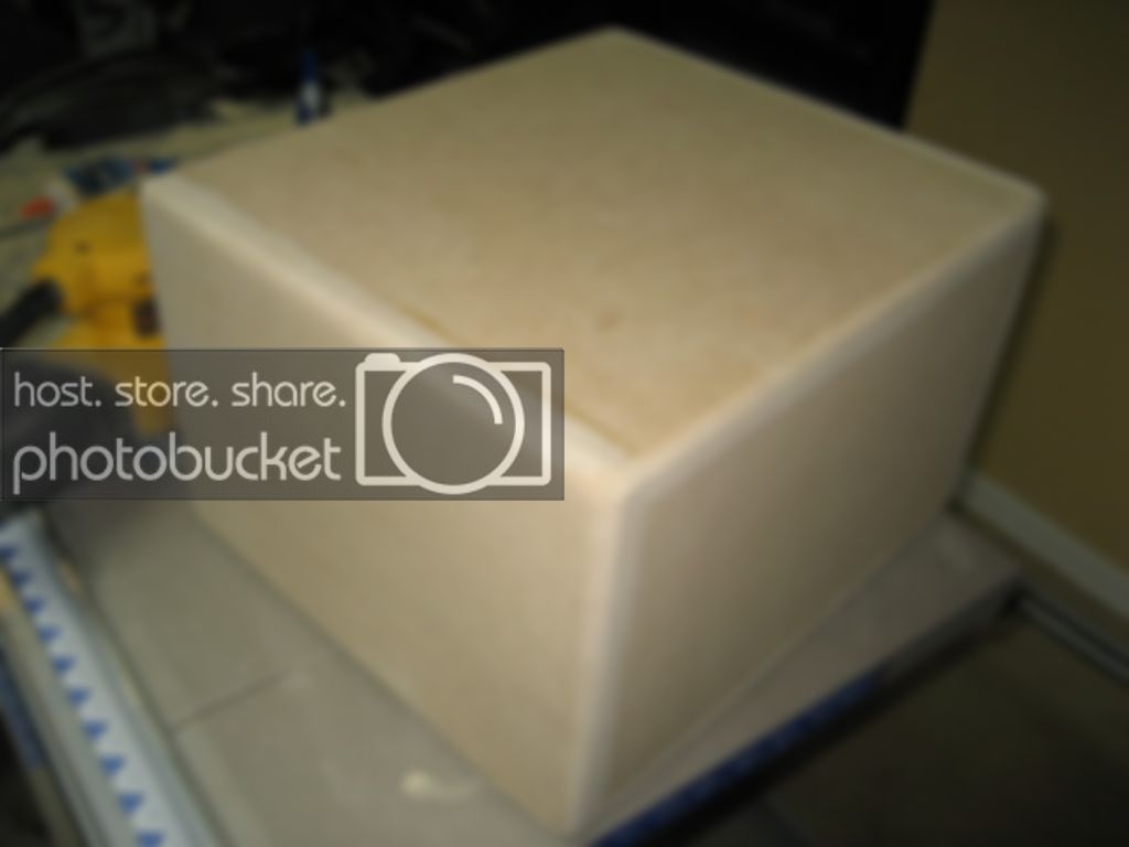

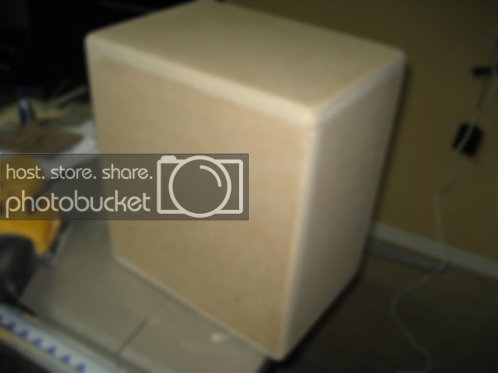

Thats the first one. No in-progress pics. I'm going to build another exactly like it, though. It's .45 cubic feet, and it will be tuned to 32hz with a 2" PVC port. It will house Oz Vector tweeters and xovers, and either an Oz vector mid or AA Poly mid.
More pics as I make the other one //content.invisioncic.com/y282845/emoticons/smile.gif.1ebc41e1811405b213edfc4622c41e27.gif
No no no no, raise that tuning by at least double. For regular speakers, tuning in the subbass region is useless as they aren't meant to reproduce those frequencies anyway. Boost what your sub doesn't have to cover, which is the midbass region, or anywhere from 50-75hz depending on the setup.
Well, I've been running the AA polys at 35hz, and they sound great. The thing is that I won't be able to put a HPF on them, so I'd like to keep the tuning low. I know it's not ideal, but I'm not trying for exceptional SQ. Just something alright for movies and music.
So? It doesn't matter. You aren't seeing any benefits by tuning that low, as they aren't reproducing those frequencies with any useful output anyway.
