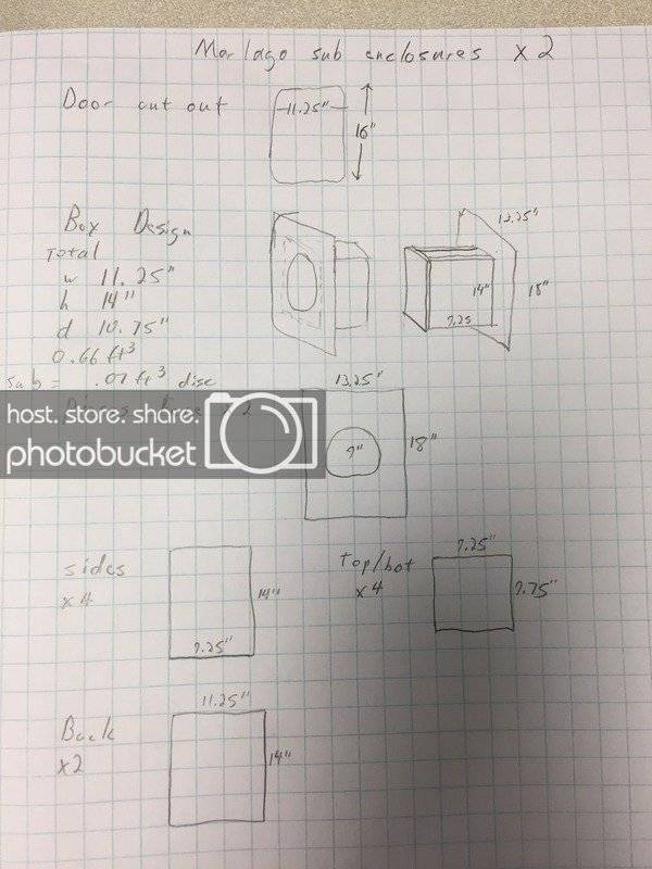

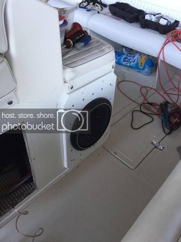

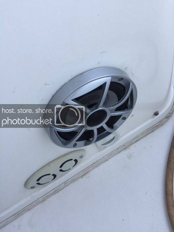

I've got two 10" rf punch p3d2s in .59 cu ft enclosures made from 3/4" marine lumber (plastic) aka starboard. I'm getting a nasty like rattle at higher frequencies. Is this the cone or my enclosures rattling against the fiberglass. I doesn't seem to occur at lower frequencies, just high freq beat kicks.
Need to tidy up the wiring yet, just testing.
CAB 1600 at 2 ohm. Arc 2200 d class at 2ohms per channel on 4 wet sounds cs650s
