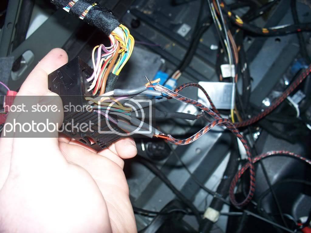

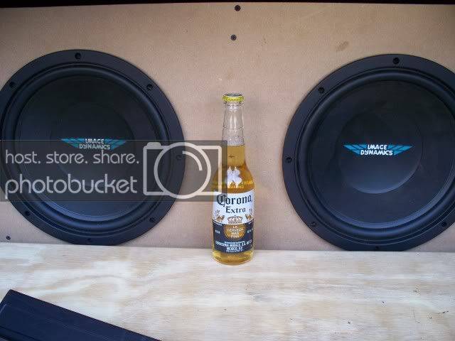

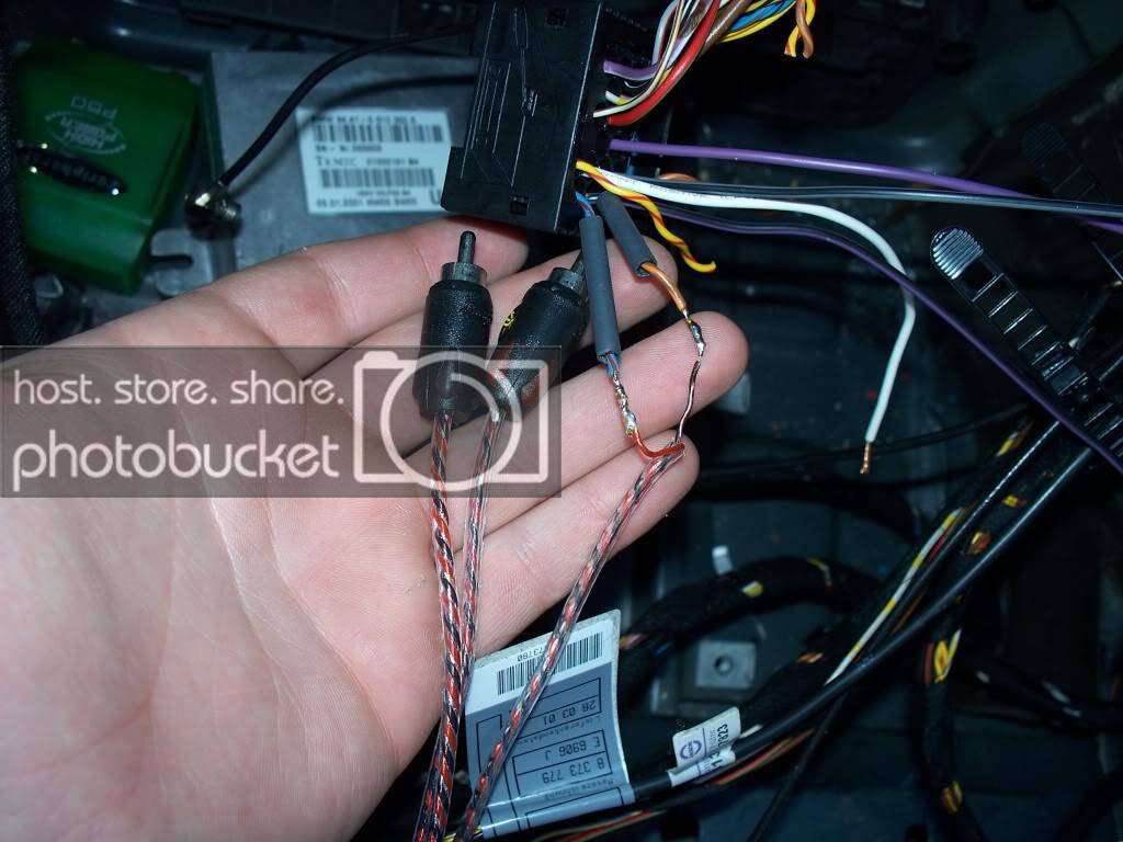

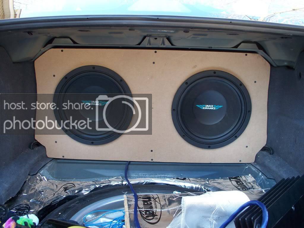

Sub box in and got the rca's wired to the proper wires.

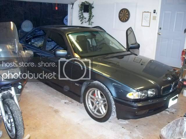

Okay it is....3 A.M. I am tired and half asleep. Considering I had to run errands and was out for almost 3 hours I think I did a lot of work. A friend of mine is away and was kind enough to let me use there garage, as I already house sit. SO picture time.

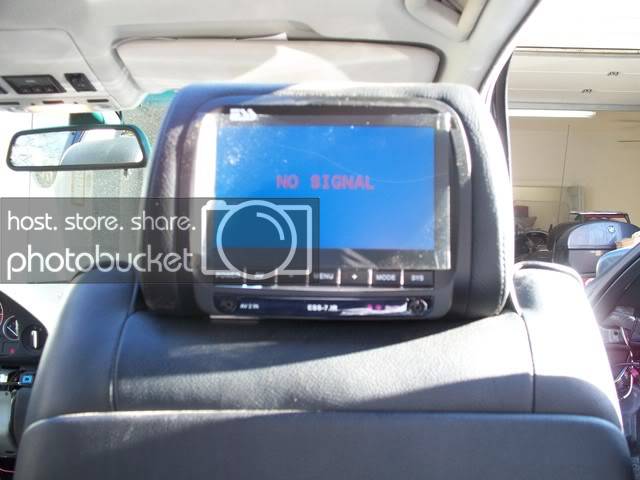

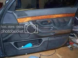

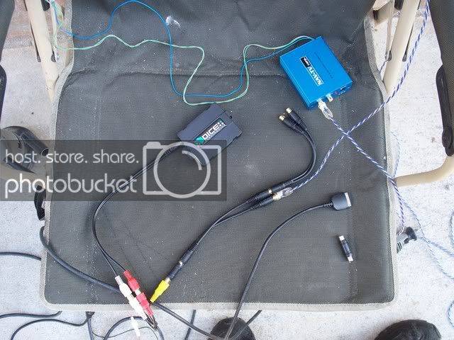

What the dice and navtv will be wired so the video will also go to the head rests.

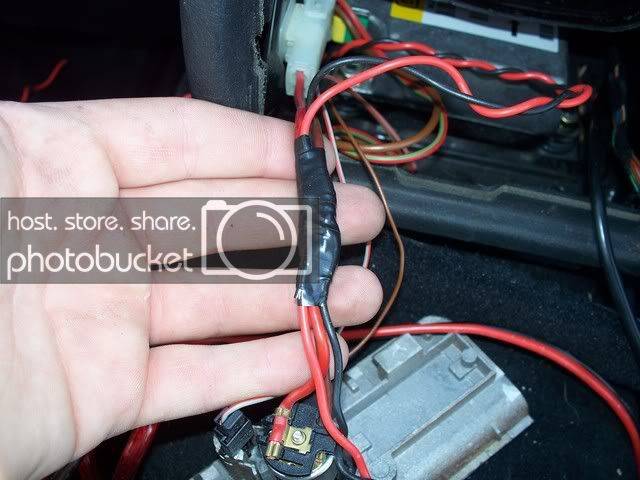

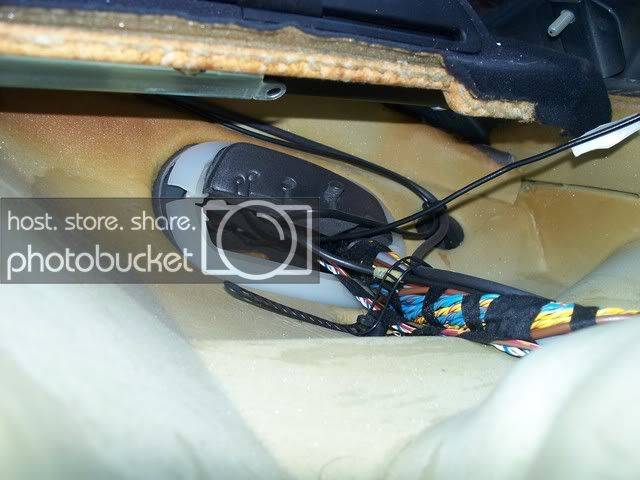

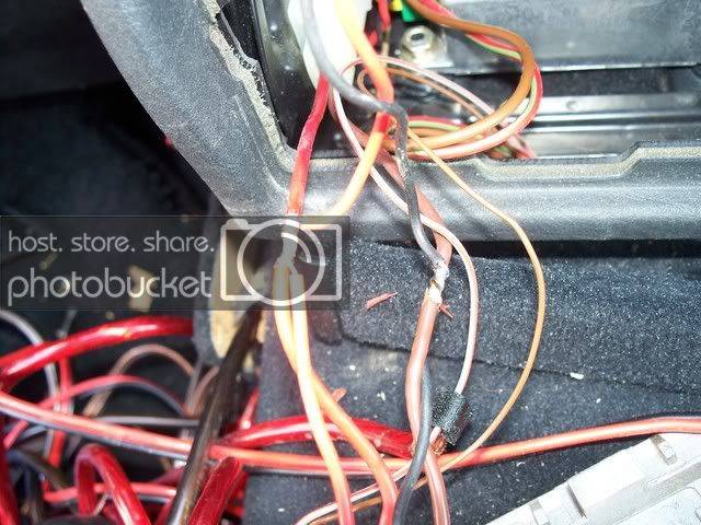

Head rests power wires

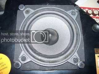

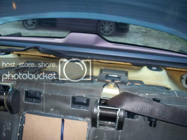

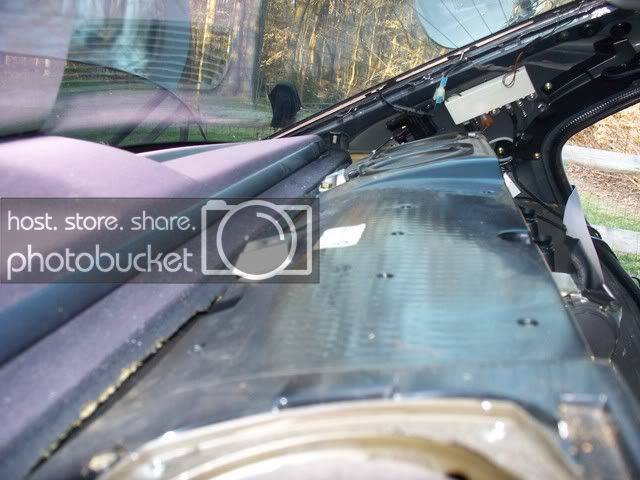

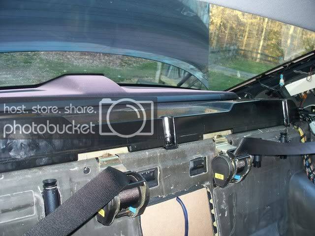

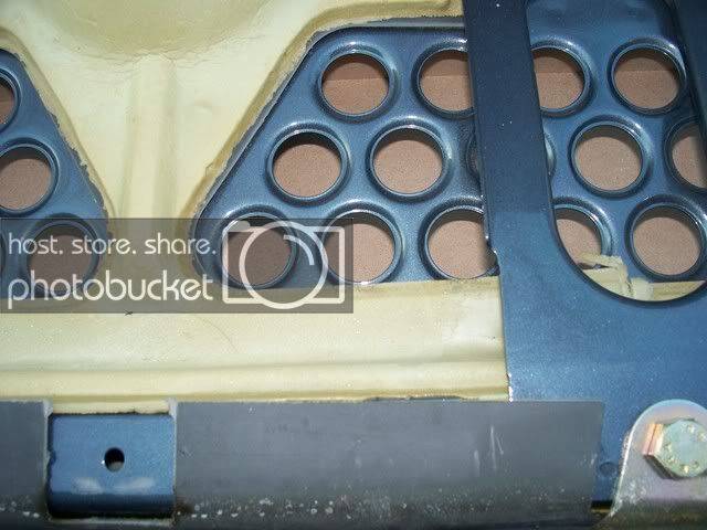

Removing the rear deck speakers and box so the subs will be able to push air into the cabin.

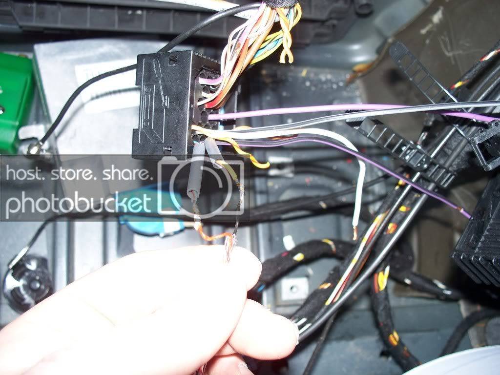

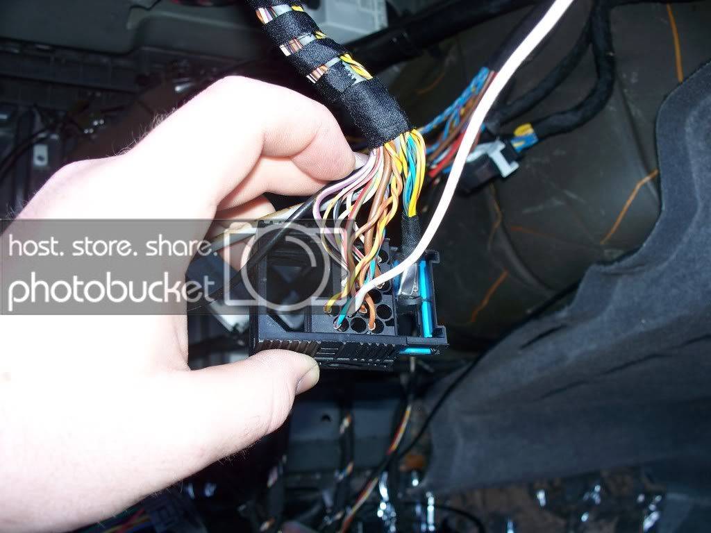

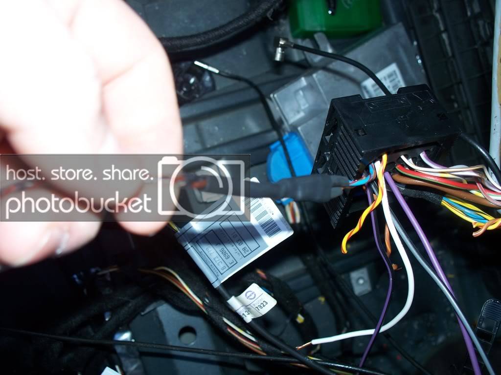

Where things are going to be ran threw to the trunk

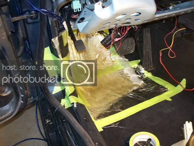

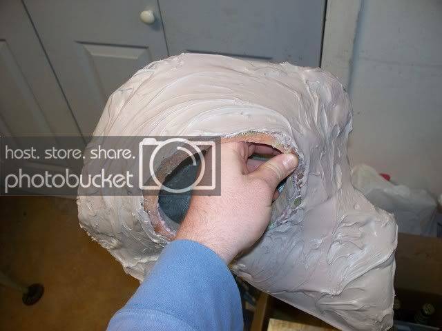

Bondoed the kick panel lots of sanding to do tomorrow.

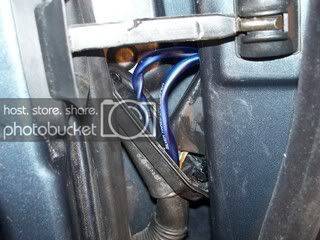

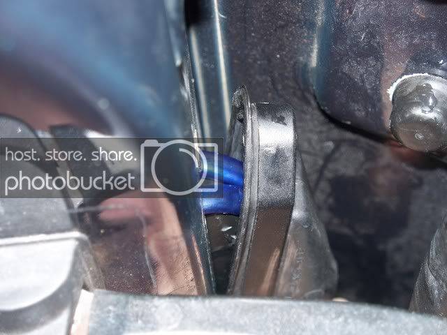

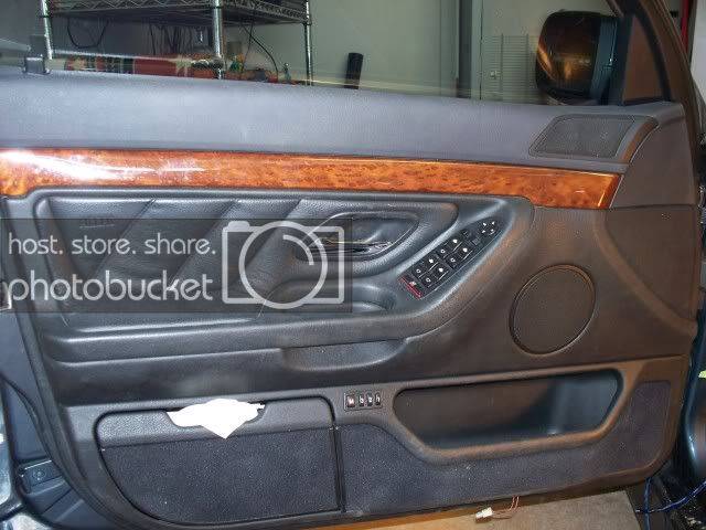

Had to run another wire threw the door for the woofer being in its own area.

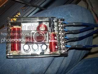

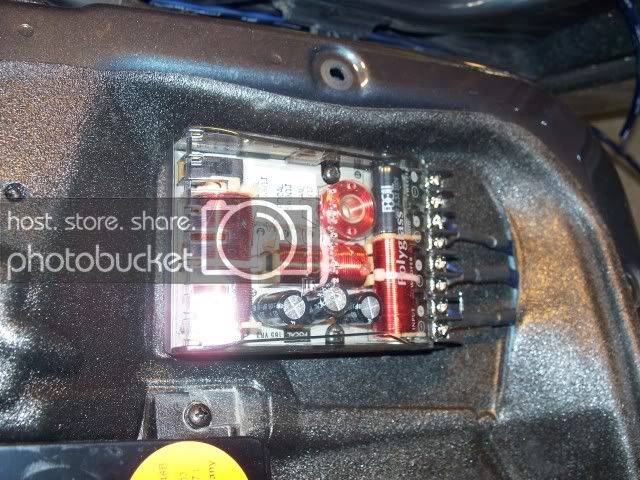

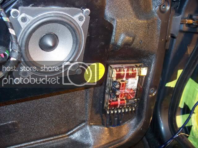

Crossover all wired up.

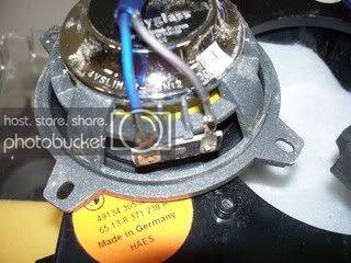

Mid installed
Right door all back together.
Left front wires ran.

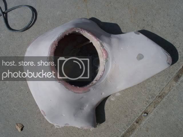

Sanded the kick panel down have to fill in a few spots.

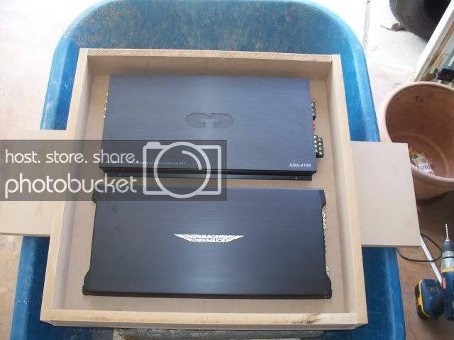

Started the amp rack
Will probably put two fans one on each side one in and one out for cooling.

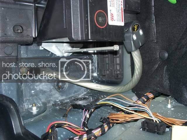

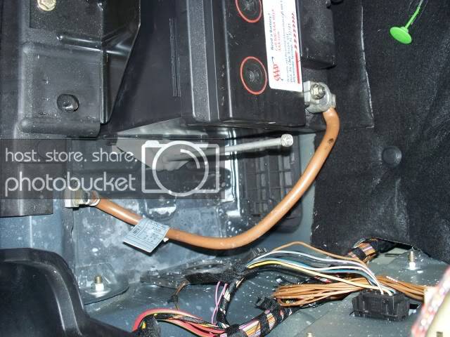

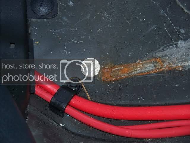

Upgraded the ground wire.
