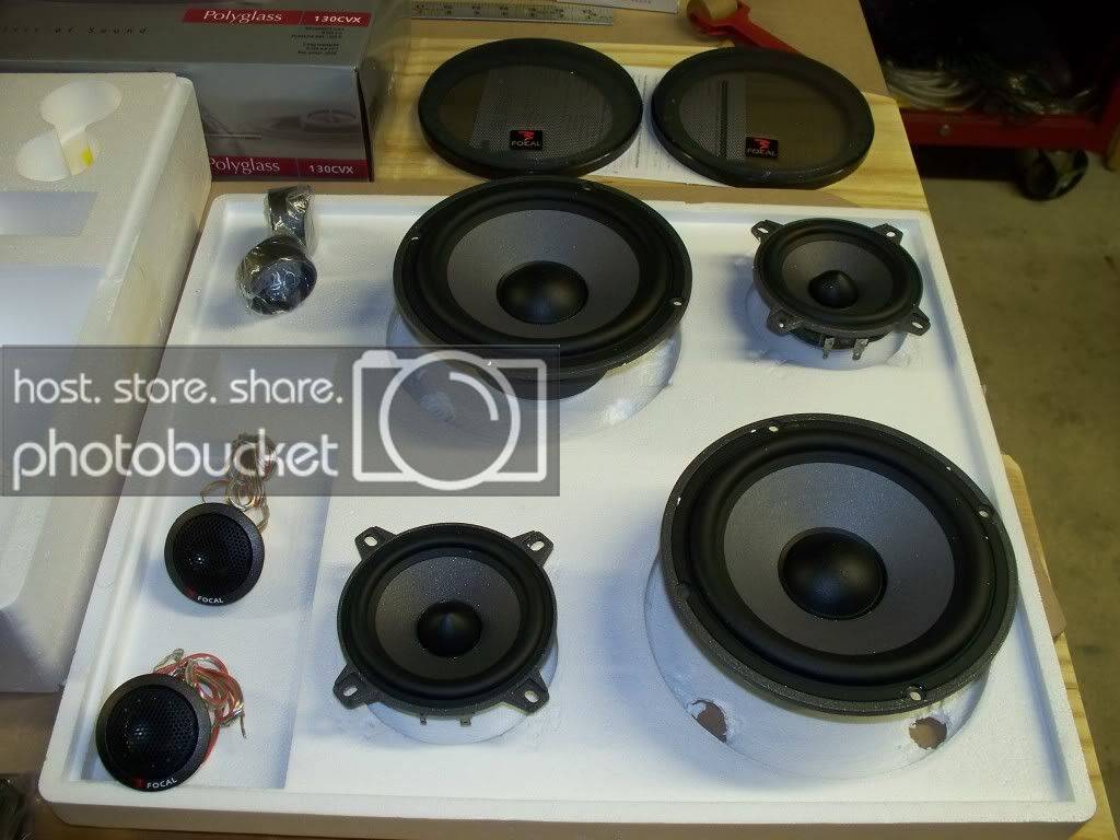

130CVX - Focal 5.25 " Polyglass Coaxial Speakers

FOCAL 165VR3 3 WAY COMPONENT SET

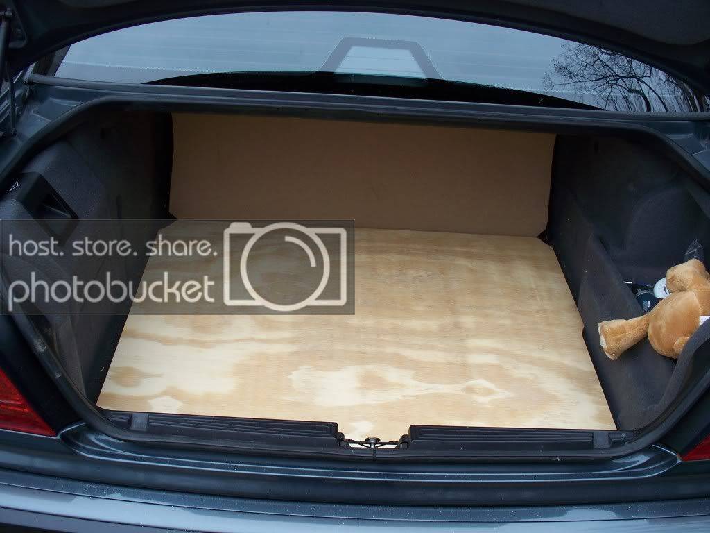

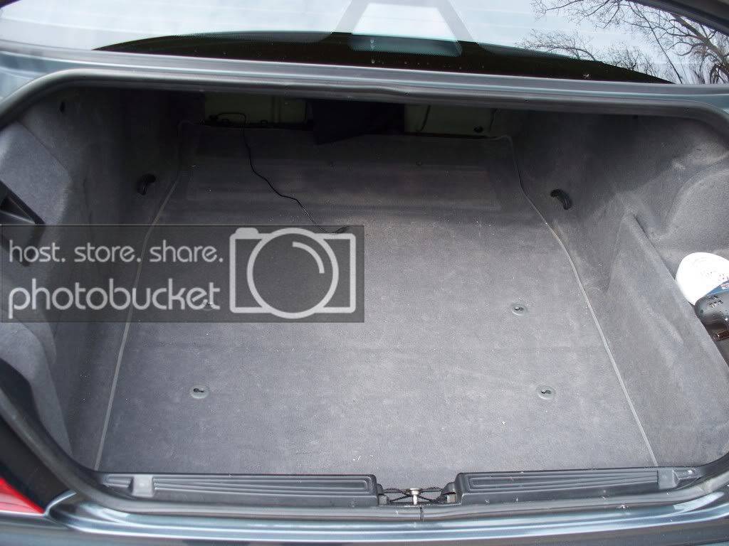

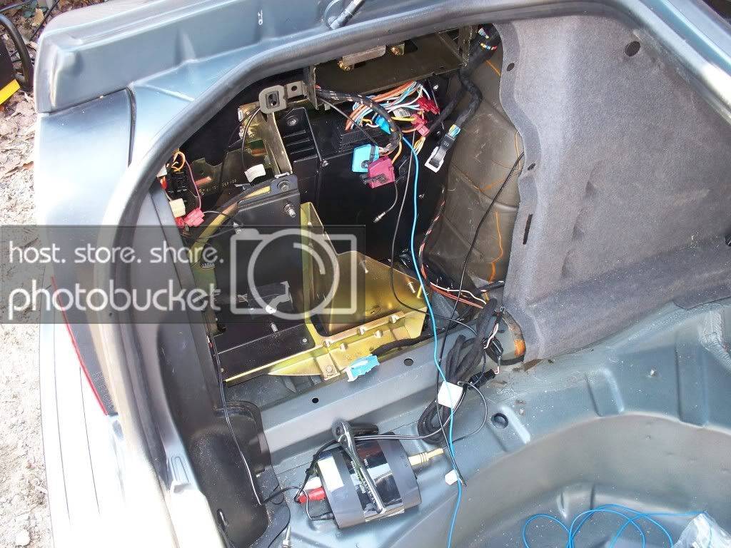

Trunk

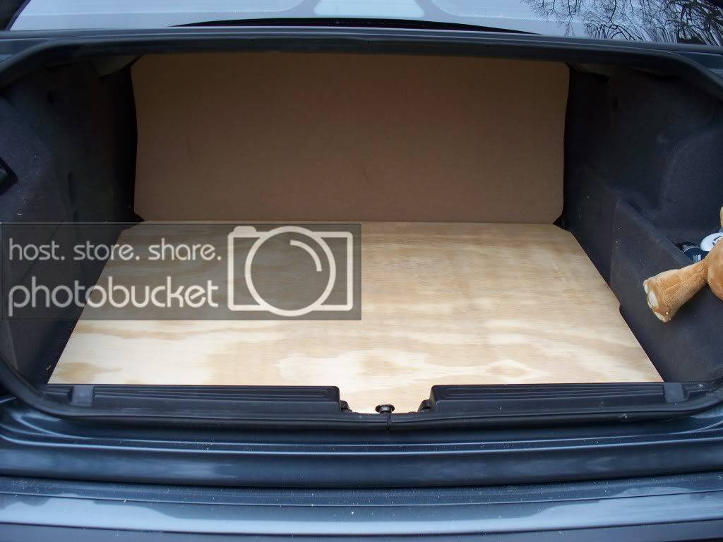

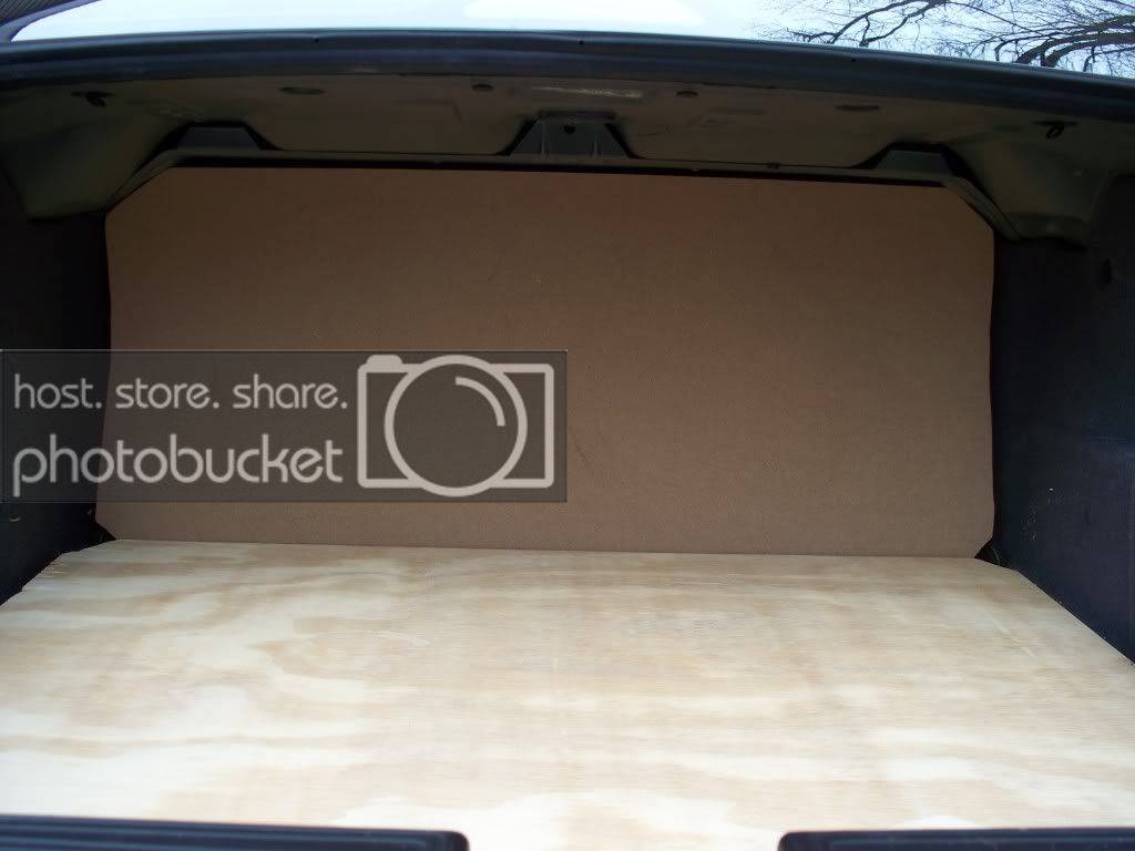

Work today included making the new parts to raise the floor to flush mount the amps and the sub box.
UPS Dropped off some goodies!

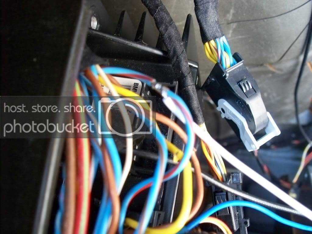

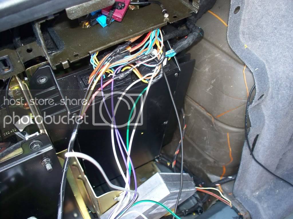

With other stuff going on I still was able to get the JL clean sweep in.

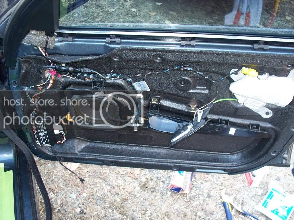

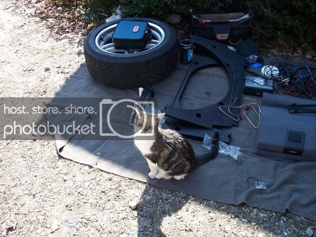

Started out taking the panels off.
Cat always lending a hand.

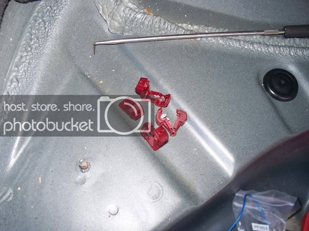

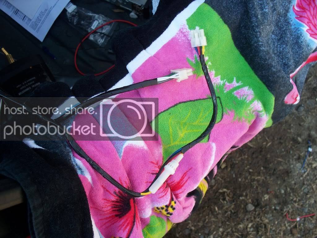

I HATE WIRE TAPS
Soldering all the wires
Wrapped the JL's wires up to clean up the look.

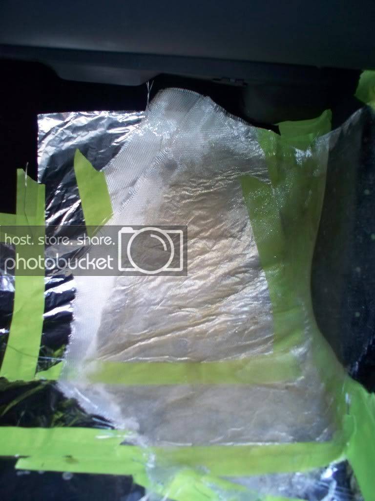

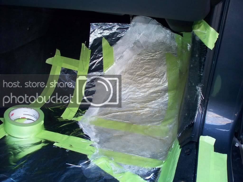

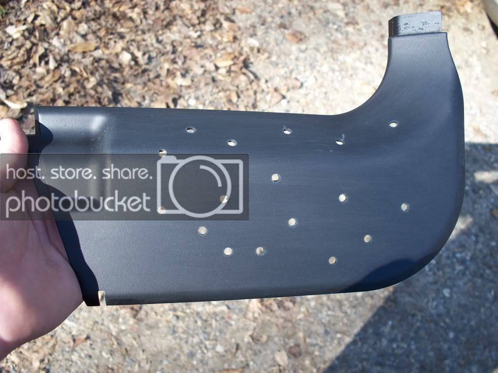

Today i worked on the kick panels. The reason for this is there is no stock location for a 6.5 inch speaker in the door. Also this will help imaging a bit by having them facing the drive and passenger.
Drilled holes to help the fiberglass hold to the stock panel.

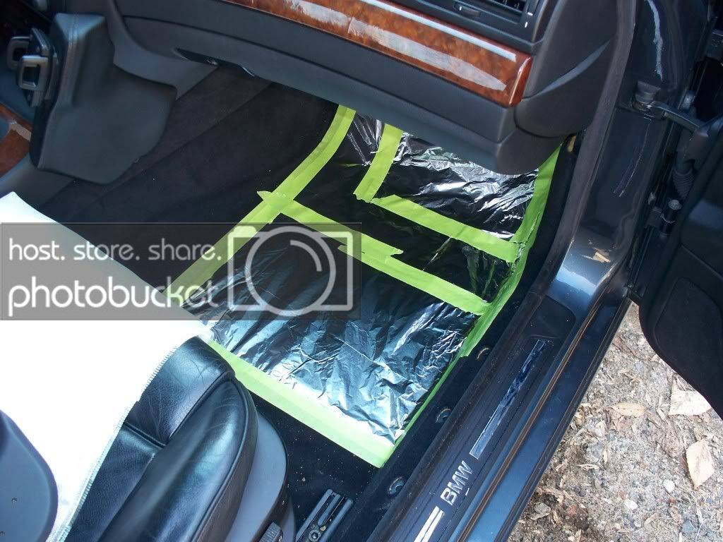

Laying down the foil and tape to protect the carpet.
Laying the cloth and resin

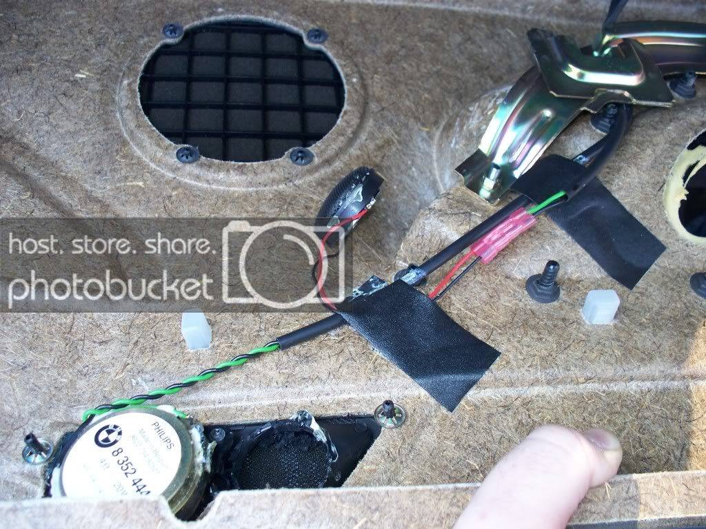

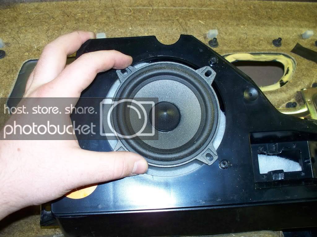

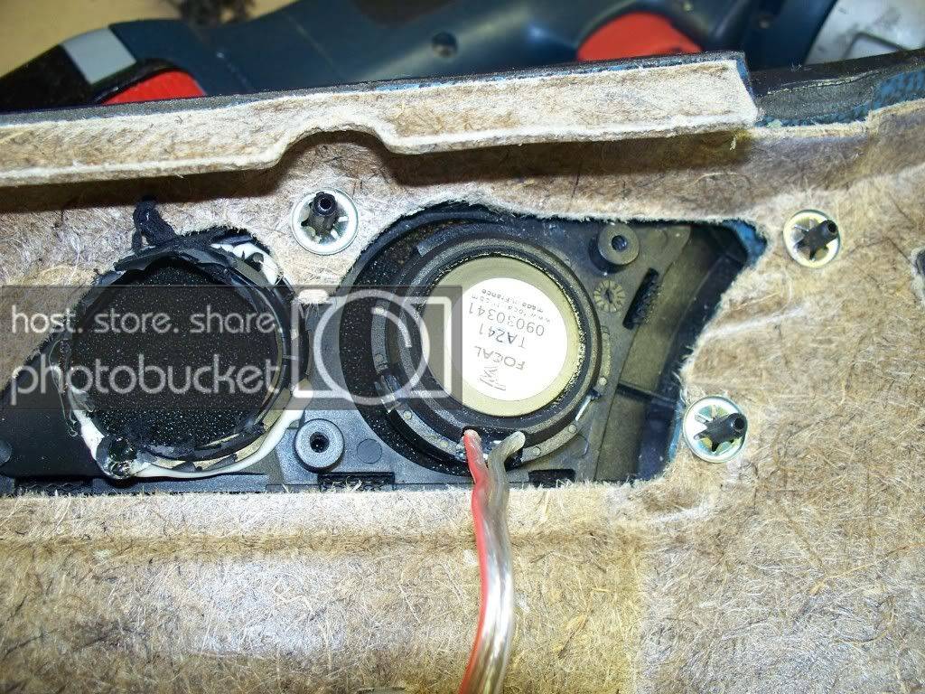

While that was curing I took off the door panel to take a look at the mid and tweeters.
The owner said that the speakers were upgraded but he did not know what they were. All that was upgraded was the tweeter.
Have to make a bracket to hold the smaller mid but will be well worth it.
The new tweeter
